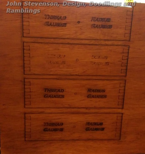

Thinking about doing some nice boxes I must admit I like to see the dovetail joints but other than using CNC and spending more time than I have it's not going to happen. So what about fudging it. The laser can cut as well as engrave where wood is concerned, so what about engraving the lines of the dovetail joints whilst still using a quick half lap joint ?
Three examples [ one didn't come out, weird font ] top and bottom are cut letters at low power, third one down is engraved or scanned.
This is just a bit of crappy ply packing case sprayed afterwards with a rattle can of easing oil to get a uniform finish.
Certainly looks promising and needs a bit more input.

Very nice John, but one major objection: With a true drawer dovetail joint IT DOESN'T SHOW on the face of a drawer, only the sides  :clap:

These are SHOVE TAILS, designed to stop the sides falling off!

Yabut you don't see the sides.
It's only bling

The reason for the dovetails being the other way round is  so you don't pull the draw front off   :palm:

It may be only bling but I don't think it looks right - apart from the objections already mentioned - you'd need to change the grain pattern too.
How about going around the edge to make it look like cock beading on the edges.
