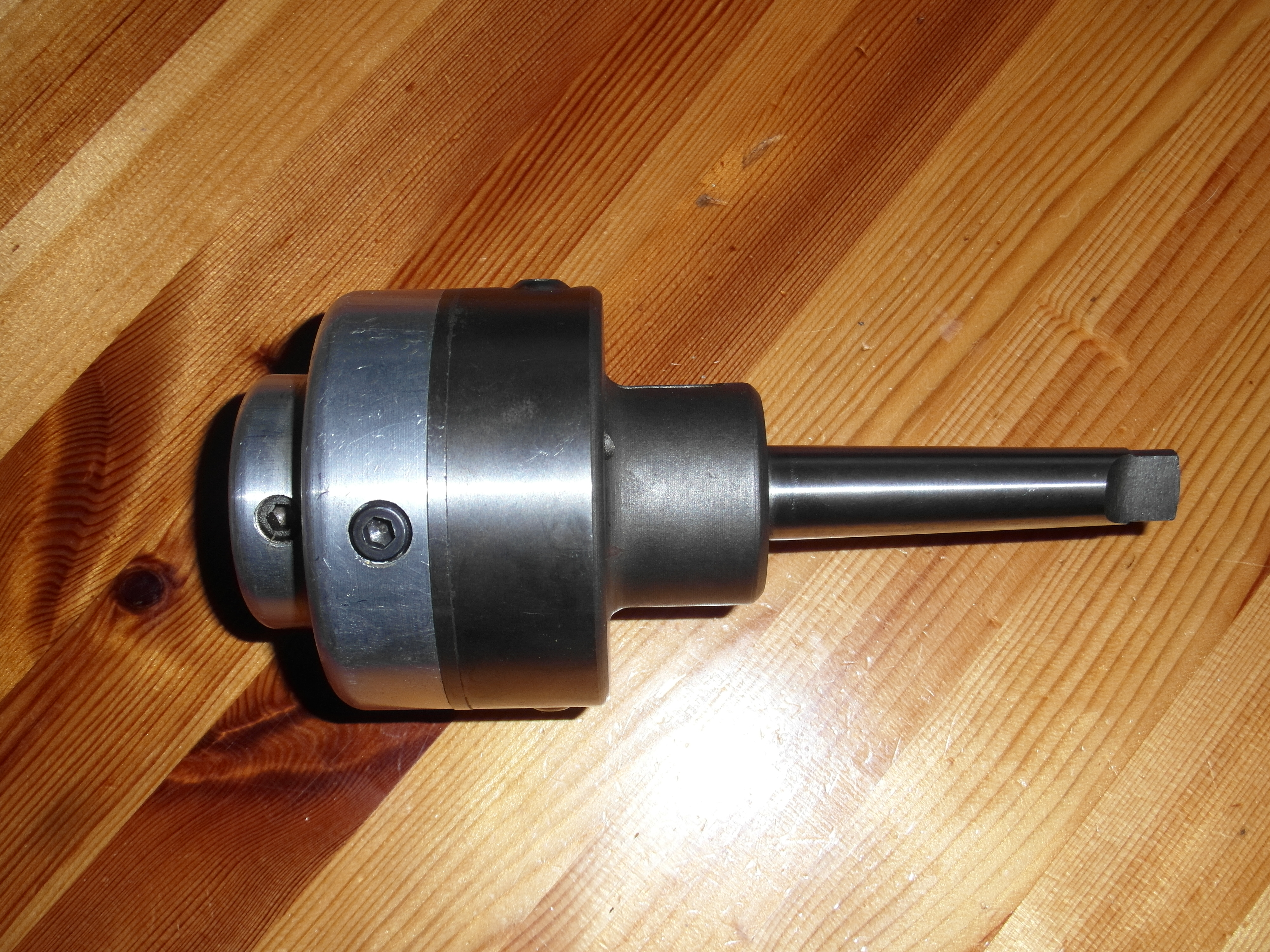

It has a parallel bore and it is possible to change the collet, although I only have the MT2 one, there is no slipping clutch or similar.
http://i1117.photobucket.com/albums/k587/57phil/SAM_1057_zpssscsisfo.jpgClarkson Aximatic
The above should be a more suitable picture via Photobucket

Does it have anything in the bore like a spring loaded ball bearing,can see this being a quick change toolholder like type used on radial drills have a straight shank drill in collet drill hole,leaving spindle running pull the drill out replace with a chamfer tool,chamfer hole pull it out stick tap in and tap the hole-or reamer-or c/bore etc,etc idea is change the tools quick without stopping spindle or moving the posistion of spindle

In answer to the question no there is no quick release mechanism as described, I have a set of those, but this is something different. When I get a minute I will post some different images.  I rather hoped someone would say yea I have one of those it does this! Seemingly not the case.

I don't have one (nor have I ever used one), but from your description it sounds like it would be used to self-centre drill bits in existing holes - or reamers s you suggest. I do have a tapmatic tapping head, that allows the tap to float within reason, thus allowing it to find its own centre, I'm guessing this is the same idea.
