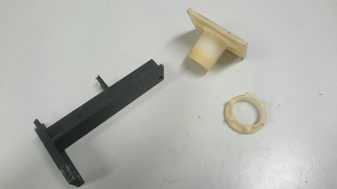

 :doh: Having hit the Post button I, of course, immediately find the other samples I was going to put pics up of!
First one is of two technologies, on the left is a black part made by my aforementioned buddy with the preheated machines. On the right is an SLA part we had made a few years ago. You can see (I hope) that it starts to loose detail on the threads...

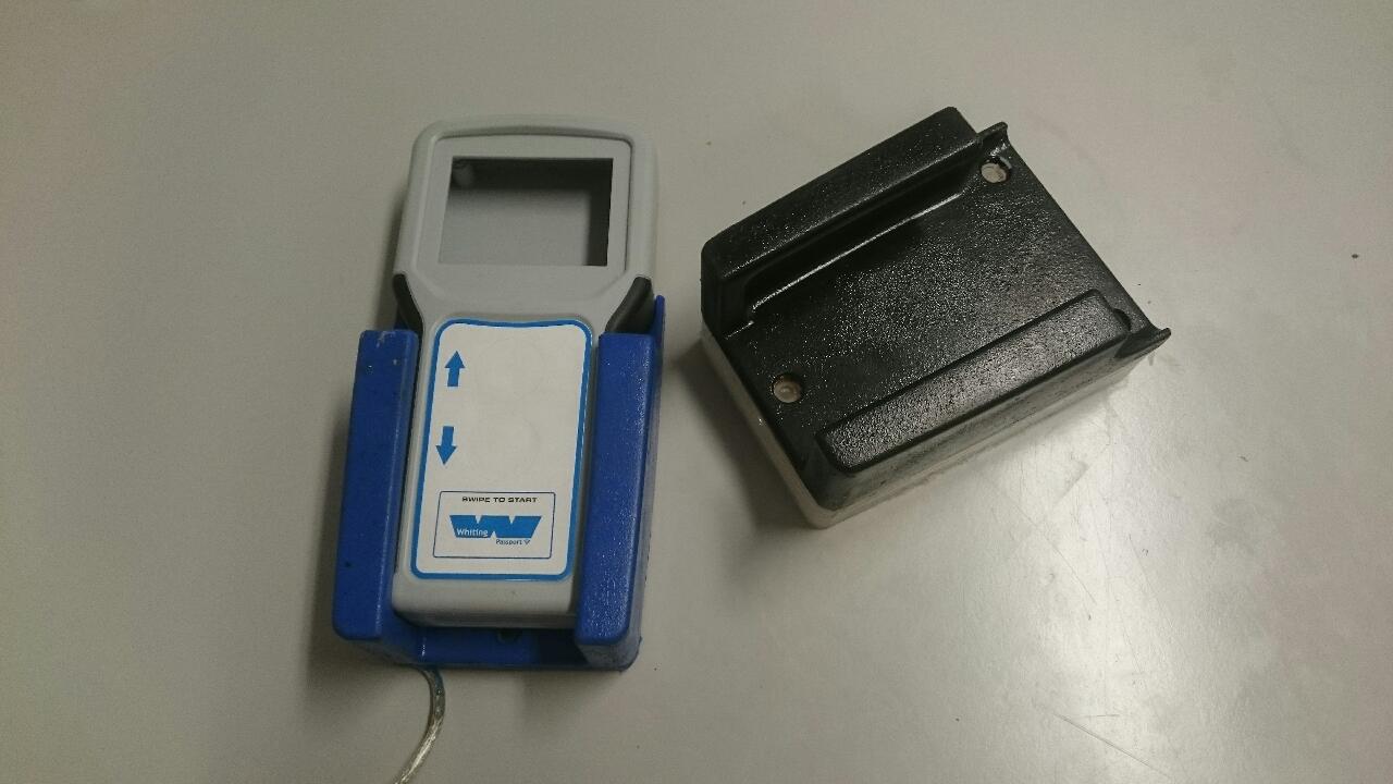

Second is an example of what we have used 3d printing for.. The black bit was 3d printed by ShapeWays, sanded, filled, sanded, filled, sanded, sanded, sanded....... Textured.
We then made an RTV silicone mold and cast the blue part in 95 shore polyurethane. The blue bit has an inductive charger for the device potted inside...
