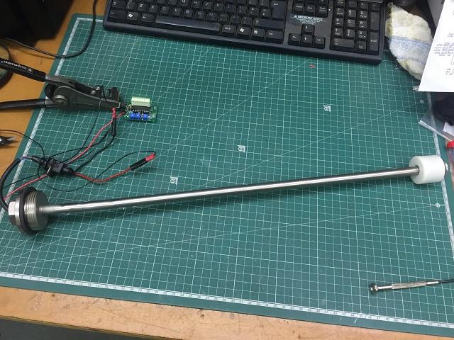

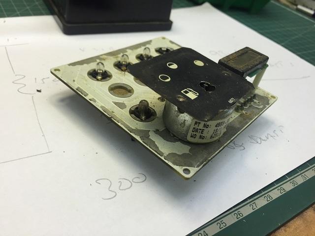

So time for a little more investigation. The wiring diagram shows the gauge is in series with the transducer and the pair are across the 12v supply from the ignition switch - so no surprises there. Pulling it out of the dash and testing it on the bench across the connections purporting to be the only ones going to the indicator it measured 150 ohms - so reasonable. Applying 12v from a current limited power supply moved the needle to full scale - whoohay  :ddb: But absolutely nothing short of poking the needle with a finger would move it back to zero from when the 12v supply would move it back  :scratch: :scratch:
Doing a bit of  :coffee:  :coffee: and  :scratch: :scratch: Google gave me interesting facts about fuel gauges - seems that there are several variants - I'd presumed that they were basically a crude ammeter - but this style has a 'low' coil, and a 'full' coil as well as a third the purpose of which is a bit confusing  :bang:

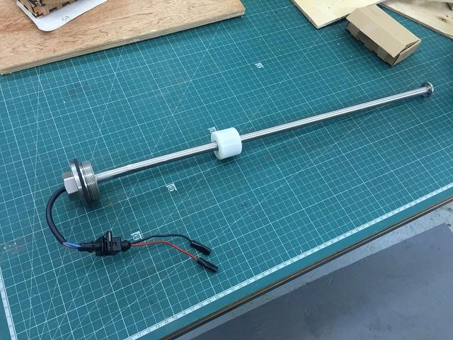

About this time I thought it best to measure the tank transducer - or 'sender' as they seem to be called - basically a variable resistor operated by a float. In this case there is a vertical rod fitted from the base of the tank, surrounded by a float that I assume to be magnetic, that rises and falls with fuel level. All very well, but surely it shouldn't be INFINITE ohms  :bang: :bang: Yes the transducer is open circuit. I strongly suspect that the indicator has failed putting too much current through the 'sender'
So a parts hunt ensued. The 'sender' is available so I ordered one, but the gauge is made from unobtainium, I traced there to be ONE spare in the world, and the dealer somewhere in the US wanted $7K so obviously wants to keep it for ever !

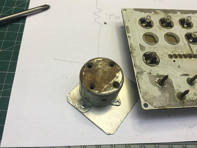

The actual gauge module unplugs as per these pictures

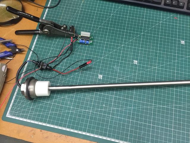

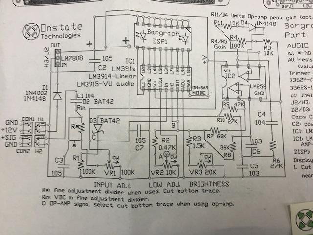

Try as I might I could not track down any vehicle gauge or even normal ammeter, small enough to fit in the available space - so what to do  :scratch:
Well it's not rocket science - we need a bit of electronics that basically shows a reading varying with the variable resistance of the sender - in this case I measured 9 ohms with the tank dry, and 180 ohms with the float all the way up.

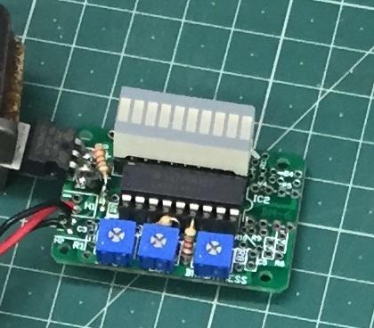

After a few false starts playing with miniature digital volt meters I thought it best to design something myself using the LM3914 Bargraph Driver. This chip accepts a DC voltage, and drives it's ten LED driver outputs in an increasing bargraph representing the voltage coming in. It also has provision for scaling, zero offset, and brightness, all in a single 18 pin chip for about a pound sterling !
So I set off pulling out bits of Veroboard to wire up my simple circuit and then thought - I bet someones done this before - go west young man and GOOGLE  :ddb:
Sure enough, a nice man in Canada had used the self same chip, in his case to make a VU audio meter, and was selling the very nicely made PCBs on a well know auction site for absolute peanuts including postage, so I placed an order

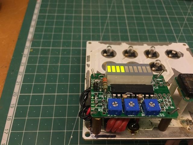

« Reply #152 on: August 26, 2015, 07:29:08 AM »

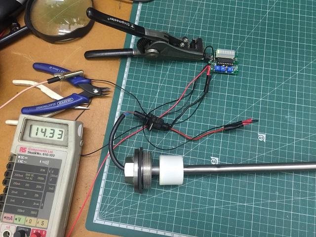

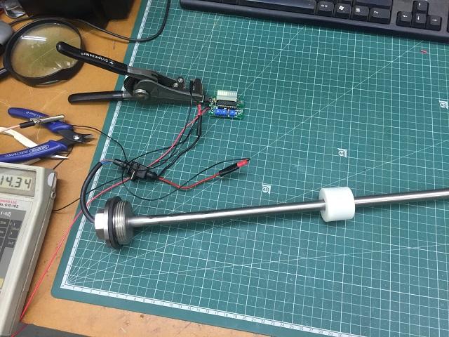

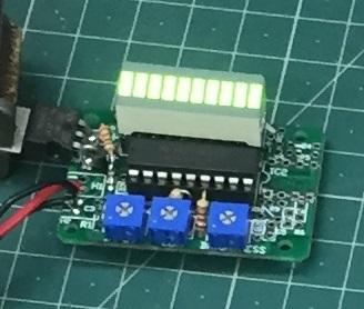

So by leaving out his op amp pre-amplifier, and putting links where he had capacitors for AC coupling I ended up with precisely the circuit that I had intended to glue together on strip board but in a much neater format  :ddb:
Firstly I built it to run directly off the 12v vehicle voltage, but testing showed that as battery voltage varied from 11.5 to 14.5 there was an unacceptable variation in indication. As the PCB allows for insertion of a regulator I tried regulating down to 8 volts and running off that. Excellent results that are stable over the range of voltage that I'd expect in the machine.
Only down side of this is that the regulator dissipates a watt or two and runs hot, and will need a heat sink when mounted. I tried to reduce the dissipation by putting the LM3914 chip into 'single bar mode' so that a single bar 'walks' the indication, but there is an oddity with this integrated circuit that when in this mode, the tenth bar never illuminates  :bang:
At the moment I've set it up so that only 24 mA passes through the 'sender' - a nice low level but it might prove noise sensitive. Easy to alter as it means changing a single resistor and re-tweaking the twiddle pots on the PCB.

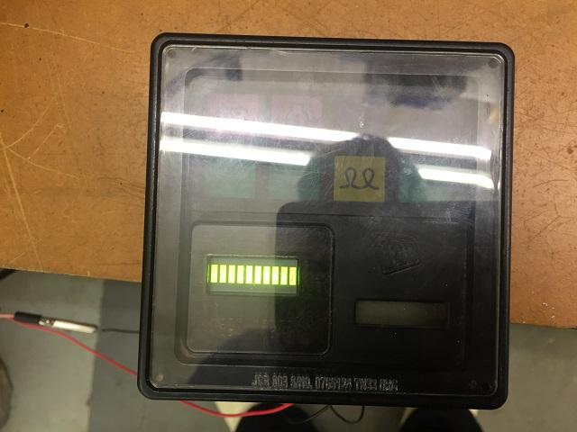

Here is my prototype running on the bench and using my wire strippers as a heat sink  :lol:
(The LEDs are green asnd although bright enough in real life don't show up very well in the pictures)

I have some red bargraph LEDs and might try those.

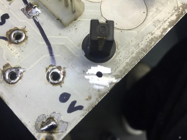

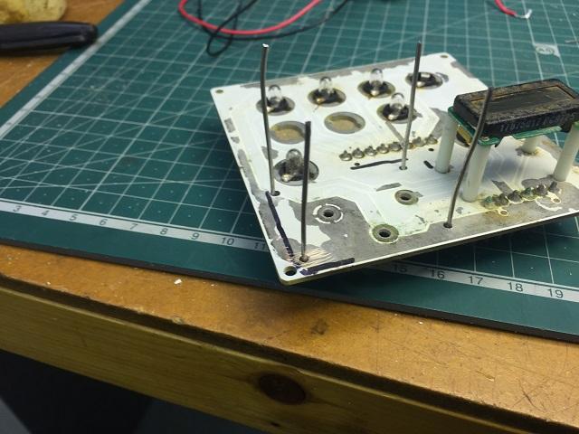

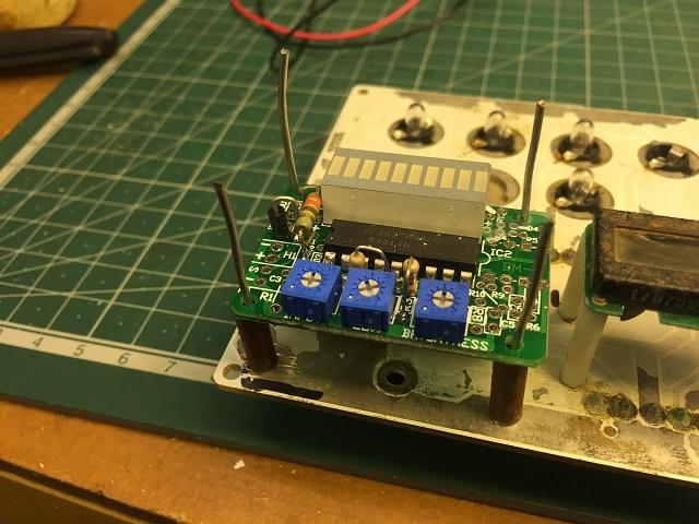

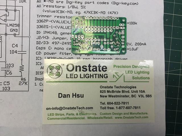

So how to mount it? I decided to copy the way that the hours meter is mounted, using 'posts' of thick wire soldered to the board, with tubular spacers separating the two pcb's.
Drilling holes matching those already in the display pcb placed 3 conveniently within the ground plane on the main pcb, but the fourth emerged right between a 12v trace and ground, so some careful soldering required so as not to short the supply out  :bugeye:
  • Posts: 9124

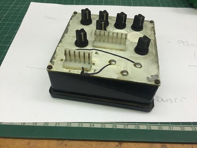

I decided to mount the voltage regulator on flying leads off the board, and bolt it to the largish 0v copper plane on the main pcb as a heat sink - time only will tell if it is enough.
  • Posts: 9124
Re: JCB 803 Saga
« Reply #156 on: August 26, 2015, 12:41:30 PM »

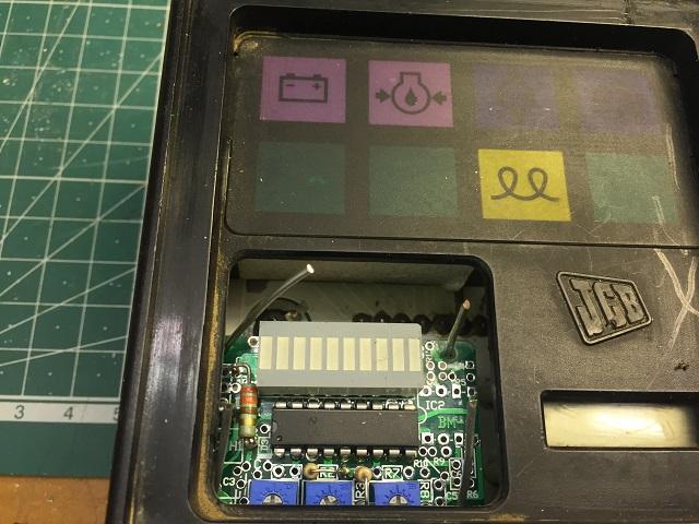

I think I will just snip off the thick mounting wires and bend them over as retaining tabs rather than solder them, so that I can easily disassemble it in the future should the need arise.
I should perhaps point out that this is a different display board from the prototype one in my earlier posts that used ic sockets - I decided to solder in the display and ic as it's likely to get a bit of vibration, and anyway the lower profile was an advantage.
So a quick test to see it works - phew it does - then a tweak with the pots to calibrate 'empty' and 'full', and all that remains is to cut a bezel to surround the LEDs and hide the electronics

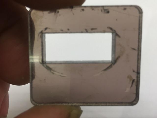

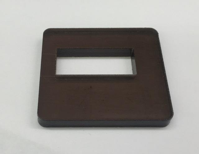

So I cut a bezel - oh I like my Laser Engraver  :lol:
Popped it in the hole, secured by a drop of super-glue and put it all together for a soak test to see how hot it gets.
  • Posts: 9124
Re: JCB 803 Saga
« Reply #158 on: August 26, 2015, 01:52:55 PM »
That's actually the second bezel I cut.
Both were cut from some smoked brown perspex that I have squirrelled away that were water screens on my wire EDM machine that I replaced with clear polycarbonate. The perspex was a bit scruffy, so when it had been cut I cleaned it with IPA (Industrial Pure Alcohol - not the beer  :drool:) and it instantly started forming stress cracks.
Now I've heard of this before but never seen it. The second bezel was cut from the same sheet, in fact with in a few mm of the first one, but this time I cleaned it with soap and water.
Have a picture of the cracks:

« Reply #159 on: August 26, 2015, 02:40:50 PM »
Oh yeah, done it myself  :doh:
One day at work on a IBM 1403 line printer, the print cartridge oiler reservoir was a Perspex block arrangement and it had some crap in it, so Dick-Ed here squirted it with AF spray ....  :bang:
Just like dropping an ice cube into water ..  :lol:
Didn't quite fall apart so I wrapped tape around it and ordered a new one.  :scratch:

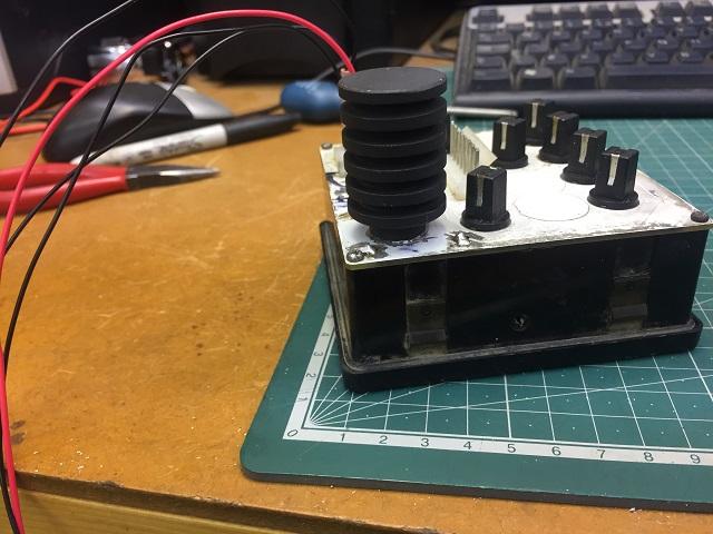

... heat ... heat ... heat  :bang:
This module only consumes 2.2 watts at the worst case of 15v battery voltage (on charge) and all bars illuminated. Yet on my soak test the regulator was getting unacceptably hot (48 degrees C after a couple of hours)
The dissipation is split about 50 / 50 between the regulator ( 15v -> 8v @ 150 mA = 1.05 Watts) and the LEDS & drive chip. I'm not too concerned about these as the dissipation is over a couple of square inches of board, but the regulator needs sorting.
I'd tried using a largish area of the 0v copper pcb, and when that was insufficient bent up a small sheet copper fin that the bolt fixing the regulator retained. This improved things, but all the heat to the heat sink had to pass through the 3 mm bolt so not ideal.
Not much point doing anything inside the case as the heat has to be got away. I hit on the idea of drilling a 10 mm hole in the pcb for the end of a cylindrical external copper heatsink to protrude into the case with the regulator directly bolted to it.
I turned a 1" bar as per the picture below, tapped it's internal end M3, painted it matt black and super glued it to the rear of the main pcb.
So at least now the regulator heat is exported fairly efficiently, and it's back on soak test to see the results
You'd not think that a couple of watts would be so much trouble  :bang:

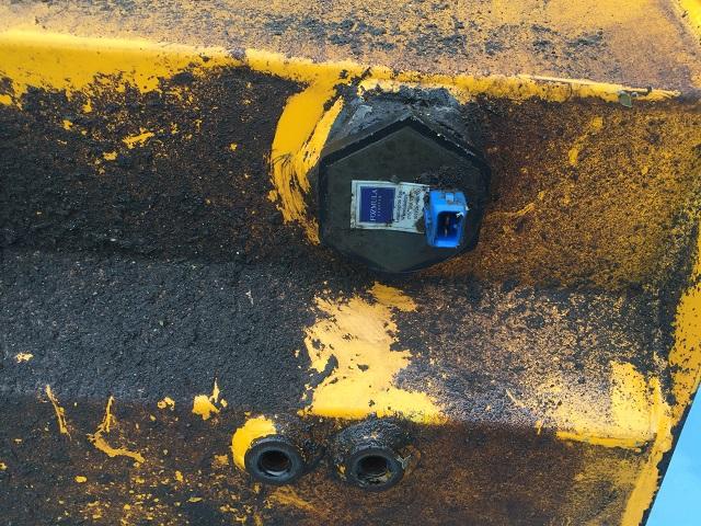

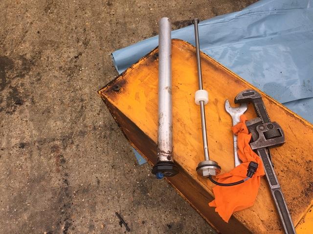

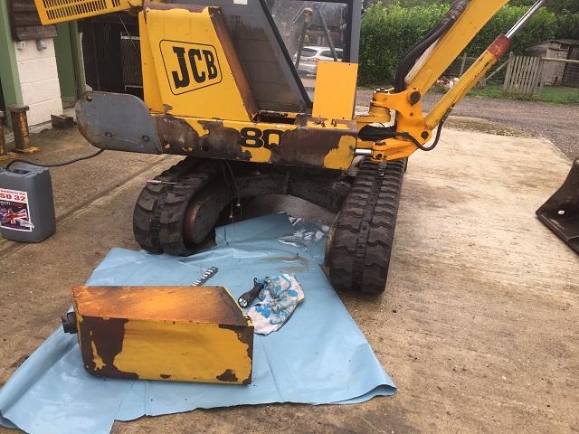

The rain actually stopped after lunch, no longer giving me an excuse not to drain the fuel tank and fit the new sender. Draining the tank was easier than I'd expected as I managed to disconnect the feed to the main filter and extend it into a 25 litre drum. When I got up close and personal with the sender, it turns out that the original has a whacking great 2" AF nut, and although I have spanners that size there's no way I could get past the gubbins such a slew rams and pipes, so the tank had to come out.
Actually not too bad a job. flow and return pipes of course, and four bolts and out she came. Fortunately the thread on the new sender is also 2" bsp, but the sealing methods were not the same. Original tightened up on a flange with a sealing washer, replacement was intended to seat onto a female taper.
No way I'm cutting a 2" taper on the tank boss, so I've put my trust in Loctite 577 pipe seal, which is pretty fantastic stuff for threads over 3/4" bsp. If there's a puddle of diesel under the machine tomorrow morning I'll eat my words  :ddb:
So putting it all back together, I firstly checked that the gauge showed empty, then I slowly syphoned the diesel back into the tank while carefully watching for drips. None so far, and we have 'three bars' on the new fuel gauge.
A quick trundle down to my 'red diesel' bowser, fill her up sir ? - yes please, and lo and behold we have all 'ten bars'.
So at long last we have a working fuel gauge - what a palaver  :bugeye:
