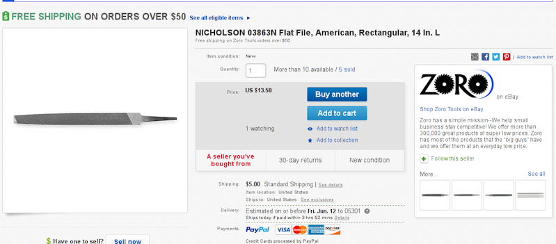

Just as Jonny said. Not as good as they once were. Here's my old(?) -ca. 2001-  Nicholson double cut 14" flat bastard next to one of the new ones. The older one is 5/16" thick, the newer ones, 1/4".
http://i786.photobucket.com/albums/yy150/vtsr/vtsr/Shop/file1.jpgFiles Ordered
Then they narrowed the profile about 1/8" toward the end to save a little more metal.
And they decided not to really double cut the file like the old one, but just lightly score a single cut file and call it a double cut, as you can see here. Who really needs two cuts after all?  :loco:
And by not cutting all the way to the end, they could save a little time, too.  :thumbup:
(I've had call to use the very tip of a file on special occasions, now it's not possible)
http://i786.photobucket.com/albums/yy150/vtsr/vtsr/Shop/file2.jpgFiles Ordered

« Reply #41 on: June 08, 2015, 05:05:51 PM »
Steve, that quasi double cut file needs returning to the seller - it's not good enough - don't accept it.
  • Posts: 6940
Re: Files Ordered
« Reply #42 on: June 08, 2015, 09:54:11 PM »
Thanks Phil that was a great video :thumbup: I enjoyed seeing it. Quite a lot larger hammer than I imagined being used. It makes me want to try making a file by hand some day.
I think the files I bought haven't been reduced in one direction to improve the file. The older file from the same maker shows even cross cuts. I don't know why these newer ones are different.
Andrew, I've already used both files, trying them out before I took photos for here, and noticed the difference in cut. Guess I should have looked closely before with glasses on. They did cut okay, and I can use them. But just not what I thought would be exact replacements for my other one.
I'm thinking of writing to Nicholson, about these, and see what they have to say.  :beer:

Steve it has to be a manufacturing defect, and more to the point an inspection defect, if there was any. Used or not send them back if only for the sake of the next buyer. When we accept poor standards they have a tendency to become the norm.

I've written a letter to Nicholson, who are part of Apex tool group, since they can explain whether this is a manufacturing defect or is due to some other cause/reason. I'm kind of curious now about these files. I'd like to hear what the manufacturer has to say. Could they be seconds? Or even counterfeit? Is it a new production quality? Or a true accidental manufacturing defect? The seller won't know, but the manufacturer will.
  • Posts: 6940
Re: Files Ordered
« Reply #46 on: June 09, 2015, 10:51:33 AM »
A bit more investigation with camera (glasses would have helped earlier)......made in Mexico:
http://i786.photobucket.com/albums/yy150/vtsr/vtsr/Shop/FileLogos.jpgFiles Ordered
  • Posts: 6940
Re: Files Ordered
« Reply #47 on: June 09, 2015, 10:56:36 AM »
And an even closer look, thanks to modern digital cameras and software programs to enlarge details:
http://i786.photobucket.com/albums/yy150/vtsr/vtsr/Shop/Nichulsun.jpgFiles Ordered
Genuine Nichulsuns !   :lol: :lol: :lol: :lol: :lol:
Busted!  :wack:

The files I have are counterfeit. The misspelling is intentional. The U's are shaped to look like O's that have not been fully imprinted. However the ends of the letters are crisply imprinted, not short strikes. So the U was intentional.
A deceptive technicality, as the seller Zoro tools sold them as genuine Nicholson (spelled with O's), and listed the genuine Nicholson part number in its ad.
