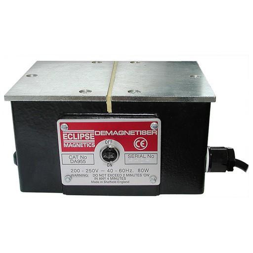

Many tools in my big shop have become magnetized and as far as I know I use very few magnets. I do have one of those little plastic rattle de-magnetizers, but that only works on small tools. Now I'm trying to reduce magnet use in the shop except where absolutely necessary.
It's a real problem preventing swarf and iron dust from sticking to things they shouldn't. Bearing surfaces, tapers, threads, etc.. I'm not sure why I haven't had this problem in the past, but it is definitely present now. Now many store bought items have convenience magnets attached .. maybe that's part of it. This doesn't seem to be a problem for others on the forum, so I can't explain why it's happening in my own shop, but it is an issue for me.
  • Posts: 1224
Re: More lathe gadgets
« Reply #14 on: March 19, 2015, 11:46:11 AM »
It is worth avoiding magnet where unnecessary , if they don't magnetize the machine , they will magnetize the swarf making it hard to clean things.
Use  big coil of copper wire (e.g the demag loop from an old CRT monitor or telly ) and carefully and slowly wave it over the object to be demagnetized , then without switching off move several feet away turn the coil 90 degrees then switch off.
The idea is to magnetize alternatively one way and the other using the AC coil while slowly reducing the magnetic field (by moving away) this should leave the the object randomly magnetized and thus demag'ed
« Reply #15 on: March 19, 2015, 12:23:51 PM »
I use an Eclipse Demagnitiser - basically the 'E' part of an 'E&I' shaped transformer core suitably mounted - it works well. I used to use it for wiping floppy disks as well  :ddb:
