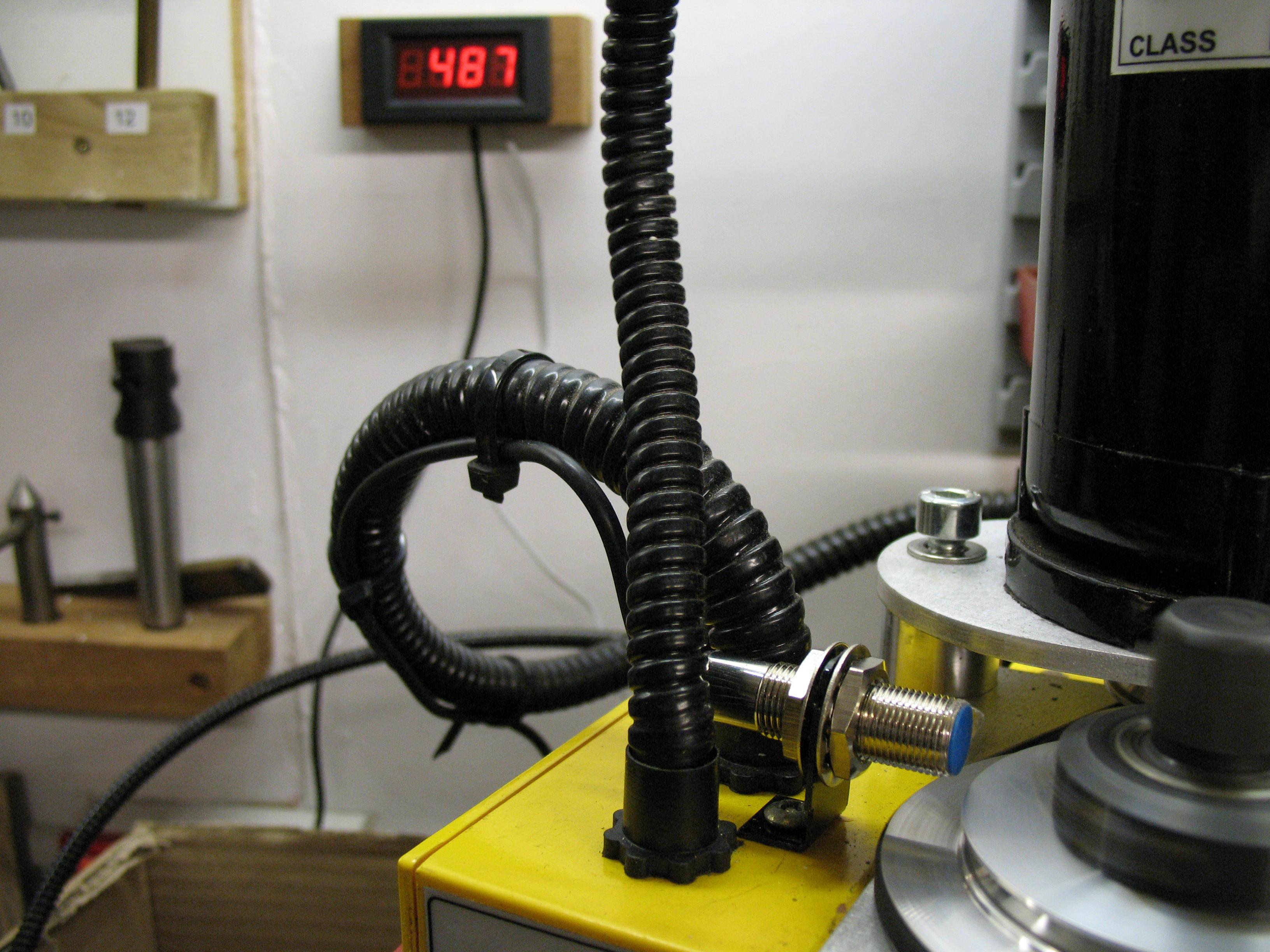

I have just fitted this rev counter on my miller, the on /off switch & speed control are all in one, not ideal. this unit was pointed out to me by Sterlinglad, Thanks! it was purchased on a well known auction site listed as 4 Digital Tachometer RPM Speed Meter Red LED + Proximity Switch Sensor, it only cost £6.99 and was fitted an an hour, it works a treat!!!

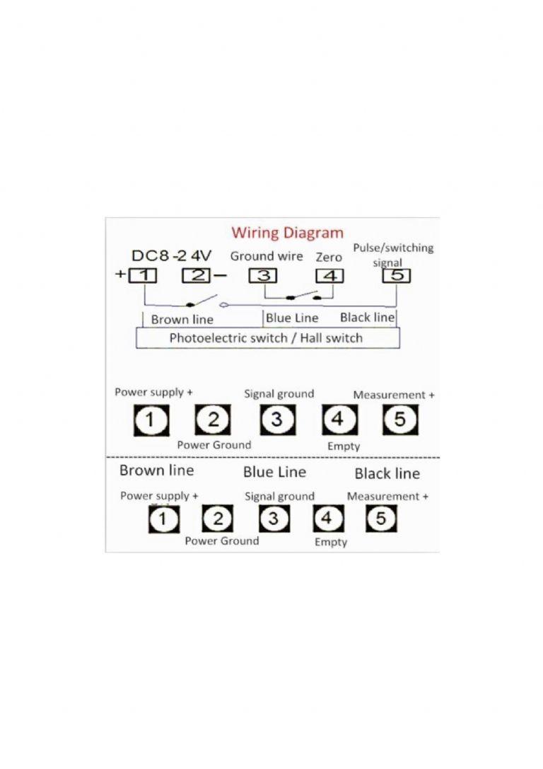

Hi PJW,
I have just bought a similar tacho. There is no wiring instructions in English just some Chinese characters on the 5 pin lug on the display. Have you any info on what connects to what?

Re: Rev counter for miller
« Reply #3 on: December 10, 2015, 04:03:23 AM »
I have two of thees and the wiring instructions were on the ebay post , nothing came with them one came with a magnet and one without .

I fitted one of these to my lathe last year. It worked fine for a few monthe and then one day it wouldn't register. I suspected the pickup and mailed the seller. After much toing and froing they decided to send me a replacement display. Whilst waiting for the replacement, for some reason, I tried turning the magnet over. Lo and behold it worked :doh: It's still working some 14 months later, and I now have a spare display. I bought a new sensor for about £3 and this will eventually find its way onto my bench drill when I compete the three conversion for it.

I got one about 6 months ago for my mill at the price its great it came with a magnet, which was a small disk and no good for my application but I had no problem getting a replacement magnet from Ebay for pence.  :D

  • Posts: 2554
« Reply #14 on: December 31, 2015, 03:05:02 PM »
Will,
What info do you need?
Connection details for the generic chinese type.......
« Reply #15 on: December 31, 2015, 03:29:24 PM »
Gears whare I got mine you will have to copy the wiring diagram http://www.ebay.co.uk/itm/261307045946?_trksid=p2059210.m2749.l2649&ssPageName=STRK%3AMEBIDX%3AIT .
  • Posts: 2554
« Reply #16 on: December 31, 2015, 04:11:21 PM »
Just to clarify if theres any confusion.....
The transducer typically has three wires, Brown,Blue and Black.
The display generally 5 terminals.....
1= 12v positive +
2= 12v negative -
5 = signal in from transducer
So connect your 12v dc to 1&2, observing polarity, connect the Brown and Blue from the transducer to 1&2 respectively, then the Black to terminal 5..
Some sellers provide a tacho that has three wires, Red, Black and Yellow....
Red/Black is the usual 12v supply, Yellow is the signal connection.....
