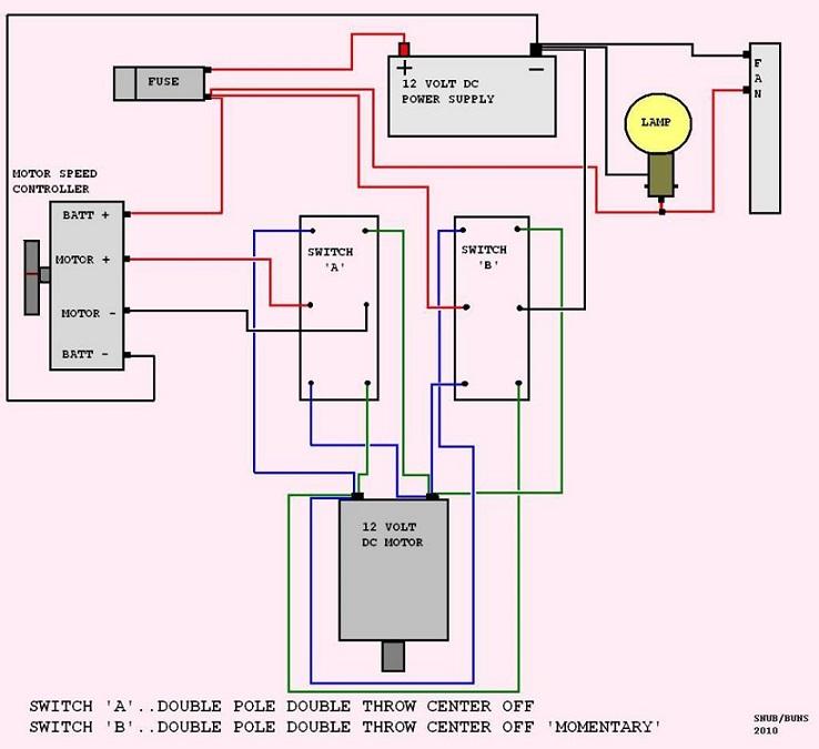

The joysticks only move in a "+" shaped gate. 4 separate SPST switches with center off. Much like the controller for an old video game  like Pacman. You can move your "man" up, down left or right. But you can't move up and right (for example) at the same time.
I chose the "latching" one for slow speed milling (in both directions) so I could stand back and watch the machine work without having to hold the switch on. I chose the momentary switch for fast travel in both directions since the table moves quite quickly.
I chose the 4 way sticks for 2 reasons. First, I may add a motor to the "Y" axis so I could use the same sticks to control that. Second, they were dirt cheap. $16.00 for the pair delivered from China. They were manufactured by Schneider Electric, but are obsolete, so not much info available.

I fully understand this ""Plan C is I will simply use some DPDT switches and add some long handles.
 I just hate buying new stuff when I already have a bunch of parts that need to be used somewhere"".
They are certainly a pleasure to use hence the name "Joystick".

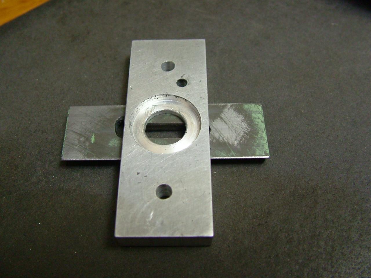

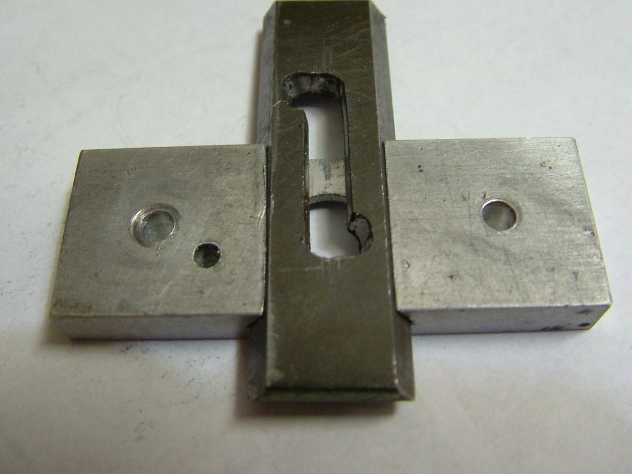

Have Added A sketch of the system I use on a similar controller plus photos of latch to prevent "Instant Reverse"

well iv had another quick go at a possible solution and have come up with the following:
http://i655.photobucket.com/albums/uu280/b-bassett/Mobile%20Uploads/WP_20141214_002_zps45d397c6.jpgNeed Wiring Help For 12 Volt Motor
the latching joystick sets thing in motion at slow speed, and the momentary will bypass the pwm for full speed.
if the momentary joystick is used on its own, nothing will happen.
not quite what you were after but it might do you?
two things to note though, iv common'd up the pwm -ve with the  supply -ve, and in fast mode 12v is supplied to the motor and the + output of the pwm modual. i dont think either of these will be a problem, but without the part in my hand i cant be sure

Bertie, hard to read as drawn, but looks like in the state you show your circuit you have PWM + going to both sides of the motor. Haven't checked anything else.....
snub, sorry about my own mistakes in reading your first post.  I'll try my hand at a drawing one more time and post something (I hope) tonight. I'll try to make it more like your drawing and less like a schematic, if I can.

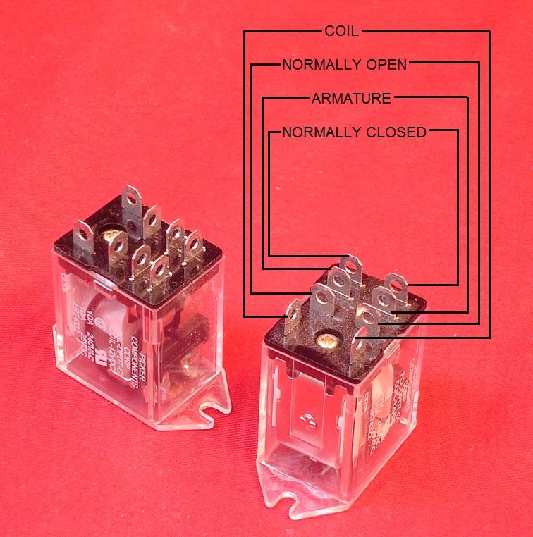

Okay, the explanation:
Your relay should have 8 connection locations on it.
2 for the coil (from your picture, first post, it looks like they are the bottom 2 larger lugs)
6 for the DPDT switch that the coil operates.
That DPDT switch is just like any other normal DPDT switch. It seems like you know how to wire a DPDT switch -- this is no different.
As you probably know, a DPDT switch is basically two switches in the same case that are mechanically connected together, so they close at the same time. And those two switches have a center movable contact that closes with fixed contacts at ether end of the switch. So you have two connected positions for the switch.
Using the DPDT switch analogy, a relay has a spring in it holding the switch closed to one side. When power is applied to the relay's coil it moves the switch to the other side. That is the whole operation of a relay.
The center contacts on the relay's switch are called the "armature", and the switch's end contact is either referred to as "Normally Open" or "Normally Closed", depending on which end it is located at.
When no current is flowing through the coil, our switch is held by the spring to one side, and the contact on that side is the "Normally Closed" contact. The contact on the other side is not connected to anything, and so is the "Normally Open" contact. That's all there is to that.
Your relay should have the connection lugs labeled, and/or a small schematic diagram indicating which contacts are which. If you can include a picture of that it will be easier to draw you a wiring diagram, like the one you showed.

each switch has a center movable part, and two contacts, one normally closed, and one normally open.
  • Posts: 6940
Re: Need Wiring Help For 12 Volt Motor
« Reply #46 on: December 14, 2014, 10:06:54 PM »
Here's a picture  of a relay:
http://i786.photobucket.com/albums/yy150/vtsr/vtsr/Shop/DPDTRelay.jpgNeed Wiring Help For 12 Volt Motor

Here's a simple relay (SPDT), and a DPDT relay.
http://i786.photobucket.com/albums/yy150/vtsr/vtsr/Shop/Relays.pngNeed Wiring Help For 12 Volt Motor
Notice there are 8 connections to a DPDT relay.
2 to the coil
NC, NO, and armature to one switch
and
NC, NO, and armature to the second switch.

Update:
Don't bother clicking on the picture. The diagram is wrong.
