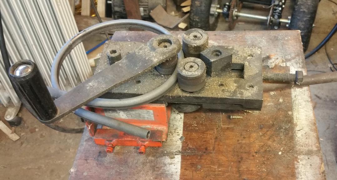

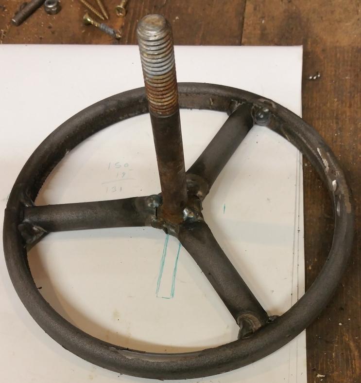

I too managed a little time in the shed today and made a flywheel. I took some tube and started working it in my circle turner before trimming it down to join the two ends (i really should get my oxygen bottle filled so I can braze its been empty for a while now but anyway) then 3 more bits of tube for the spokes and a bolt and i have a rather bigger than wanted flywheel but the circle turner is meant for flat stock so I was happy it did the job at all.
I could not find a bolt the stated size so I hope it wont be classed as cheating if I use a bit of bar the right size to make up the difference?

Great flywheel!!!! :clap:
Shipto, no problem, I think that was a dumb rule idea anyway. I didn't even use one at all (so far). The idea was really just to try to use pipe for most things, where possible. I should have left it at that. I figured the bolt would just give some solid stock to turn down or use for pistons rods,etc. But the number and size of bolts shouldn't make a difference and a bit of rod the same size, seems like we ought to look the other way.......after all you could have threaded an end and called it one!
I'll figure out how to take the bolt thing out, if nobody has any objections.
ps. I don't qualify for winning this thing -- the main idea was to try to get people working on a roughly similar challenge using their own creativity and havng fun!  --- and I am!
