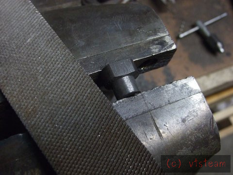

Began filing a cam profile with a coarse file. To give 110 degrees on inlet, I needed the minimum cam thickness to be  0.539" on the 0.713 blank.
I got it to withn 2 thou with the coarse file, and then finished with a fine file. Then I drilled and tapped the boss for a 5-40 set screw.
« Last Edit: July 11, 2017, 05:21:05 PM by vtsteam »

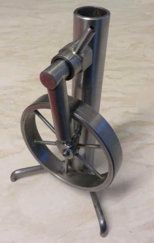

I've done a bit more to my wobbler after showing the video of the parts crudely mounted.  I think it's now more or less finished.
I've made a frame to hold the parts using a bit of pipe and some six inch nails.  A blob of weld holds them together.  The axle for the flywheel is another bit of 6 inch nail with a glazing sprig (a small wedge shaped nail used for retaining glass before putty) through a hole in the end to retain the flywheel.  That goes through the pipe and is welded on the back.
The ports were filed square and filed so that the inlet and exhaust opened and closed together at TDC and BDC.  The square edges also make the ports open more effectively.  That made it run much better.
Another chunk of six inch nail drilled on the lathe was used for the inlet pipe and that was silver soldered in place using my last half inch of silver solder.
A bolt was used to retain the bearing/valve/nut and fastened on the back with a nut.
Here's a picture showing how it looks now.
I can't make up my mind whether or not to paint it.  What does anyone think?

 :thumbup: :clap:
ps, I like yours without paint, Russell. but I'm sure it would look good either way.

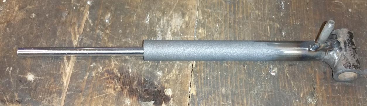

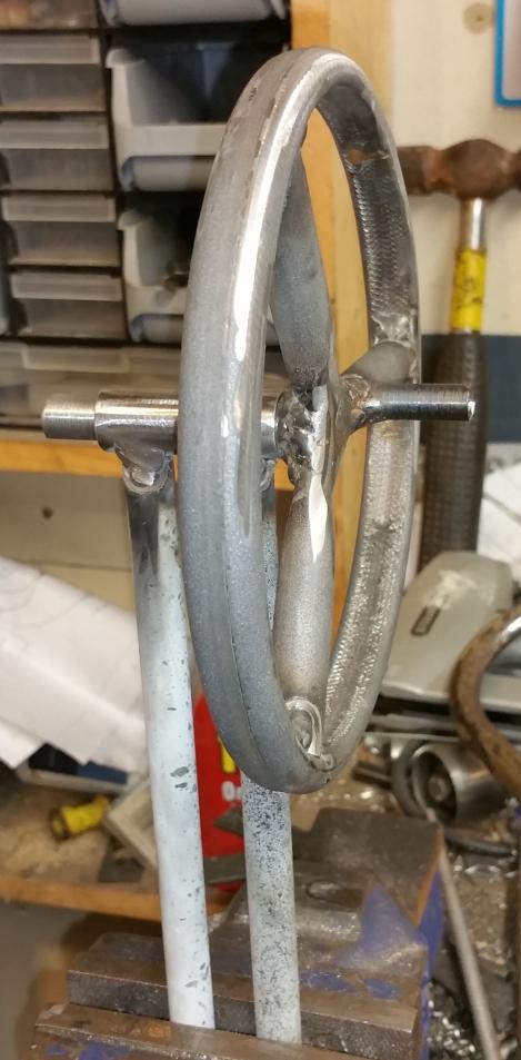

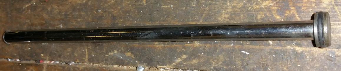

Aaaaaanyway I spent a bit of time today on the fly wheel and piston which I decided to remake as I wasnt happy with the first one.
I started off by thinking about the framework that everything will sit on and made a start on that and then fixed the piston end position, I left it very long as I am not exactly sure how I am going to fix it.
A little bit of the bar...erm I mean homemade bolt that I totally made before cutting it down again to make this  :lol: was turned for the piston end  before pressing it onto a short length of chromed tube and then constructed the outer tube. I am much happier with the new piston.
I am going to have to put some hours in after work if I want to have a hope of finishing this in time  :doh: especially since I dont have a complete plan, so pray for warmer weather.

:ddb:
Got some kinda independant movement out of it just need to work out the valve to run it properly.
