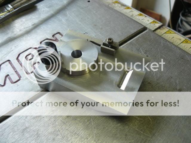

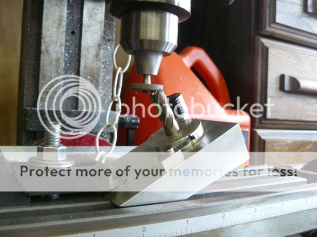

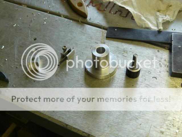

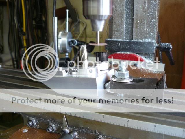

Hi Guys,
Here are a few pics of my latest project, an end mill grinding fixture. I have a bunch of old end mills that are in pretty sad shape. I would really like to put them into service again, so I thought I'd try to sharpen them myself. Years ago, I spent some time in a machine shop and saw a fixture that could be used on a mill to sharpen these things. I found out as much as I could about the cutting angles and such and came up with this. It kind of resembles a commercial fixture, but is smaller, since all my mills are about 2-3 inches in length. Anyway, see what you think. I need to find a better grinding wheel though....Any thoughts?? I tried using a small grinding wheel (actually, a heavy duty cutoff wheel) froma Dremel set, but these things are not very strong and break very easily.
http://i995.photobucket.com/albums/af71/mrfixit2/P1010615.jpgEnd mill grinding fixture
http://i995.photobucket.com/albums/af71/mrfixit2/P1010619.jpgEnd mill grinding fixture
http://i995.photobucket.com/albums/af71/mrfixit2/P1010620.jpgEnd mill grinding fixture
http://i995.photobucket.com/albums/af71/mrfixit2/P1010624.jpgEnd mill grinding fixture
http://i995.photobucket.com/albums/af71/mrfixit2/P1010626.jpgEnd mill grinding fixture

It is not just a matter of grinding across the face, it has to come from the right direction, otherwise you will find that the cutter will either go dull very quickly or in fact chip along the cutting edge.
Really, you require a much heavier wheel, and preferably in an upright position, so you are using the periperal of the wheel rather than the side face.

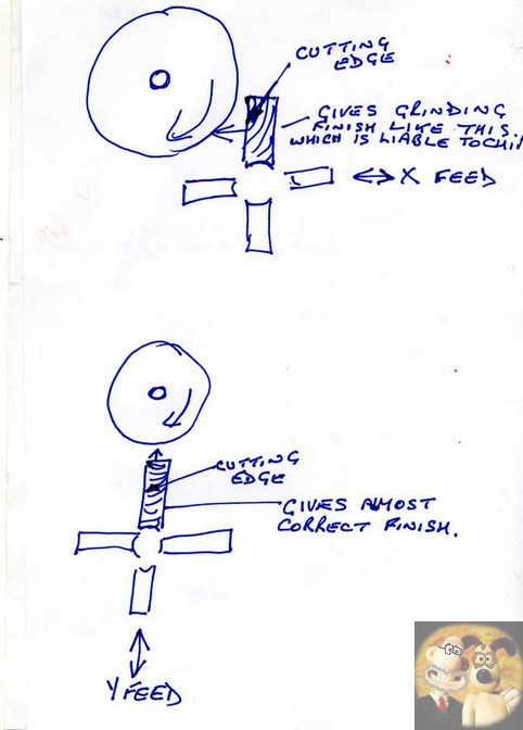

If you want to continue to use the grinder you have been using, you just need to change your method slightly.
The grinding 'grooves' should lay at 90o to the cutting edge, the way you are doing it now, your 'grooves' will in fact lay sort of parallel to the cutting edge.
The way to get them laying correctly, feed the cutting edge in the Y axis rather than the X axis as you are doing now.
Line up the cutting edge in the Y axis in line with the grinder spindle, then just feed in on the Y until you have cut the whole cutting edge, retract, rotate to the next edge and repeat. Do not move in the X axis.
I hope this explains it OK.

Grinder,
Cup-type wheels are most commonly used for this type of sharpening operation.  Diamond coated (Borazon) wheels are used for the greatest precision -- and also cost like crazy ($280 US for a 3-1/2 cup wheel).  The problem is that you spindle is unlikely to reach a really good grinding speed (usually in the 5000-8000 rpm range) which "suggests" (at least it did to me) that an alternate spindle set-up mounted off you mill head would be a valuable project.  Also, be very careful about getting grinding dust into your ways.  You really do not want abrasives getting in there.  I have a set of leather (suede) "drapes" that cover things and I use a vacuum dust collector when doing such grinding.

Hi Grinder
That  a well made bit of kit  :dremel:  :clap: :clap: :clap:   ,it will save you a good few dollars  :med: ,,,,,,,,, thanks for showing  :thumbup:  ,,,,,,,,, another tool to add to the build list  :D
What are the two grinding  angles you decided upon for the base ?
Cheers Rob

Hi Bogs,
Thanks for the encouragement. You must be an old hand at this stuff, seems like everyone has a lot of respect for you, well earned I'm sure. :clap:
Anyway, thanks for the suggestions. The way I was grinding the mill is this: I had the setup pretty much as your sketch indicates, but I was using the X handwheel to move the fixture under the grinding wheel. Any grooves cut into the face of the cutter would then be smoothed out by the varying angle of attack of the grinding wheel as the mill passed under. My biggest problem was the fragile wheels I was using.

« Reply #15 on: September 15, 2010, 08:44:01 PM »
It appears that your mill is an X-2. This addition will allow you to grind the tooling at a much higher speed.

Grinder,
All you really need is a standard cupped wheel on your spindle, and the quill speed as fast as you can get it. For dressing the wheel, just clamp your diamond in the vice and dress in the Y axis.
Use the method I said, feed in the Y axis only, and you should end up with good enough ground cutters.
For sharpening tungsten cutters, use a green grit cup wheel.

Hi Rob and scrounger,
The angles I used are 2 degrees, 5 degrees and 30 degrees. The cutting tip to the center of rotation of the mill is 2 deg, so that only the tip of the cutter is doing any work. The clearance from the cutting edge to the heel is 5 deg. and the back clearance from the rear of the cutting edge is 30 deg. In my next post, I'll try to get some ACAD drawings in to show details. The numbers are from a website http://getmachinetools.com/pro1113095.html I found while researching this project. My selection of mills are short (dimensionally speaking) and mostly 3/8" shank, so I didn't see the need for a support column found in commercial designs. This kept assembly simple. Now that I know it will work with the right grinding wheel, I need to make some more tool holders for my 1/4" mills.
