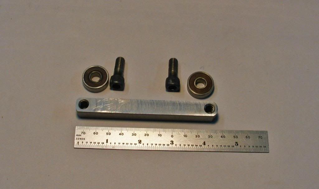

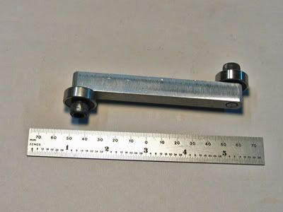

Today I needed to make some new idler wheels for my 1X42" belt sander.  I needed to center stock in my three-jaw that was too short to index off the back of the chuck. Over to my round-to-it file to pull the picture of Frank Ford’s stock centering roller. :D
A 4-1/2" piece of 1/2" square CRS, two SHCS (button head would have looked better) :bang: and two bearings (cannibalized from a printer I disassembled). :dremel:
http://i255.photobucket.com/albums/hh128/Andy_BB/Centering-Tool.jpgCenter Tool
Drill and tap a couple of holes and assemble.

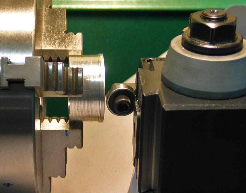

Round-up a spare tool holder. :scratch:
http://i255.photobucket.com/albums/hh128/Andy_BB/Centering-Tool-3.jpgCenter Tool
Tool in position to use. I put this piece of stock in the chuck just to show the use of the tool.

It can also be used on long stock.

That is a nice piece
Ilike that u made it to work in both the right and left side for facing and for bar work.
