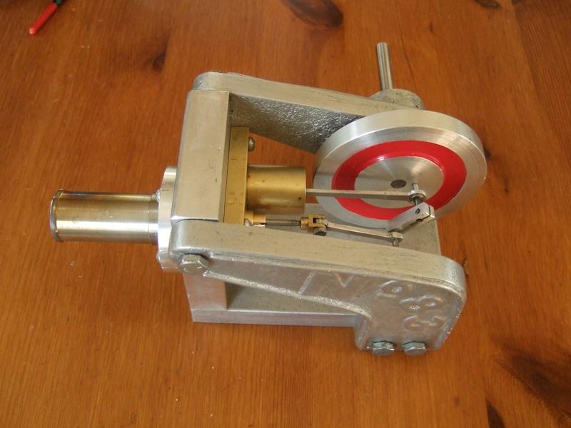

Eighteen years ago for my father's 83rd birthday, I built a hot air engine using my own aluminum castings, skate ball bearings, a graphite piston, and many borrowings from my scrap pile. It was a very rushed 2 week project, since I had little idea of the complexities I was getting myself into. I worked long into the nights. Nevertheless I finished the little engine the night before leaving to see him, and got the bare engine to run, rather impressively, by heating the displacer cylinder over the kitchen stove. I quickly added a channel Iron base, a firebox out of square tube, and a smokestack out of a brass sink drainpipe. The firebox even had a door.
  [ This attachment cannot be displayed inline in 'Print Page' view ]

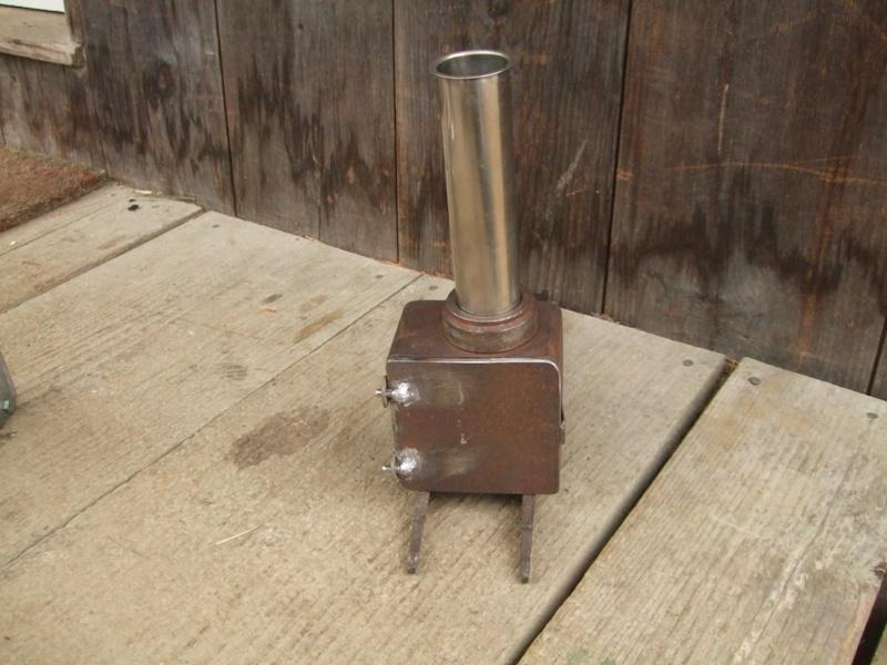

When visiting him a few states away, I brought a small can of Sterno as a heat source, and this fit into the firebox, and luckily was enough to power the engine as well, running steadily. All was well!
Because we had to return home the next day, I took some pictures of the engine on a rather fancy table. The engine was named "No. 83" in honor of my father's birthday. Those photos were all I had of the engine for many years, and I really regretted I didn't have more time to run it, improve it, and try out the many ideas I had as experiments. In fact the original intention was to run it with wood as a fuel, and the firebox and stack were built with that in mind. But that never happened.
Not to go into too many personal details but my father later had a bad fall, was hospitalized and sedated for a week, lapsed into partial dementia, and my brother, an heroin addict and ex-con, took over his life. My father passed away, and my brother took everything, including the little engine. That was the end of it, so I thought.
My nephew, a kind person, recently returned the engine to me after his father, my brother, had also passed. It had been 18 years. My brother had pronounced my engine non-workable after trying and failing to run it once for my father. He had no concept of what a hot air engine really is or how it works. After my father died, my brother had left No. 83 in the corner of a garage on the bare concrete to rust.
The .008" walled displacer cylinder had been overheated and ruptured. The fire door was missing. No. 83 was in sad shape.

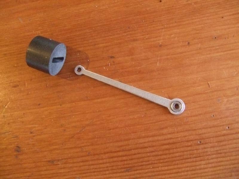

re. No 83: Well as a start, I cleaned the outer engine with mostly just soap and hot water and a 3M Scotchbrite pad. That felt a lot better!

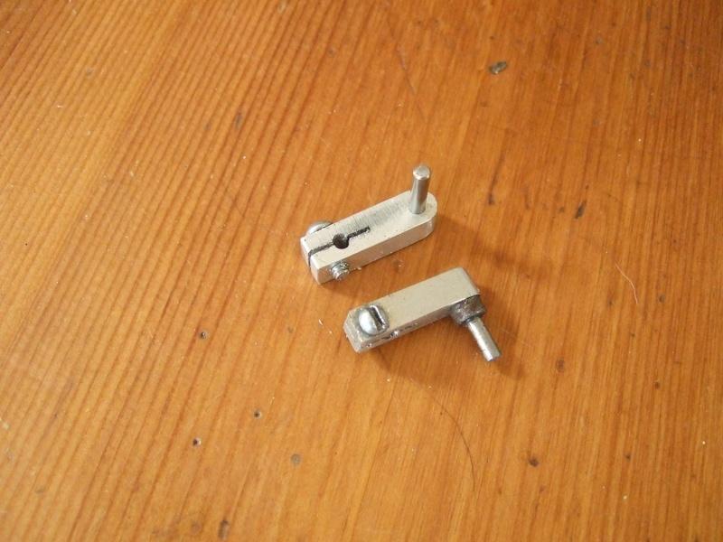

Then I took apart the linkages, cleaned them and put them back together. No telling whether it will run again without replacing some of those parts. But for the moment I think I'll try with what I have.

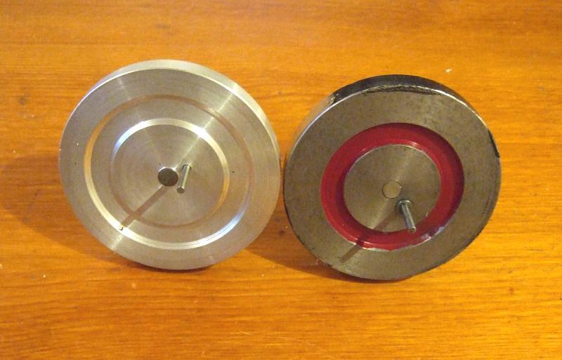

Piston and cylinder apart.
The flywheel spins VERY freely for more than a minute by itself. The displacer slides easily in its bushing. But the graphite piston and cylinder do not.
(Later):
Somebody oiled the piston!  :wack: It's not meant to be oiled. That completely defeats the purpose of a graphite piston!
I was wondering what kind of oil they used. Maybe even kitchen vegetable oil, heaven forbid....  so I smelled the piston. It must have been "3-in-1" oil -- I remember that smell so well from when I was a kid and we were working on our bikes. Well I still have an old bottle of it. So distinctive.
I guess the friction problem was 18 year old oil sludge absorbed into the graphite of the piston. So I just washed the piston with dish detergent in hot water.  And the brass cylinder as well. And now they are VERY free running together. Plus, the compression is back.
I can locate the piston and the little aluminum connecting rod in the cylinder held vertical and they fall right through under their own weight -- which is tiny. But if I put my thumb over the end, the piston stays suspended indefinitely because of compression, until I remove my thumb.
That's a big relief. I thought I might have to make a new piston.

Time to drill the wrist pin journal. I didn't have a way (yet) to do that with the milling spindle. It's not yet possible to mount the milling attachment 90 degrees to the slots in the carriage. To do that I'll have to slot the present milling attachment's mounting holes to fit the table spacing.
But, no problem, we'll do it in the drill press.
I centered a chucked drill bit in a vee-block, then clamped a scrap of aluminum as a fence against the block. As long as the vee-block is tight to the fence, it will present its center to the drill bit. But it can slide along that fence. Then I clamped the graphite blank in the vee block, using a bit of cardboard under the clamp to protect the blank.
I checked the height of the piston slot to the drill table at both sides to ensure it was horizontal. Then I marked the top of the piston where I wanted to drill the journal hole the proper distance back from the end.
Then it was just a matter of sliding the Vee block along the fence until the mark was centered under the drill bit, and the hole was drilled.
Title: Re: The Return of No. 83, a Hot Air Engine
Post by: vtsteam on March 14, 2025, 03:02:11 PM
I returned the blank to the lathe and parted off the new graphite piston. I probably shouldn't have pushed that all the way, and sawed the last little bit off with a hacksaw blade because it broke a chunk off. Luckily that came out of the blank instead of the piston, so it was easily filed off.
Final step was to ream the journal to size and install the con rod.

Post by: vtsteam on March 15, 2025, 09:30:06 PM
Replaced ball bearings and crankshaft, and sealed the leak. I also found when replacing the bearings that the hub of the flywheel was contacting the bearing hub -- there was a high spot where a set screw had been tapped into the flywheel hub. Threading had slightly expanded the steel in the area, which was impossible to see, but I could faintly hear a contact sound when the new bearings and shaft were in place and I spun the flywheel by hand close to my ear. I think that was the sound I heard before when run at full speed, thinking it was bearing noise.
I put some marker on the flywheel hub, spun it some more. Taking it apart again, I was able to see the high spot where it had removed the marker. I filed the raised bit down with a small triangular file, and the noise. was gone.

re. No. 83, I started on a fourth displacer cylinder today.
It features a thinner steel flange, compared to the last version's thick aluminum, and a reversion to a stainless steel end cap instead of a copper one. I wanted to try go back to the performance of my second cylinder, if possible, by removing some of the added variables.
So far, I've made 4 displacer cylinders, lined up here to show the differences. The first was just stainless steel tubing. Top RPM was around 800. The second had a thinned down wall thickness, and average speed was around 1400 RPM it did hit 1600 rpm on one run. The third cylinder had a changed mounting method. Instead of passing through the aluminum heat sink, it had a flange and mounted outside of it. It ran about 1300 RPM. An improvement in bearings and a sealed leak and removal of a frictional interference produced a max speed of 1440 RPM.
The 4th is a reversion to the second cylinder but with a flange mount.

Post by: vtsteam on April 08, 2025, 07:11:39 PM
Okay engineers, back on engines! Not a big part, but progress none-the--less. A new connecting rod, this time with a ball bearing pressed into the big end.
If you could call it big. It's a 3mm bearing. I will have to re-pin the flywheel, since the former bearing was 1/8". I don't have any 3mm rod, so I'll have to turn down some 1/8". Well maybe grind it down with the lathe's milling attachment.

Post by: vtsteam on April 09, 2025, 08:10:14 PM
I actually didn't want to re-pin the flywheel, because I'd like to be able to revert the engine to its original running condition. Also it's good to be able to go back when comparing tests while experimenting. So I took the opportunity to make a new aluminum flywheel. Something I'd already planned as an experiment.
The old flywheel was steel, and possibly heavier than needed. I did like the way it looked, though, so rather then making a smaller flywheel, I switched materials to aluminum. That should reduce the weight by two thirds, yet still look the part. I hope this new wheel will have enough inertia.
Guess we'll find out!  :ddb:

Post by: vtsteam on April 10, 2025, 03:53:02 PM
And as a result of changing from 1/8" to 3mm on the flywheel, the old crankshaft link for the displacer no longer clamped properly to the flywheel crankpin. So I had to make another.
And that one also turned out to be a problem because the displacer just "ticked" the end of its cylinder. If I tried to adjust, it would tick at either the hot end, or the cold end. But never missing both. So that means the throw (and pin spacing) is just a tiny bit to large. I'll have to make another.  :wack:
Heading out to the shop again right now. I want to have the engine running this evening.  :loco:
Two down, one more to go:

Post by: vtsteam on April 10, 2025, 07:22:03 PM
Done! Third time's the charm. Everything fits and no stroke interference. I gave it a brief run-up tonight and it hit 1296 RPM at 100 watts using the electric heater. For this I was running with the thicker flange displacer cylinder.
The engine is much quieter and smoother. It starts running with the new lighter flywheel after 4 minutes of warmup (the electric heater at 100 watts is somewhat slower than Sterno was, I believe) and starts at about 700 rpm, gradually increasing as the furnace heats up.
There seem to be stages of steady rpm, then increases to higher levels, where again it stays relatively consistent for a time before increasing. Maybe its some set of resonance levels. There's a fair amount of vibration (for a small engine) and I notice that if I place my hand on it to steady, I can sometimes get an increase in RPM.
I think balancing the crankshaft might help top speed, but not sure how to do that with an inline twin with a 90 degree phase difference.
Anyway, here it is with new flywheel, new power piston conrod (ball bearing big end), and new crank arm:
