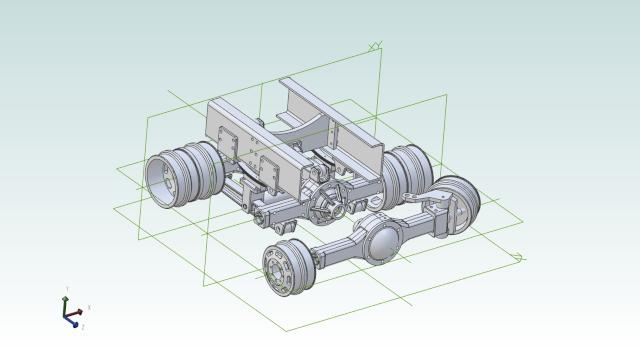

For the last couple of days I've been playing with assemblies in Alibre.  So far I'm batting 1000, I've managed to break every one of them that I've tried - but I'm learning from my mistakes.  That doesn't mean I'm making less mistakes, it just means that when they happen now they are WAY more impressive.  This is my latest test assembly, I'm still trying to figure out how to save the current view.
(https://lh3.googleusercontent.com/pw/AP1GczOw2CPvJw-TCyc80uh3OZQOwX1lrzbEB1twQFlSIkAwd7nW1KDgWWlp0MOeWHQ_1KtarX8Uu24C-SA4znwrc_A4oFUIpc658R7SxFE46mZRrq3HEe6BwD7f1pIYeMMDLhPeKPPCR4n83m2Btphsy5ig=w640-h333-s-no?authuser=0)
I hope I didn't screw up the previous posts, when I previewed my post I noticed that I hadn't scaled the image for posting.  Somehow instead of deleting just the unscaled image, I managed to delete the entire Frankendiff album.  I put it back, reloaded the photos, and shared it again - hopefully all is well.  Where's the EASY button when you really need it?
Now all I've got to do is figure out how to get my spring hangers, springs, and equalizer beam center pivot to fit into a 32x65x10mm volume.

Post by: ddmckee54 on November 05, 2024, 11:18:39 PM
OK, as promised we'll open up the picture page.  (Who besides me still remembers the jingle for Picture Pages?)
(https://lh3.googleusercontent.com/pw/AP1GczPeY2W47tC0e4ie9x0to_FhHB9N1mqUY0HssRXtB57AffOi7rFdQLxVcfdaAw4EGFMiQY1nHYxJGZJoER4YPTY3toawr1y1eWKUkshkF5pQNHloJAPVdkxLB7xx_laW__lg2ZoSMHTHSo2b2CkeXYEv=w640-h355-s-no?authuser=0)
What you're looking at is the view from the passenger side, standing in front of the center axle looking to the rear.
I've temporarily hidden the passenger side frame rail, and just about every part of the suspension is in place now.  I don't know how many leaves I will need for support, that's why there's a gap between the springs and the equalizer beam pivot bracket.  I've got the springs drawn as three 0.5mm thick leaves, that may, or may not be overkill.  I'll adjust the amount of leaves to suit the load, for now I'll probably just make a spacer block.
I'm still waiting for the donor axle order, according to the tracking it should be here within the next week.  I sounds like the O-rings, the brass tubing, my 8" caliper, and the other odds and ends that I ordered should all get here about the same time.

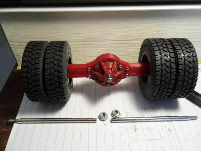

I cut the existing axles with a hacksaw and took 0.3mm off the backside of the diff gears on the axles.  I haven't spliced the axles back together yet, but I reassembled the differential to see if I have gained enough clearance.  The differential now works correctly when the differential cover screws are completely tight, but it works better in one direction than the other.  It turns in both directions, but in one direction it is definitely harder to turn.  I also noticed that there is no noticeable end-play in the axle shafts.  There is no grease in the gears right now and it is entirely possible that with proper lubrication and a little run-in time this clear up
I'm using the Kong axle that I purchased as my benchmark so I checked to see if it had any end-play in the axles - it does.  So maybe I still need to take an extra 0.1mm off the back of the gears on the axles.
Title: Re: 1/16 Scale RC Truck parts
Post by: ddmckee54 on February 02, 2025, 07:45:32 PM
WELLLLL... things did NOT go exactly to plan, the best laid plans of mice and men  - and all that crap.  My very first plan was to remove the gear from the end of the axle shaft, shorten that end, cut new flats on the axle to match the gear, and cut new threads to match the screw that holds, the gear on.  The only problem with that plan was that I could not get the screw to break free, I even tried heating the screw to try get whatever thread locker they had used to break free.  The only thing I managed to do was to round out the hex socket in the screw.  The next plan WAS that I would cut the steel axles in two, turn a stub about 10mm long on the cut ends to a 3mm OD, cut a piece of 5mm OD x 3mm ID brass tube to use as a splice, then Loctite everything back together.  Easee-Peezee, right?
Things did not go well from the beginning, then went downhill rapidly after that.
Problem 1 - How do I hold these little turds to cut them?  My first thought was to use my metric ER16 collets.  Something like this IS after-all why I bought them, and the collet chucks for the Unimat and the Sherline.  So I blissfully cut the axles apart with a hacksaw, figuring that I could easily clean up the ragged ends with the lathe.  Heck I could even chamfer the ends, 'cause chamfers are what separate us from the savages - right?
Problem 2 - I knew that the collet chuck for my Unimat registered on the shoulder on the spindle nose, I ASSUMED that the collet chuck for the Sherline did something similar.  Imagine my surprise when I opened the box to find that the collet chuck for the Sherline registered in the spindle taper, AND uses a 1/4" bolt as a drawbar to hold it in the spindle.  OK, that means that if I need to work on a longer part I'll need to work on the end hanging out in the breeze, and not work next to the chuck where there's less flex.  That procedure actually worked fine on the ends that were threaded for the wheel attachment.
Problem 3 - The other two pieces of the original axles still have the gears FIRMLY attached to them, and I need to work on the OTHER end.  NO Problemo, I'll just slide the gear into the spindle bore, the bore on the Sherline is HUGE compared to the Unimat.  AAWWW CRAP, there's already a drawbar there.  The gear fits inside the collet chuck, maybe there will be enough room to put the part in from the back - THEN tighten the collet down?  Nope, there may be a mm or two of clearance there, but there's just not ENOUGH extra mm's.  OK, lets swap out to the 3 jaw.  Then the gear can just slide into the spindle bore.
Problem 4 - I got out the 3 jaw, cleaned everything up, and installed it.  It has been sitting in a box for years - remember?  I opened up the jaws, slid that part in, and...  IT DON'T FIT!!!!  WHADDAYAMEAN, it don't fit?  That bore is huge, it's 10mm, and the gear is only... 10.6mm.   OH Crap!
Problem 5 - I can't work on the area of the shaft I want to - at least not where I want to work on it.  But, I've got a lot of the brass tubing, I can make the splice as long as I want.  I can pull the part out until it bottoms out on the back of the 3 jaw, I want to eliminate that cross drilled hole if possible.  Pulling the part to the  back of the 3 jaw puts the existing cross drilled hole inside the sleeve, but not by much.  But, it IS inside the sleeve, so MAYBE it'll be OK?
Problem 6 - I needed to turn a 3mm OD stub on the cut end of the axle - Easee-Peezee.  I figured I'd take off 1.1mm then sneak up on it - no problem.  So, I made several passes taking a few tenths of a mm at a time and didn't stop to measure until I hit 1.1mm of movement.  WTF, whaddayamean 2.82mm OD??  I only took off 1.1mm.  But I took it off of each side now didn't I.  I was much more careful on the second axle.  That gap is way more gap than any of the Loctite that I have is good for, but I can always use JB Weld.  So that's what I did, This is what the axles looked like at this point.
(https://lh3.googleusercontent.com/pw/AP1GczM81rr2XthYmVrALsWeGlw-fmWm8rWRvl-txjEiODAkxuGEkYL53opbqNeVpQQJN_Vkgi-ihPkE3_gRlHXUj4sDXb98i_LMddx85UmVMh-6AgHJgKwFjJl2w9C6YROrVTVfLlrIWYDEy1HMb5Wnhggc=w640-h480-s-no?authuser=0)
Problem 7 - I needed to shorten the brass sleeve to length.  Since the gear's OD is larger than the spindle bore I had a LOT of stick-out, about 25-30mm's worth.  It did not end well.(https://lh3.googleusercontent.com/pw/AP1GczPMkjRyYhle7g74zp2UhPqRM_z4xKsTpEkpjS32xhiJHydrb9JPeGNJm_XDtQQ0SbEjj8XnkcXVtQb_9hqJ3oIbqbkR7GEwlYG4jRKequp_XoOFkVenIwAY8AgQBP2QooeI3vwBitfoLnQ0qjeWObta=w640-h480-s-no?authuser=0)
It snapped off right at the cross-drilled hole location.  I think the axle would have been strong enough for the loads it will see, if only I would have just put the splice in a spot that's not close to an existing cross-drilled hole.  I also found out that I need to make any axle shaft modifications starting on the outboard end, rather than the inboard end like I did this time.
The good news is that because I ordered complete extra axles, instead of just the extra pinion that I needed to make a center drive axle, I've already got spare axle shafts to work with.  The extra bearings are the same size as what I would need for the front wheels if I decide to make a powered front axle.

A little more progress has been made.  I was able to find the broken stub that was shown in Post #18.  I thought that I had pitched it, turns out I'd just misplaced it.  I found it when I went to use the toaster oven to remove the gears from the next donor axle.  I have enough bits and pieces that I now have the fixin's for 2 complete differentials, if I can get that M2 screw with the rounded out hex removed.  While the toaster oven was hot I also took apart the axle shown in Post #20 that was 4mm too long.  At some point over the last several years I had purchased the smallest Easy-Out I've ever seen.  I was able to get enough purchase with it that I could back the screw out enough to grab on to it with a pair of pliers and remove it.
Today I modified the stub axles that I already had cut apart.  The axle shaft from Post #20 was 74.27mm over-all in length, so I'm aiming for a 70.25mm length in my completed axles.  I modified the first axle, Loctited it together, and left it clamped in the Vee-block while I modified the other axle.
One measures 70.14mm, and the other is 70.38mm.  Not bad for a beginner, but I plan on doing better next time.  And, the only thing that I had to scrap was that bent length of brass tubing shown in Post #18.

  [ This attachment cannot be displayed inline in 'Print Page' view ]
I know it's missing a lot of stuff, a couple of wheels, ALL the tires, drive shafts, fasteners, tie rod, not to mention the great gaping hole on the passenger's side where the pivots, steering knuckle, and CV joint should be.  Cut me some slack, this is a Proof-of-Concept model, not a for-realsies highly detailed 3D model.

Post by: ddmckee54 on April 26, 2025, 01:48:45 AM
I found that Lesu makes a driveshaft with a 40-45mm range.  I initially had 37mm between the center axle and the rear axle.  If I add 5mm to my center/rear axle spacing that will put me in the middle of the Lesu driveshaft's range.  I did some checking, and the only 3D printed part that I really need to modify to do this is the equalizer beam.
Eventually I will have to determine the hole sizes/locations for the frame rails, but that's a problem for future me.
