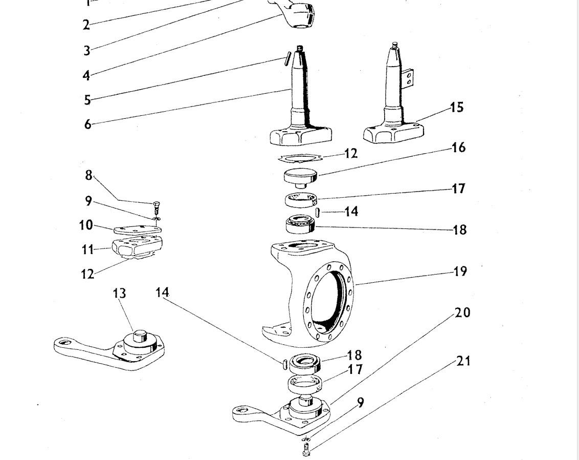

Post by: awemawson on February 05, 2022, 08:17:48 AM
Today's task: replace the track bar pins, bushes and seals:
Firstly I turned up a tool to drive the old bushes out and the new ones in. Just a length of round bar large diameter 29.90 mm and smaller diameter 24.90 to be a nice clearance fit for the 30 x 25 mm bushes.
That done I raised the front axle on the bucket and applied myself to extracting the off side tie rod pin but very quickly got stuck with the inevitable 'gotcha's ' ! . The pin was amazingly tight - OK not unexpected - and eventually using an air chisel with a snub nose tool was able to get it moving upwards only to find that this pin retaining tab fouls on the eye of the steering ram, so the pin for the steering ram needs to come off first  :bang:
Now that wasn't too bad I I have the new bush for the steering ram to fit . . .BUT . . this pin is into a blind hole so no knocking it out from below and it's just as tightly in the non rotating bit as was the other pin.  . . . an impasse. I then discovered that by removing the mud guard, putting the steering hard over to the right and removing the steering ram grease nipple the tie rod pin retaining flag would just pass it if suitably rotated.
OK we're back in business - the old bush knocked out fairly easily and the new one went in fine. I took the precaution of injecting grease through the nipple to ensure that the passageway lined up. However the seals were most unhappy to be driven into their counter bore and I ended up spoiling two in the attempt.This means that I can only do this end of the tie rod today until more seals arrive.
At least this will give me time to work out how to remove the steering ram pin. My thoughts at the moment revolve round drilling and tapping it and using a slide hammer. It's a compromise between using a large thread size that will have the strength but weaken the pin in the event that I can't get it out or using a smaller thread that leaves plenty of material in the pin but may not be strong enough for the job !

Post by: awemawson on February 06, 2022, 06:15:38 AM
Last night I made an adaptor for my slide hammer to give it a 10 mm nose, and this morning drilled and tapped the blind pin that is very reluctant to come out.
Much sliding and much hammering and quite a bit of applied heat from a blow torch and . . . . .. the pin hasn't moved one jot  :bang:
. . . hey . . .there's not THAT much play on this pin, leave it . . . Get thee behind me Satan  :bugeye:
So at the moment another impasse. It's slathered in 'Plus Gas' penetrating oil more in hope than expectation whilst I have another re-think - I may make a longer slide hammer that would allow better whacking and I could perhaps give it a heavier hammer but I'm afraid of stripping the thread.

Continuing chasing minor oil leaks I recently attacked the oil seals for the offside front drive shaft. There is a seal in the end of the front axle casing, and another where the shaft goes into the steering knuckle, with a dual UJ unit between them.
To get at the seals the shaft has to be removed, involving removing the  final drive sun / planet gear box, and releasing the steering knuckle from it's top and bottom taper roller bearings. These bearings are mounted on pegs on a pair of trunions (upper & lower). Although in theory it is simply a case of unbolting the four retaining bolts from each plate and pulling them off invariably they are stuck fast and apparently the lower one can be a right b....r to get off. Well mine was no exception though the upper one wasn't too bad.
Seeking help on the Facebook JCB group I was given all sorts of suggestions, but what worked for me was removing the upper trunion, inserting suitable packing where the peg seats, and bolting it back up. As I tightened the four bolts it pushed the lower trunion just enough to open a gap into which I could use a cold chisel as a wedge to remove it completely.
There are two varieties of steering knuckles - an early one that needs the taper roller bearing pre-load setting by shims, and a later version where 1 mm of preload is pre-set in the machining of the part. Fortunately mine is the later version, as wedging with cold chisels would inevitably ruin any shims.
Once dismantled it was a case of lifting the inordinately heavy knuckle off with my nice Epco engine hoist, pulling out the drive shaft, polishing its oil seal bearing surfaces with 400 grit emery cloth, replacing the seals and putting it all back together.
A simple little job this one that took a full day last Saturday from 07:30 to 18:30 working straight through and no stopping for lunch !
Still - no weeping seals now  :thumbup:

Post by: pycoed on August 29, 2022, 04:16:26 AM
Very interesting... I have a front driveshaft U/J (same double U/J configuration) gone on my Zetor 7045, along with knackered bottom & probably top knuckle bearings. Can't steer to the left, reliably! Eventually (after replacing multiple worn steering joints around the power assisted steering, I diagnosed that the knuckle bearing(s) had failed allowing the rollers to pile up in one direction. Not having any flat concrete or even really flat hardcore to jack up the front - this took a bit of doing!
The Zetor has shim set taper rollers (booo!) but each trunnion housing has six holes, two of which function as jack off points (hurray!), so removing them should ( ha!) be OK. I then have to remove the outer races, there are large Welch plugs sealing the outer races top & bottom, but I don't know until I start the job whether there are drifting grooves to punch out the races or not, therefore it will probably involve some upside down welding & multiple profanities for the bottom one.
Currently awaiting parts to arrive from Czech Republic.

Post by: awemawson on August 29, 2022, 07:02:19 AM
In this picture it probably looks much as it did, but the Cowl and Bumper have had their second coat - just in time for me to spruce up ready to greet the next two pairs of cottage guests. In the flesh it looks better coverage. I remember when painting the flail mower it wasn't the easiest colour to get coverage without runs !
A few days drying now before re-fitting
