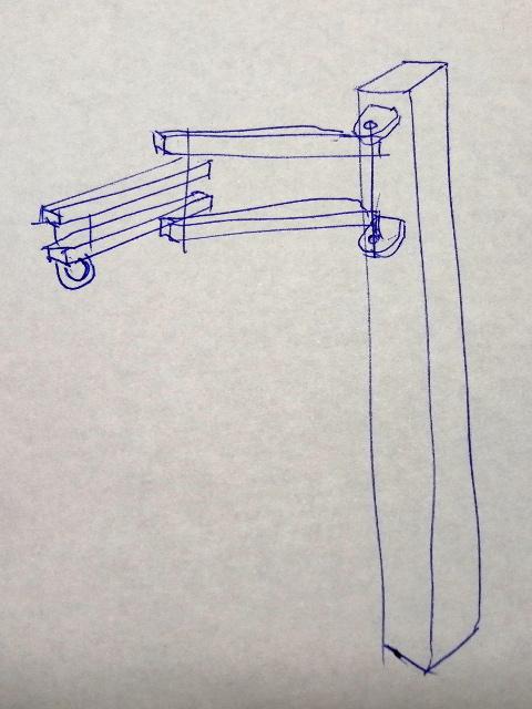

To get better visibility I removed the filter from the vent and shone a torch in revealing  a niffty bracket along the top of the controller stopping it sliding forward.
It was at this point I dropped the torch inside and no way could I get my fingers to it  :bang:
However feeling about inside as far as I could reach I discovered some Bakelite knurled headed screw knobs holding the surrounding panel in place. They were far too tight for hand unscrewing, and gripping them with pliers took some major contortions but they all came off in the end allowing me to unscrew the panel, get my hand in further to rescue the torch, and also see that the square holes under the controller were obviously intended to support a temporary shelf to pull the controller onto.
I cut some 3/4" square bar to make two supports for a bit  of surplus aluminium plate as a shelf, and reached in and was able to unscrew the retaining bracket
Title: Re: The Sequel - Oh Blimey I bought a CNC Lathe (Beaver TC 20)

We have company for lunch today so no real play time having done the animals, but I did manage to draw up a sheet metal 'Shelf' in Autocad to replace that bit of aluminium that I'd previously balanced on the bars.
Drawn in Autocad, saved as a .DXF, imported to SheetCAM, ported to MACH3 and cut out of 2 mm Zintec steel on the CNC Plasma Table  then bent on the Edwards Box & Pan folder- the Plasma table certainly makes this sort of thing so much easier.
It sits nicely but some how I want to bolt it to the bars, so when they are withdrawn it stays as a single unit, but I want to preserve the undrilled top surface - might need to break out my stud welder and see how accurately I can place studs  - I can see it will be useful for paper work at the monitor when it's original purpose of removing and replacing the controller is done with  :thumbup:

I realised that getting the coolant tank where it needs to be might be a bit of an issue, as the workshop is a bit cramped now (!) so I made up a bit of wood to act as an analogue of the tank  - much easier and lighter to manipulate - and in fact there is no problem.
But crawling on hands and knees to see if there was enough vertical clearance to put the tank on rollers (there may be) I made a DISCOVERY . There is a further big panel that can be removed at the back of the lathe (it's about 1 metre square) that I had previously missed. Taking it off it revealed that the original top of the coolant tank has been stuffed in there along with the coolant pick up and pump - just as well I found it before anything starts moving as the pipes are laying on the Z ballscrew. BTW the Z servo motor is HUGE !
Being able to get my head in the back of the machine here has let me have a better look at a mystery louvred metal box fixed on the rear of the axis drive amplifier cabinet. It's 15" wide x 9" deep  x 20" tall, has a single umbilical cord of Adaptaflex trunking going into it and absolutely no markings what so ever. I suspect that it houses a transformer or maybe from the shape several transformers  :scratch: Perhaps I'll be able to open it up sometime.

Clean clothes called for this afternoon as guests arriving, so as an exercise I drew up a 3D model of a 'blanking plug' for the Tool Turret. In an ideal world I would have blanked of each open hole before using the wire brush, but had no blanking plugs. They seem astronomically priced at about £30 each - so my Cetus 3D printer is cranking one out as I type.
It's an interesting tool clamping system. The 40 mm diameter spigot has a rack of 4 mm pitch cut into it. The spigot enters the hole in the tool turret, and as you rotate the 8 mm hex locking key, an internal rack  advances and engages the spigot pulling it tightly against the reference flat on the tool turret. There is a dowel to ensure alignment, and a pick up for 'through coolant'. System seems to work quite well.

The hinge for the Tail Stock access door arrived this morning, but it is really too flimsy for this application. I've ordered a far heavier duty one (2 mm thick)  from RS Components that should arrive tomorrow morning. This one has the advantage also that it is un-drilled, so I can pick up and reuse the existing tapped holes in the door frame.

At last today the heavy duty piano hinge arrived for the Tail stock Door, so a suitable length was cut off, I picked up the four tapped M6 holes in he door frame and drilled matching 6 mm ones in one leaf of the hinge. When I'd checked that they aligned OK, I opened the hinge holes to 8.5 mm to get latitude for adjustment when the door is swung.
After a test fitting of hinge and door balanced together in the frame, I then spot welded the un-drilled leaf of the hinge to the door, gave it all a good clean up with IPA, and sprayed the inside RAL9001 to match the machine.

Post by: awemawson on October 02, 2018, 03:17:57 PM
In anticipation of PK working miracles with the Renishaw Probe electronics, I decided that it was time to plan a re-do of it's wiring. As I think I've previously mentioned, it seems to be a field upgrade with the necessary wiring just draped any old place that they could get it. The MI-12 interface unit is hard wired in, and just sitting on a shelf.
I wanted to get the wiring in existing trunking while the lathe cabinet sides are off, and wire the MI-12 interface via plugs and sockets. It needs a 24 volt supply from the main I/O supply in the rear cabinet (2 wire plus screen), an output to the appropriate card in the Siemens 820T controller (again 2 wire plus screen) and a multi-core to the OMM that PK has on the other side of the world (5 wire plus screen)
I chose XLR style connectors as I already had two of the three, arranging that the 3 pole ones were opposite gender to prevent them being able to be confused.
Initially I'd intended to mount them on a bit of the trunking in the cabinet where the MI-12 sits, but then decided that it would actually be easier to mount them in a separate box which then could be fixed to the trunking as an independent item.
So, first let's see the problem
Post by: awemawson on October 02, 2018, 03:25:24 PM
So a quick pencil sketch, rapidly followed by an Autocad drawing whose DWG file was processed by SheetCAM to give me a CNC-Plasma ready file to cut.
I used 2 mm plate, in retrospect I think that this was a bit OTT, and 1.5 mm would have been a better choice as it would have bent more crisply in this small size, but it's come out OK
Having cleaned up the cut profile with a sanding disk, and made sure that the connectors fitted their odd shaped holes, I then bent it up, and soldered the corners. After a bit of a clean up it got a coat of zinc rich paint followed by a coat of satin black.
So it's now all ready to fit - I will probably run new cables rather than disturb the old at this point, as when the OMM returns I don't want the uncertainty of replacement wiring muddying the waters when it comes to testing - anyway the existing stuff is a bit mangled in places (although intact)
