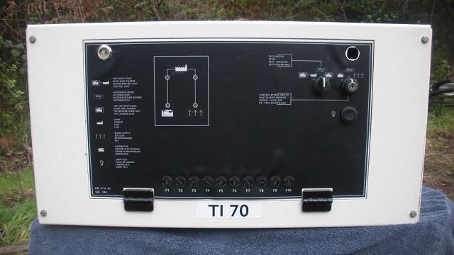

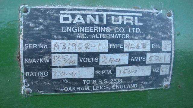

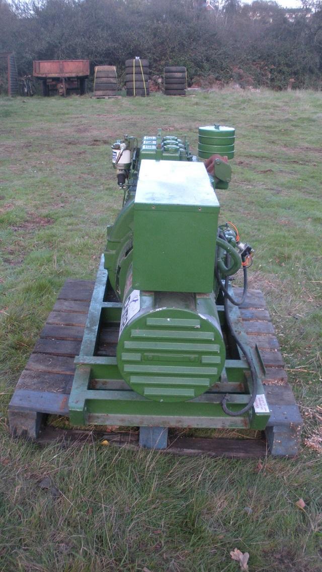

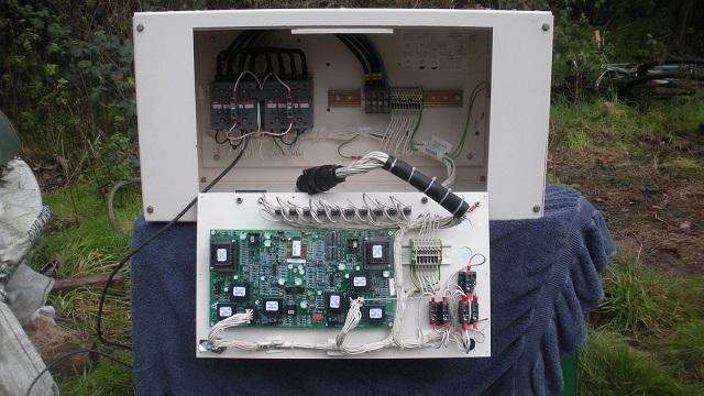

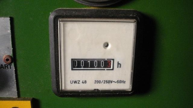

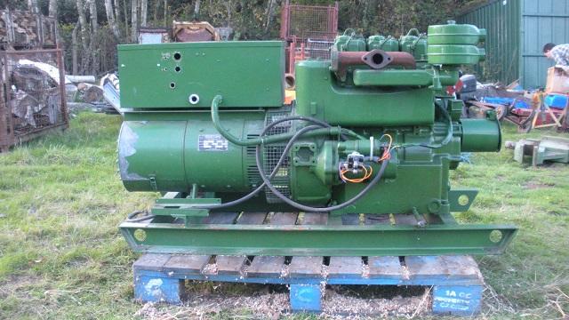

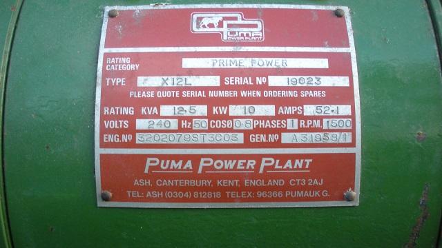

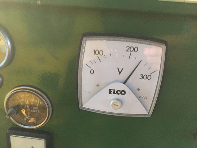

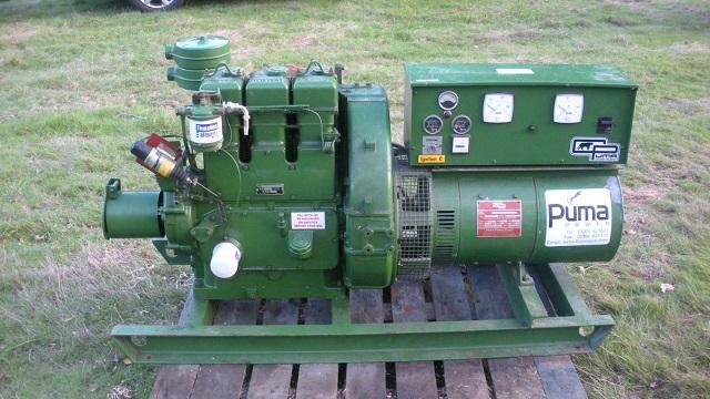

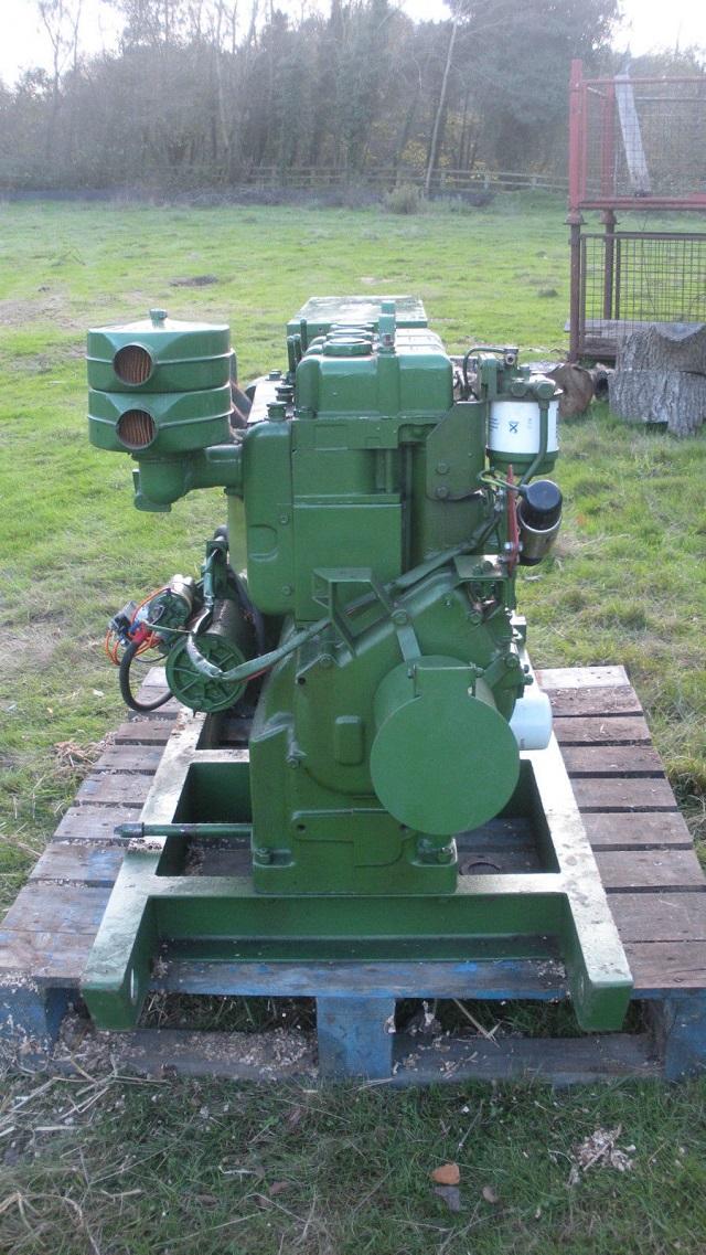

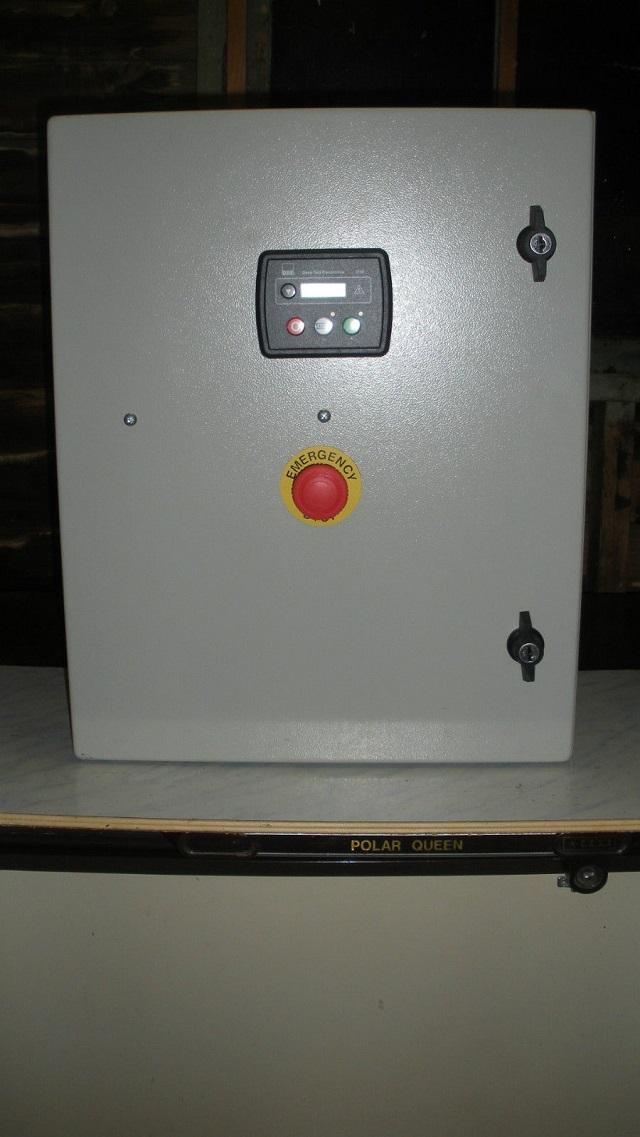

Well at long last I have been able to source a generator that meets my specification in price and 'solidness' !
It's based on a 3 cylinder Lister ST03 diesel engine driving an alternator rated at 12.5 kVA as a base load. Many of the modern import generators are useless for long running, and although this hopefully will only ever occasionally run for a day or so it should do it reliably.
It has been a stand by set in Council offices and probably has only run for regular test runs, showing 100 hours on the meter.
Our absolute top load limited by the 100 amp company fuses is 25 kW so 12.5 will amply cover virtually anything running, including our 'cottage guests' using their hobs, ovens, kettles etc !!!
Re: Bally Power Cuts !
« Reply #18 on: December 01, 2014, 04:56:29 PM »

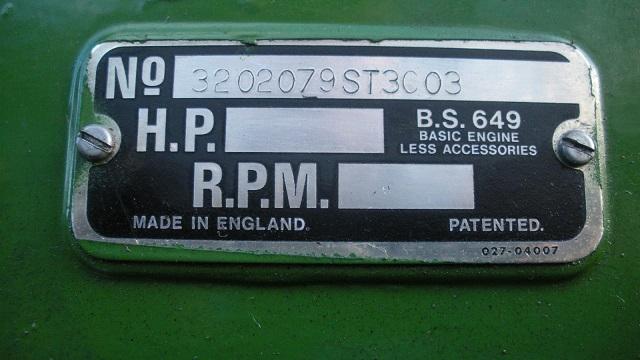

I think that the engine dates from the mid to late 1980's - it may or may not have been new when Puma incorporated into a generating set - it's obviously been re-painted looking at the engine plate.
Not physically seen it yet - just been arranging for it's collection by a pallet company. The good thing is that it comes with a brand new auto change-over starter panel
« Reply #19 on: December 01, 2014, 05:02:51 PM »

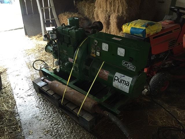

It's fairly doubtful that I'll have it installed and up and running this winter. I need to construct some sort of weatherproof housing for it close enough to our main power connection, and also fabricate a fuel tank. The design of the housing is a bit limited as it will be in a pretty visible place. I suppose that I could locate the main change over relay close to the company meter in a wall housing, and drive it remotely, so I could tuck the generator out of sight. That at least reduces the run of heavy duty cable (25 or maybe 35 mm csa) to one pair as it is stupidly expensive  :bugeye:

That's a very nice looking genset, colour me jealous... I still haven't sorted out my CS-based backup unit yet (one day, one day)...

PS: Engine is 1982 - add 50 to the first 2 digits to get the year; next set of digits are the engine no, then the type (ST3), rotation (C is probably clockwise, vs A for anticlock BUT... it could be C=counterclockwise and blank = clockwise... the dating page doesn't elaborate). The trailing 03 is the build number. Again, what this is is not specified...
http://www.oldengine.org/members/diesel/EngineDating/Dating6.htm
« Reply #22 on: December 02, 2014, 12:43:32 AM »
I may be wrong, but I thought that Lister was British, anticlockwise is a US term, so I would imagine that it is anti-clock and clockwise!
Regards, Matthew./
« Reply #23 on: December 02, 2014, 02:38:01 AM »
Ade - a very kind offer thanks
Matt , when I used to work on large American disk drives they used 'CW - clockwise' and 'CCW - counter clockwise' but Google tells me that Lister, who are / were British, used Z as the anti clockwise indicator.
« Reply #24 on: December 02, 2014, 08:25:28 AM »
Regards, Matthew./
My slip, I wrote it the wrong way, counter clockwise being the US term! Lister use "Z" strangr!

That's a fine genset, Andrew. Very envious!  :beer:
« Reply #26 on: December 02, 2014, 11:39:51 AM »
It ain't arrived yet Steve - it may be a clunker  :bugeye: But I sincerely hope not  :scratch:
But it's exactly what I was looking for (if it works). I have a friend who went 'off grid' for a couple of years and he must have brought his 'far east genny' to me at least half a dozen times for bits that had broken, stuck, fatigued or just died. Horrid design and reminiscent of your 'carb and tank built into dash board' issue !

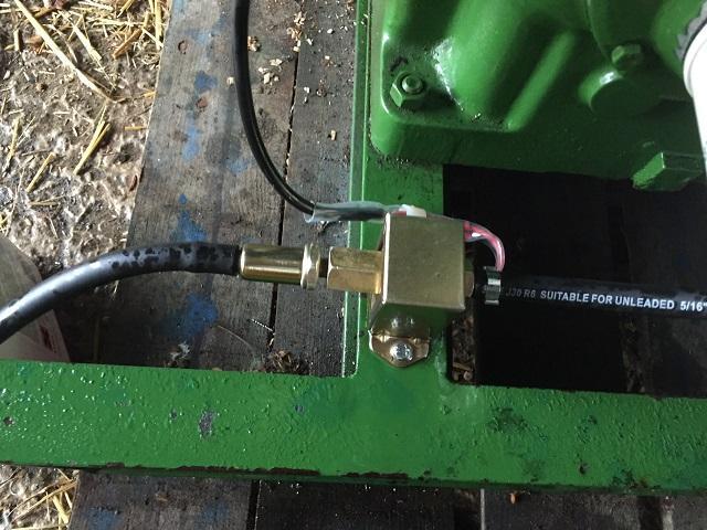

So at long last the 1/4" BSP 'banjo bolt' and 9 mm 'banjo' arrived in the post this morning so I've been able to rig up a temporary fuel tank (5 litre bottle!) and do some load testing.
First job was to crimp up the fuel line from the filter to the newly installed fuel lift pump. Easy peasy. Then to bleed air out of the system. I powered up the pump, slackened off the banjo and waited  -  and waited - - and waited - pump clacking away but no fuel  :scratch:
Initially I thought that perhaps the pump needed priming, this would have been "BAD" as it's supposed to lift a minimum of 12" dry and I need it to. Anyway I pulled the pipe out of the 5 litre bottle, put a funnel in the end and 'primed' it.
Hang on, why are bubbles coming up into the funnel - surely I can't have put it in the wrong way round, it's very clearly labelled with arrows on both side saying 'fuel flow'  :bang:
Then - well no I've put it in as labelled - surely they can't have labelled it wrongly  :scratch: Oh yes they can  :lol: :lol:
The pump is a Chinese clone of a "Facet Cube" electronic pump. It has a bent up clamp that is also the mounting and this carries the stamped flow direction markings. Un-crimped the fuel lines, bent up it's tabs, assembled it the right way round and reversed the pipes - now I stink of diesel - but it works  :ddb:
« Reply #36 on: December 18, 2014, 07:54:07 AM »

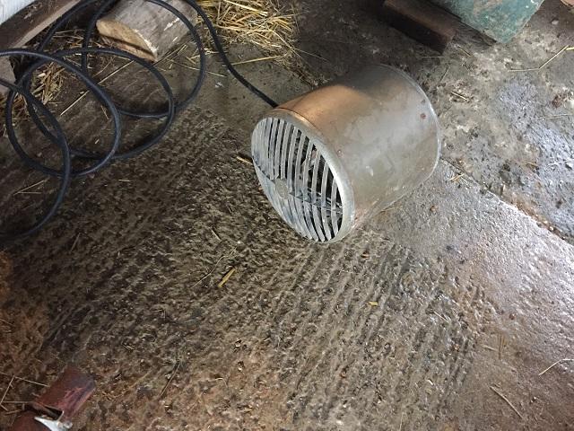

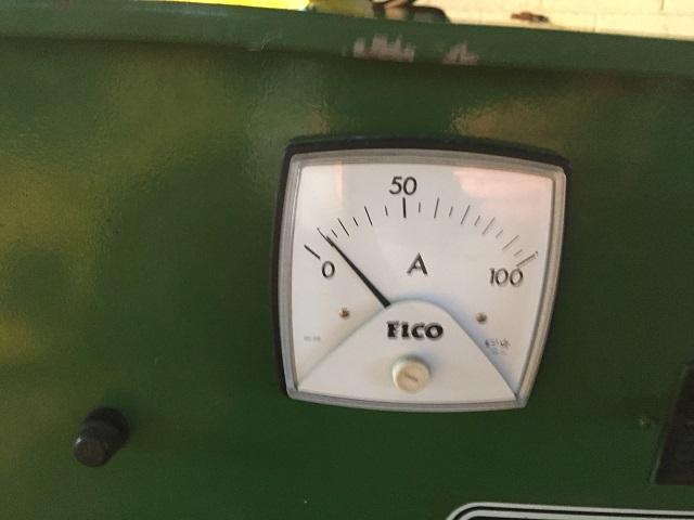

So on to the load test. It took a bit of cranking to get air out of the system and firing on all three cylinders, but we got there in the end.
Load consisted of a 4kW fan heater that's supposed to be wall mounted and a pair of 500 watt halogen lights - only 5kW and we should be able to push 15 kW at a squeeze, but it's all that I had to hand.
Took it no problems

Stuart, Lister used to sell a remote oil tank and gubbins for this engine for long running - it shouldn't be an issue for the use this will see.

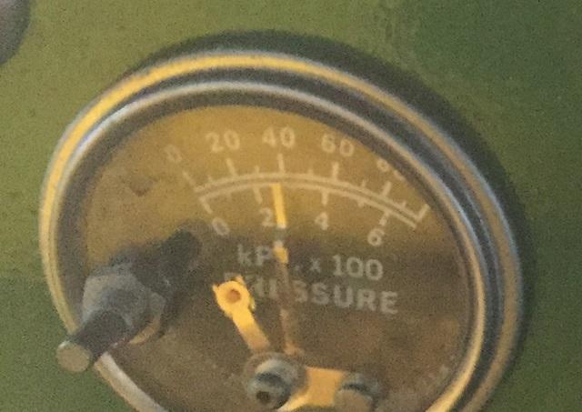

Talking of oil, I'm pleased to report that it shows good oil pressure when running.
When it arrived there was a fairly basic battery charger bolted into the box on top of the alternator, wired so that the generator charged its battery when running. Not a lot of use for a stand by generator as the battery needs maintaining over possibly many months of idleness before use. So I've removed it and intend to rig up a battery maintainer powered off the house ring main. When on normal mains, it'll charge, when the lights go out and the generator starts and powers up the house, it'll still charge  :thumbup:

Love that green! Nice genset!!!  :drool:
I imagine your Lister is a lot smoother, too, than my one lunger. I had to put down serious damping, and it's very inadvisable to start the old singles just bolted to the steel bearers. They have a habit of chasing you around the room with 200 lbs of spinning flywheels....

  • Posts: 6829
« Reply #41 on: December 18, 2014, 09:08:16 AM »
I figured a three cyl would be nice that way. What is the RPM, running, Andrew?
I think mine would be useful in the Spring if I was back into fishing. At 600 RPM, and with it's massive power stroke and weight, it shakes the earth all around. It's not unpleasant -- in fact we all think the sound running IS pleasant. Just a thump thump thump.
But my thought is, it ought to drive the nightcrawlers (earthworms) nuts on a spring evening when they're near the surface and easy to collect. I bet there would be hundreds of them out ready for the picking up with a little run of my genset!!
There ought to be a Roald Dahl story about that!
ps. We Yanks aren't up on our greens like you guys are -- much to our detriment, ornamentally.  I just figure if a motor is green it's a Lister  :palm:
Always a pleasure to see the range of door colo(u)rs you have, and locomotives not just colored black.... :beer:

I think I was rambling on about not being sure that its' actually the right colour - supposed to be "Brunswick Green" I believe, but I thought that that was darker, rather like "British Racing Green"
It's nominal speed is 1500 rpm

I'm surprised it's actually not too bad noise wise, especially considering so far I've just screwed the 'pepper pot' exhaust terminal into the exhaust manifold and left off the silencer ! Biggest noise at the moment comes from the rattling of the lid of the electrical box as it's just laying on not screwed down yet.
Putting 5kW load on made a just perceptible change in the engine note. I think it's a 1900 cc engine rate 18 BHP / 13.4 kW continuous with a 10% overload margin (just looked it up!)
