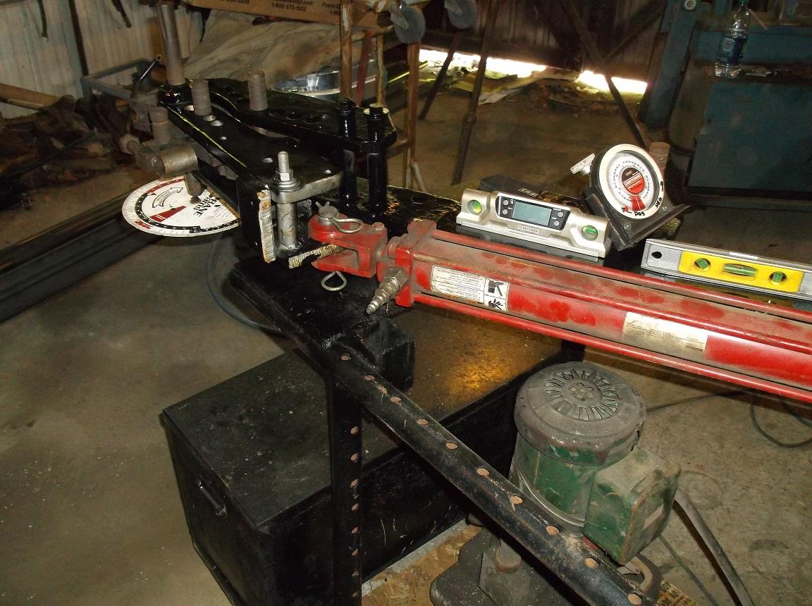

Now doing the mechanical work, bought a box of 25 chain, sprockets, cam belts, gear sprockets.

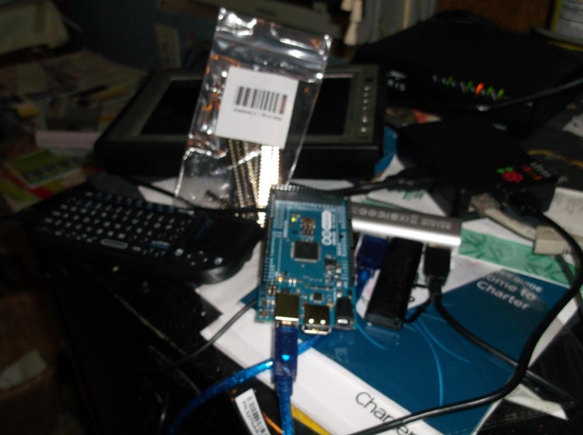

I have Grbl running on a Mega2560 arduino, It will be tied in with jumpers to a parallel port cable where it can be moved in and out in case I don't like it.. I have had some trouble with the Chinglish translation.

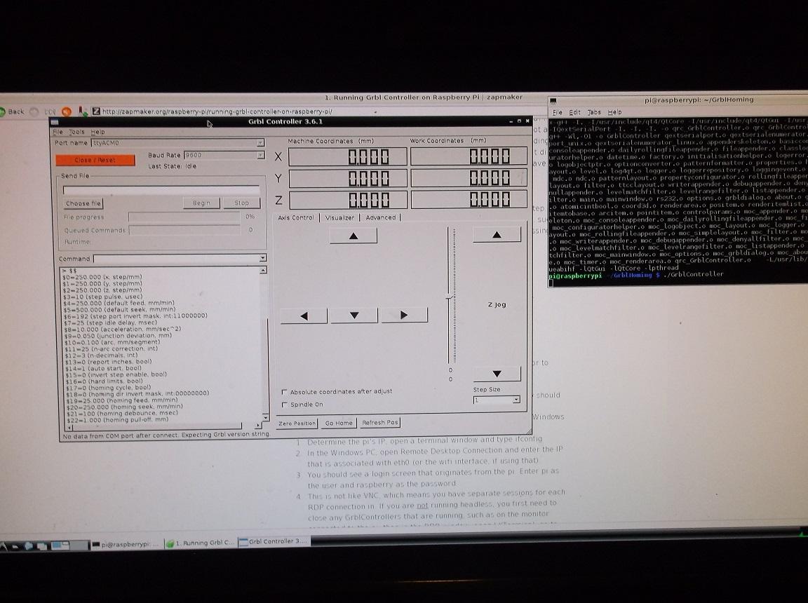

So.. new stuff.. A RASberry Pi, small micro-computer running a Arm processor. Does run in debian Linux, Java, Python, QTmaker software.  Loaded Grbl controller by Zapmaker, he has instructions on how to do this, it came from github software repository.
THE Pi can be loaded with a usb memory stick, dump to the arduino running grbl line by line of gcode, freeing up the computer to continue to monitor the wax burnout and smelter preheat, stl file cleanup, meshlab, slic3r and of course run the Bridgeport cnc .
Not as complicated as it all sounds, really..   That big bridgeport would probably run fine on a grbl Arduino, it has a cross slide that weighs about 350lbs and is slow as hell with the geckos just throwing 7 amps at the 1200oz steppers. BUT then all the great wizards Art put in there would not be at my disposal. (polar holes, hole arrays, text engraving, etc)
I am fixing to wire that mega to a parallel cable.. choosing to use jumper wires going to a terminal strip, or wire wrap, heat shrink and solder to the tiny wires in the cable. THOSE db25 cable wires are so small when you tighten a screw, it cuts them in two and they fall out.

MY newest creation here is a cnc plasma table, servos, gearboxes, chain drive.. running on "plastic trolley wheels" on inverted angle iron.. I started out big, now have shrunk it down to 7'6" x 5" x 10".. it may get a router, drill, tapper, and eventually laser.  Stepper motors are much easier to "tune" in.. servos "hunt" all around where you want them to go. It really needs a dual trace  o-scope to make them right where you can see input and response waves.
