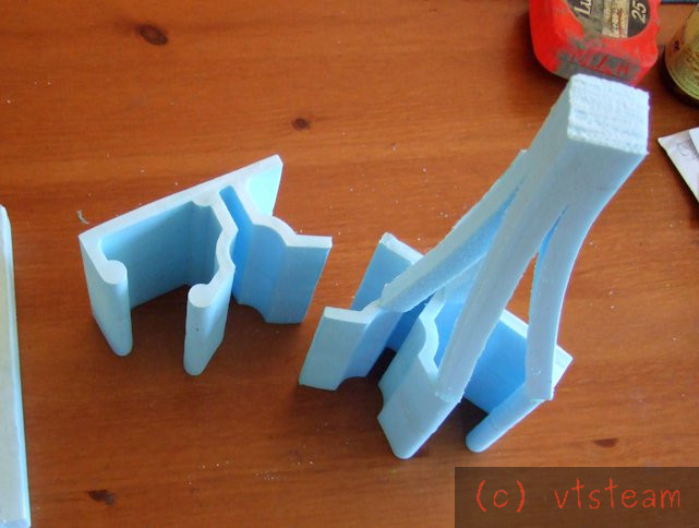

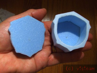

Since I got my Popular Mechanics boiler steaming I really wanted to make a new small steam engine to go with it. I especially like twins, and have a couple Westinghouse style versions. I was just thinking of a V-twin this time, instead of an inline,  and with OKTomT doing a really nice full size IC V twin motor bicycle engine, I wondered if I could use a similar crankcase on a steam design. So I started in on what I hope will be a lost foam casting.
I say hope because this one really may not work out well. One reason is, it's very thin walled and it's going to be tough to get full penetration of the metal. The other is, I'm going to try lost foam with zinc diecast metal instead of aluminum, which I've used before. The lower pour temperature of this metal (by nearly a third )may not burn out the foam. So all in all, my hopes aren't great for this working out. Still, you never know until you try, and it's definitely something I wanted to satisfy my curiosity about. If it doesn't work, I can always try a hotter metal.
Here is the foam crankcase as of yesterday:

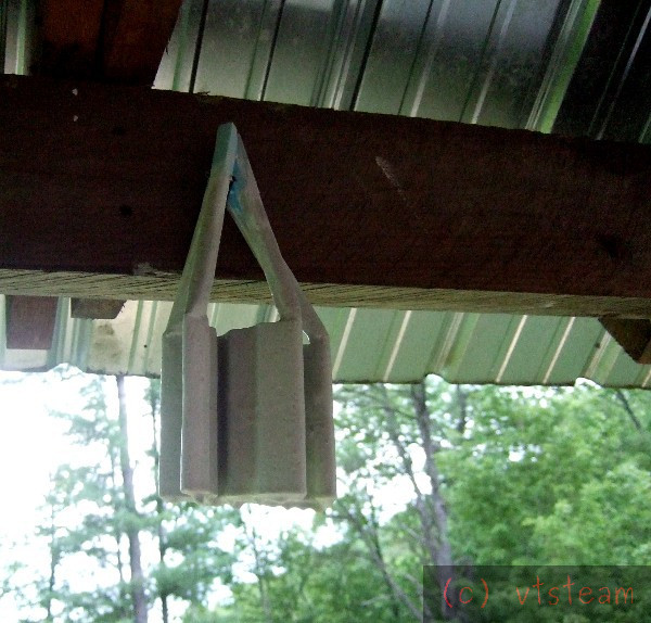

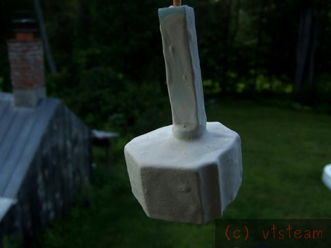

I added bearing bosses and sprues today, and then plastered the patterns. Here's how it looks tonight:
« Last Edit: January 13, 2018, 05:56:50 PM by vtsteam »

It's been done that way Oz. But it would need a thicker more supportive investment, and maybe heat, etc. to drive off the moisture, solvent and residues. It gets to be more like lost wax casting -- quite intensive
This way is, I believe quicker and simpler (well only if it works!). I hope to cast tomorrow, and we'll know pretty quickly!
I've cast this way before with aluminum and a larger thicker walled casting:

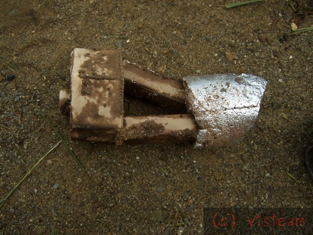

The casting was a disappointment. It looks as if the polystyrene melted but didn't burn off, so there are plenty of flaws in the casting. The metal didn't have enough heat to do the job, as I suspected it might not. I'll post some pics later.
I have another foam pattern ready to go and will probably try aluminum tomorrow.

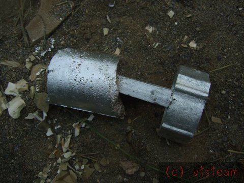

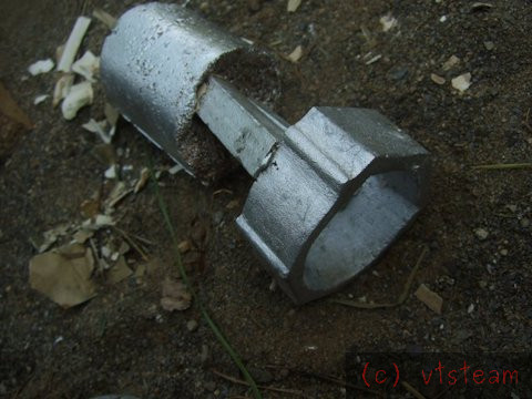

Here are some pictures from today's casting:
The shake out. I was worried I hadn't got complete fill of the molds, but was happy to see in the shakeout that both molds filled -- the brown discoloration of the plaster was a good sign. The split pipe pouring basin leaked so I didn't have as high head pressure as I'd hoped. There was no flare, and only what looked like two small bubbles during the pour.
« Last Edit: January 13, 2018, 05:58:56 PM by vtsteam »

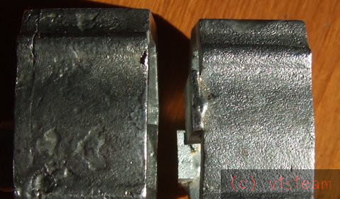

There was a small leak of metal inside the crankcase. Unfortunately this area caused shrink problems on the other side of the casting:
« Last Edit: January 13, 2018, 05:59:27 PM by vtsteam »
  • Posts: 6934
Re: Lost foam casting a motor
« Reply #12 on: August 08, 2014, 08:12:50 PM »

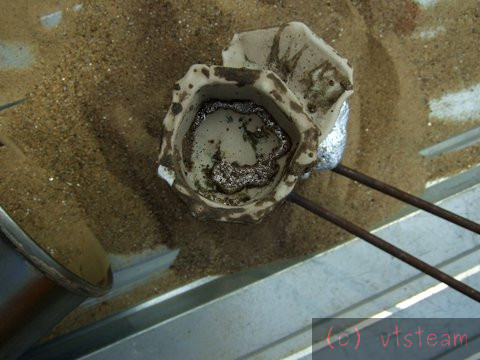

This is what it looked like after partial cleaning. You can see where metal flows did not fuse completely. This was because the metal was too cool and also had not flashed off the foam polystyrene. The tan-bluish area on the coverplate is investment and polystyrene foam residue mixed -- it inhibited metal fusing in some areas. It's also tough to remove. The relatively thin casting also makes it hard for the metal to retain heat while traveling and melting foam out.
I'm not sure if I can pour hotter than I did this time with zinc diecast material -- normal pouring temp is only 750F -- aluminum can pour fairly easily around 1100F or more and is a material which has a lot of retained heat. It always flash burned  the foam when I used it for lost foam casting in the past.
« Last Edit: January 13, 2018, 06:00:02 PM by vtsteam »

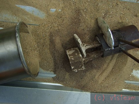

I made up a new pattern to try again today. While waiting for the investment to dry, I played around with the bad casting just to see what the final case should look like.
Some face milling and filing made it look quite a bit better -- it's thick enough that I probably could get rid of almost all the surface flaws if I kept going, but this was really a casting exercise, and I want to get a really good casting before I settle down and build an engine.
I'm tempted now to try diecast zinc one more time, tomorrow, instead of aluminum, just to confirm that it won't flash the poly. Maybe I should have used two sprue/risers for faster fill, more heat, and some air -- so I've done that for the next set of patterns.
« Last Edit: January 13, 2018, 06:00:38 PM by vtsteam »

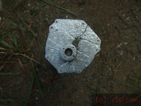

Well I went with a second try with zinc alloy lost foam today, instead of aluminum. I just had to see if maybe pouring hotter and a couple of sprues instead of one to get the metal to fill faster, and inverting the pattern to get the good face down would work. I also added a lot of little vents with a needle, hoping to let out any gasses. I sealed the split line in the hinged pouring cup so it wouldn't leak, and maintain head.
I poured at 452C which was pretty hot, I figure, for zinc alloy. And the bubbling off of the polystyrene looked much better -- more like it does with aluminum, though it still didn't flare. The pouring cup stayed full, and so added head pressure and fed the casting as it cooled. Break out looked better than it had yesterday:
« Last Edit: January 13, 2018, 06:01:19 PM by vtsteam »
  • Posts: 6934
« Reply #15 on: August 09, 2014, 06:09:40 PM »
Unfortunately there were still flow lines and unvaporized polystyrene, though less and the casting flaws were shallower than yesterday's pour:
« Last Edit: January 13, 2018, 06:01:54 PM by vtsteam »
  • Posts: 6934
« Reply #16 on: August 09, 2014, 06:13:05 PM »

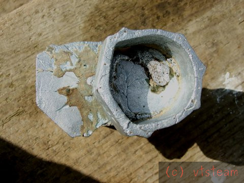

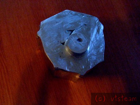

The surface finish was better than yesterday with fewer flaws, but nothing like the pattern fidelity I'd got with aluminum pours in the past:
« Last Edit: January 13, 2018, 06:02:34 PM by vtsteam »

Because the flaws didn't seem very deep, I put the casting on the mill and cleaned up a few surfaces with my carbide end mill. It looked good, so I will probably make an engine from it. I'll turn the front face and bearing boss on the lathe, but i just used the mill to see how deep the flaws were -- about .030" total out of nearly .250" so it's still a pretty heavy case.
For casting zinc alloy with lost foam, I'd say the patient survived, but the operation wasn't a success. I had hoped surface fidelity would be similar to the aluminum castings I'd done in the past. But the failure at high casting temperatures (for zinc) to vaporize all the foam meant flaws and poor surface finish. So I don't see it as a viable method for me in the future. Nevertheless, It looks like I'll get an engine out of it -- probably the only one I'll ever do this way.
I may yet try an aluminum version, just to check that the pattern and molding method weren't the problem for this particular casting:
« Last Edit: January 13, 2018, 06:03:19 PM by vtsteam »

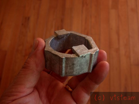

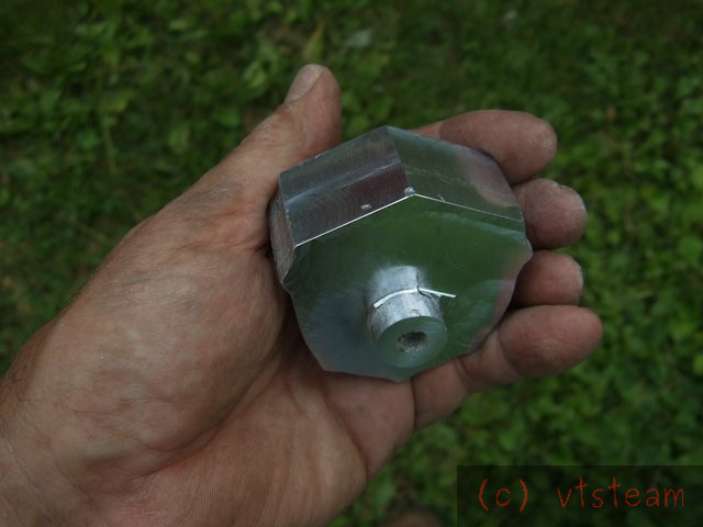

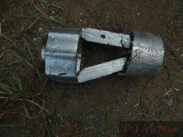

Had another go at zinc today. Altered the pattern, and it went well. This time I've got good fidelity -- the texture of the foam is plainly visible. Even the little blob of hot glue attaching the sprue got cast as zinc.
« Last Edit: January 13, 2018, 06:04:44 PM by vtsteam »

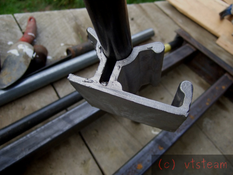

It is Matt. Here it is off the sprues:
« Last Edit: January 13, 2018, 06:05:21 PM by vtsteam »

In case it helps others, these are my notes re. zinc and lost foam on this scale casting:
Pour temp 450C
A sprue is needed every 35 mm or so on perimeter of a 6mm wall, 2 spue minmum before loss of detail.
Max depth of 6mm casting wall is about 25 -35 mm before too much heat is lost.
Horizontal 6mm plate doesn't work. Keep mold cavities vertical.
Deep pouring basin/riser needed -- there is a great deal of shrinkage and this kind of thin casting needs good head pressure to maintain detail.
Use plaster of Paris in preference to drywall (calcium carbonate). It speeds up the process (pattern can be cast in 3-4 hours including cure and open air drying instead of 24-36  hours open air drying. )
And, critical difference noted today -- young plaster of Paris absorbs molten polystyrene, which drywall does not, thus removing it from the casting. That enabled good fidelity in this margnal low temp lost foam process. While zinc pour temps can't flash the foam into gas as aluminum can, poP makes up for this by absorbing the liquid polystyrene away from the melt. Calcium carbonate traps the polystyrene inside the mold.

  • Posts: 6934
Re: Lost Foam Casting: a Crankcase in Zinc Alloy
« Reply #36 on: August 11, 2014, 07:09:22 AM »
Eugene, the pattern is the most important part of any mold. People often get caught up in the technology of sand, or furnace refractories, burners, metal composition, gating and risering, fuels, etc. in casting. Yet knock a couple pieces of wood together for a pattern.
Casting starts with the pattern and its finish.
I spend a lot of careful time with very fine sandpaper, even on the foam cutouts to get them as good as I can before using them. More time than they took to cut out  by machine. I use little strips of sandpaper under a strong light. Oudtoors on the porch in summer is perfect!
I do the same with wooden patterns, and use filler and sanding sealer coats, each sanded down, and several coats of spray colored lacquer to finish. Most of my practice for this kind of thing comes from building model airplanes, which I've been doing as a hobby since I was 14.
Oh one other thing about cnc hot wire foam cutting. You need to go VERY slowly for a machine process. 1mm/sec to get good quality cuts. and you need thin wire and low temps to match. I use .011" stainless steel fishing leader as a hot wire.
If you don't have a good pattern, all the time and money in the world invested into the latest metal casting forum technology will just get a person a lump of scabby metal. Sand break outs happen because the pattern is rough. Inclusions ditto.
Conversely, I've found that the crudest casting equipment will turn out good faithful castings with good finish if the pattern is good and the technque is sensible. My iron foundry is made from ordinary firebrick, and clay and sand. The fuel I use to cast in aluminum is store bought charcoal briquets or home made charcoal. For the last few zinc castings I just used wood for a fuel. Ordinary plaster of Paris with no additives, no bake out, air dried for a few hours and ordinary scraps of foam were used for a pattern.
I like simplicity, and I am impatient, and I hate to waste things. I use what is available and try to do a good job with it. I study what happens and I gradually think through why it didn't go as I wanted. Eventually the problems get worked out by trial and error until I understand my own equipment and materials.
Anyway, it is great that you ask, and the answer is a lot simpler then I've ended with here. Just take a little sandpaper and do a very careful job, with a light touch. A few times through it, and you'll get good at it. It's nothing more than that.  :beer:
« Last Edit: January 13, 2018, 05:48:18 PM by vtsteam »
  • Posts: 6934
« Reply #37 on: August 11, 2014, 07:52:18 AM »
Eugene, re-reading your question, I see you probably don't have  a cnc foam cutter, and that isn't a problem for getting good patterns at all -- you must be using a hand bow, or vertical fixed wire. I did that for many years. The main thing again here is to have good templates --smooth ones, just like the need for smooth patterns in casting.
The way I made foam cutting templates was to cut them out of sheet aluminum with tin snips (after pasting a paper printed pattern on top) and then filing to the line with a fine file. The fine file is essential.
For small patterns (rather than wings) a vertical wire and table is best. After that comes sanding the foam pattern, as it does with CNC, as well.
Low temperatures, slow smooth movement, thin wire are all helpful, but the blank is only a blank, and hand work refines a pattern to what it should be.

  • Posts: 6934
« Reply #39 on: August 11, 2014, 09:55:33 AM »
Hi Andrew -- my wire cutter is just a plans built wooden drawer slide style wing cutter -- quite crude, and looks like the original here:
http://www.drayconstruction.com/foamstuffs/
except that I used 3/4" birch plywood instead of the plans shown MDF.
It's not a particularly good or accurate "machine" as you can imagine but it does cut wing cores, and an occasional pattern. I bet practically anybody here could design and build a better one. One big problem with the drawer slides as designed is they protrude off the ends as they slide to the far end, so you need a far bigger area than the cutting area.
In general, I don't like cnc hot wire cutting, and for all tapered wings I now use a pivot wire (manual wire attached to a fixed point, used with a single airfoil pattern). It's much faster and not prone to CNC programming errors -- which can quickly eat up a LOT of good foam. If I had to cut the same wing in production, maybe CNC would make sense. But for occasional one off, it seems I waste 3 panels getting one good one, and it takes hours of first programming, generating G-code, cutting a blank and positioning it for wire cutting specing the taper and finally cutting at 1mm/sec, meanwhile watching it in case something goes wrong.
I wish I could say that it's magic, and easy but frankly, I'd rather cut a one off part with a hot wire by hand.
I'll show you my crude hot wire jig saw instead, which, with a simple foam pattern to do, can cut far more quickly than the CNC would.  Back with pics later.....

  • Posts: 6934
« Reply #42 on: August 11, 2014, 11:31:16 AM »
Andrew, sorry, you're right it is quite accurate enough for wings since movements are relative and we tend to sand things, cover them etc. I just wanted to warn exacting machinists that the accuracy isn't what they would expect from ball slides and a rigid gantry, etc for a CNC mill. and metal work.  And for pattern work, we usually expect surface finish to be at least foam texture, and likely having a machining tolerance as well.
A hot wire has a variable kerf width also depending on the direction of cut. Because the wire is cutting by radiant heat (properly) rather than contact, and the melted foam gasses travel upwards an upward vertical cut is wider kerfed than downward, and horizontal varies with angle from horizontal, etc. Also depending on software, speed of cut tends to vary around curves, somewhat -- naturally the wire is in an area of foam longer when doing a tight radius and can actually melt out a section even though the linear speed stays the same. etc.
Some software compensates for this (somewhat) or some people play the heat control manually. Still others accept the slight variation (yours truly!).
All this tends to make for even more wasted material when you suddenly lose a section that on paper (in CAD, I mean) it looked good.
When you work manually, the knob between your shoulders does some amazing compensation at times after a little practice, seemingly without any calculation, just by the appearance of the cut. And quickly adjusts placement of a part to best utilize remaining scrap after a botched piece -- something that's difficult to re-program into a CNC machine as quickly.

  • Posts: 6934
« Reply #49 on: August 11, 2014, 08:38:08 PM »
This morning with the sun coming in low through a window it was possible to highlight the difference in surface finish and detail fidelity of the second casting and the third (last) one.
On the left we can see the zinc separated from the mold walls by layers of molten polystyrene. The drywall compound was not absorptive and the plastic stayed inside the mold.
On the right the you can see that the actual texture of the foam has been recorded and transferred to the metal. Polystyrene was pulled out of the mold by absorptive plaster of Paris allowing the metal to cool against the mold sides and record the very fine detail of the foam texture. And a blob of hot glue which was used to attach the sprue to the pattern is also preserved in perfect detail on the left
