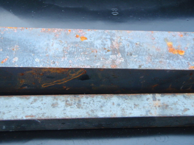

I pickled some steel and what do you know? One piece is machined! I can see machining marks and corners are sharp too.
The other piece seems genuine item. "Flakes" have fell off and it has rounded edges as VT pointed out before. Pretty evident when you think of rolling process.
So here is the picture. Is it picked enough?

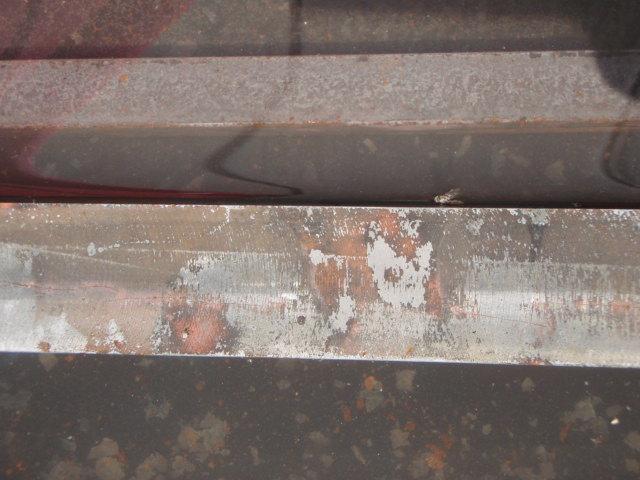

Breckfast condiments seem to work wonders! I'm genuinely surprised. One day and mill scale & rust all gone, just a little brushing with nylon brush, wash with pine oil soap, drying and light oiling. I filtered and bottled back the vinegar. Not sure how fast it is spent, but hard to believe that it would do any damage on the plastic drain or on effluent treatment plant.
Some easy to separate solids were left. I like this. Some mild chemicals that you can buy from the shop, little time on the tub and done. No sparks, no noise, no obnoxious chemicals or waste to deal with.
I trawled selves of two stores for Muriatic acid discuised as toilet bowl cleaner....no luck. All were perfumed detergents. Hardware store had some branded Masonry Cleaner, but a less than 1/2 litre bottle cost way over 20€!
But I found some other drain opener PH13 and used it strip paint from cast iron parts.
* Forgot the compulsory piccy!
