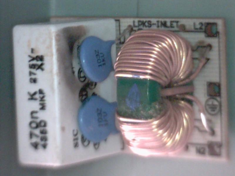

last night I wished my PC had the same linear power supply
I switched on and bang  , the lights went out  :doh:
a capacitor in the mains filter had failed - the power supply works OK without it  :D

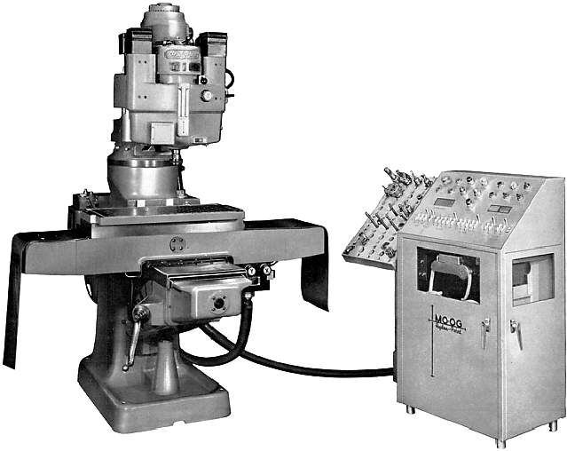

My first NC (not CNC) was a Moog Hydrapoint 1000. It used paper tape (or console) input but used air blown through the holes to read the tape !
No balls screws, or feed screws of any kind, positioning was done by hydraulic servos, there were binary coded sliding steel plates, the code being detailed by holes in the plates. The servo system homed in on the one hole that lined up through all the plates. Plate positions were set up with pneumatic activators through the paper tape, or air switches on the console.
My crowning achievement with it was to make a PC parallel port to 24 bit pneumatic interface using pneumatic pilot valves to mimic the paper tape (which was read in three stripes at a time hence 24 bits).
When I got it the free standing console umbilical cables had been separated from the machine by hack saw. They were 3" flexible conduit packed with 3 mm nylon pneumatic pipe. All the same colour and no documentation  :bang: Got there in the end.
Like the picture below, but mine had a tool changer carousel.
Did I say I like a challenge  :ddb:

I'm sensing a certain parallel theme, Andrew, dating back a long way prior to the Traub.  :dremel:
I think you ought to quickly grab the domain name LazarusCNC.com and open for business!

Steve, I just think it says 'MUG' across my forehead. I see these insoluble problems and convince myself that they are soluble given a bit of head scratching  :lol:
