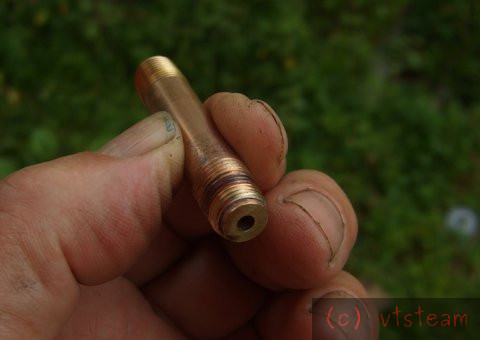

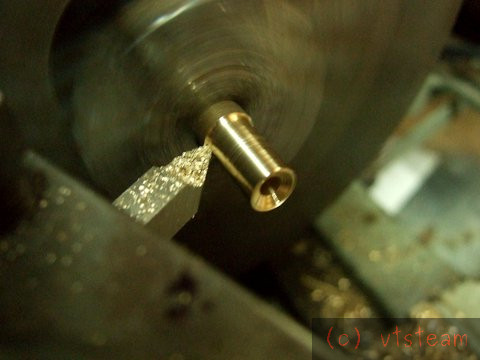

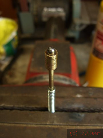

With most of the other problems solved, it's back to the relief valve today. I decided to do an outside barrel ball and spring type, but to use as much ready-made brass plumbing as I could, to keep with the overall theme -- which turned out to be quite easy.

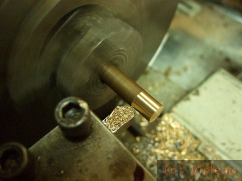

First I turned a bit of brass to the ID of a 1/8" brass pipe nipple:

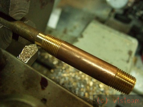

« Reply #83 on: August 03, 2014, 06:43:20 PM »
Checking fit:

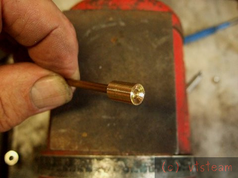

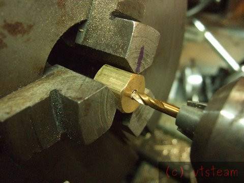

« Reply #84 on: August 03, 2014, 06:44:35 PM »

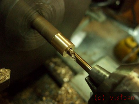

Drilled to 1/8" for the steam passage:

« Reply #85 on: August 03, 2014, 06:47:45 PM »

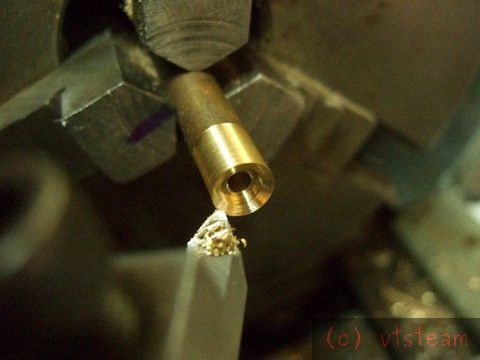

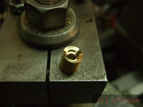

I drilled a recess of 3/16" then added a bevel out to the edge of the valve seat plug. These two steps will help guide the 3/16" stainless steel ball to the 1/8" valve seat at the center.
« Last Edit: January 12, 2018, 11:22:03 PM by vtsteam »

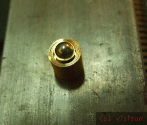

« Reply #86 on: August 03, 2014, 06:48:29 PM »
This is a better view of it:
And with the ball in place:

Then I silver brazed the valve seat plug into the pipe nipple:
« Last Edit: January 12, 2018, 11:23:34 PM by vtsteam »
  • Posts: 6829
Re: Popular Mechanics Boiler

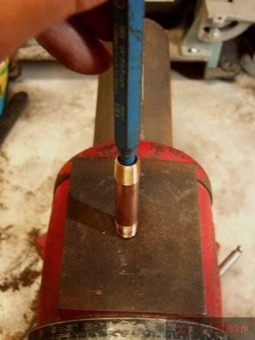

« Reply #88 on: August 03, 2014, 06:52:35 PM »
With the ball in place I formed the valve seat to the ball with a light tap on a drift.
« Last Edit: January 12, 2018, 11:24:24 PM by vtsteam »

Here's how the plunger, spring and ball go together. The plunger has been brazed to the stem already:
« Last Edit: January 12, 2018, 11:26:46 PM by vtsteam »

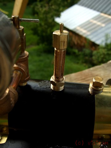

Here's the completed relief valve assembled with a 1/8" to 1/4" pipe bushing:
« Last Edit: January 12, 2018, 11:28:07 PM by vtsteam »

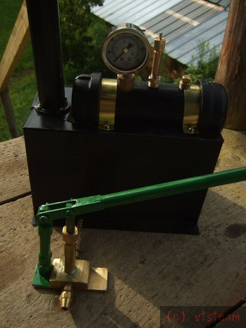

I'm looking forward to doing pressure tests on the valve tomorrow with the new hand pump. If all goes well after adjustments, we may be steaming!
« Last Edit: January 12, 2018, 11:28:37 PM by vtsteam »
« Reply #95 on: August 03, 2014, 07:26:00 PM »
That looks quite impressive your safety valve looks to be quite natural and you could also adjust the spring tension easily with a spacer.
  • Posts: 6829
« Reply #96 on: August 03, 2014, 08:00:05 PM »
Thanks Tom, I;m going to re-thread the top end of the barrel from 1/8" pipe taper thread to 3/8" straight thread so I can screw down the cap to adjust pressure somewhat. Probably put a thin locknut there if I do so the adjustment can be locked. Right now the friction of the taper thread works, but there's little adjustment.
The main adjustment on this type of safety valve, though is the spring itself. The current spring is a hardware store type. I have a few others with different rates that I bought today, but all are spring steel. Once I find the right one for the working pressure, I'll either order a stainless version from McMaster Carr, or if I have the right SS wire, try winding one myself.
I was wondering where I would find SS spring wire, and then remembered I have quite a selection of saltwater stainless steel fishing leader stock, which is about as stiff as music wire. I think i would make good springs.
Looking forward to tomorrow!
