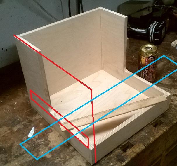

I've ordered the shafting and bronze bushings from McMaster and have cut out the frame from 1/2" baltic birch...
I spent a lot of time getting everything as exact and square as I could.  Should make things easier later on.

« Reply #3 on: November 23, 2014, 11:10:31 AM »
Hmmm...if you make the sides full sized, rather than the "L" shape, then just make a slot along where the table moves, it would allow you to do longer pieces.
Looks like a fun little project.
