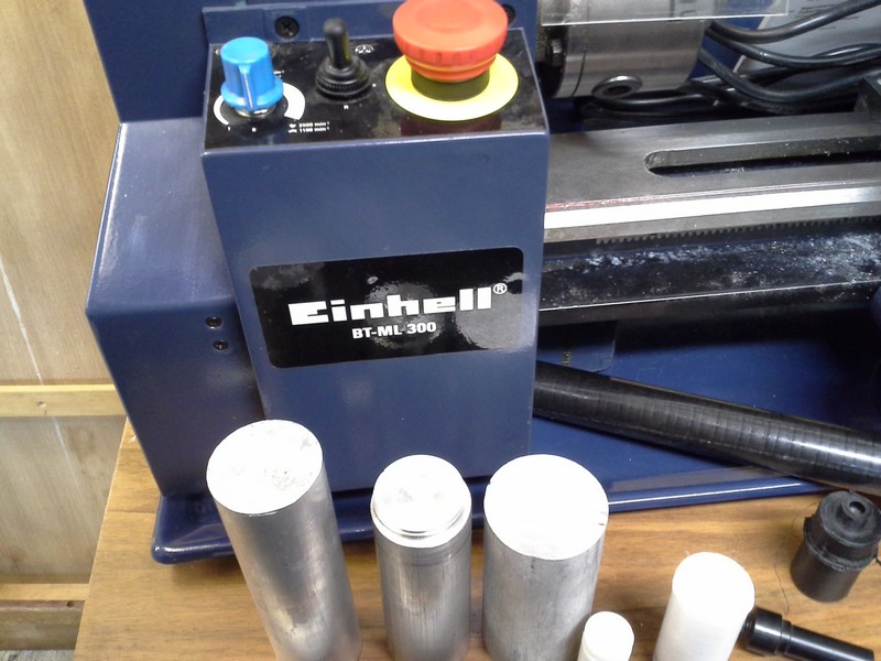

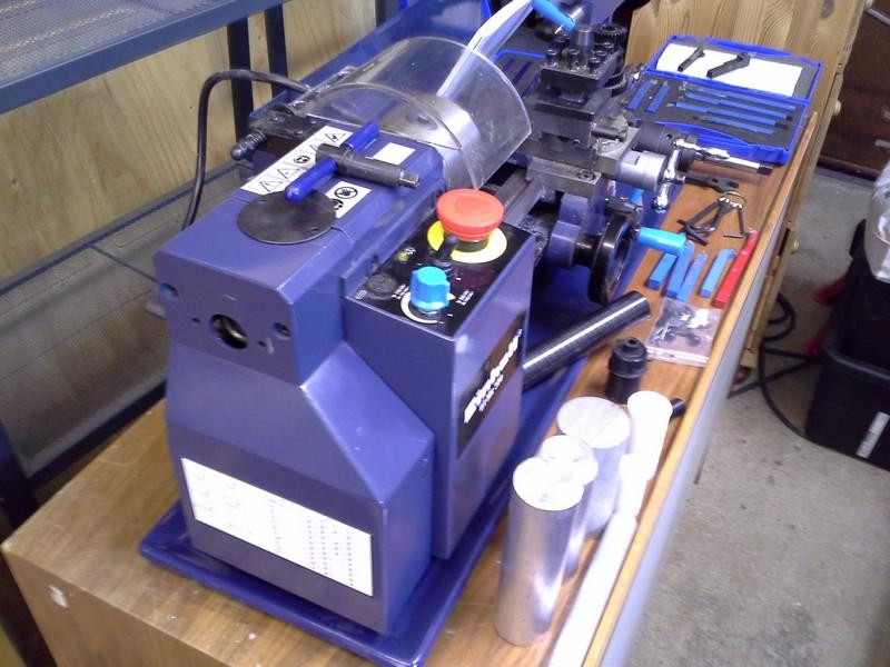

Here are some pic's; Please tell me if they are invisible!

Kjelie
Your photo's are very visable and are the perfect size for easy viewing by the forum members. Thanks for posting them. It looks like you made a nice purchase there.  :D :D

Congrats on the lathe.
What are you going to do with it? What is the first project?

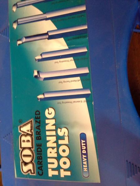

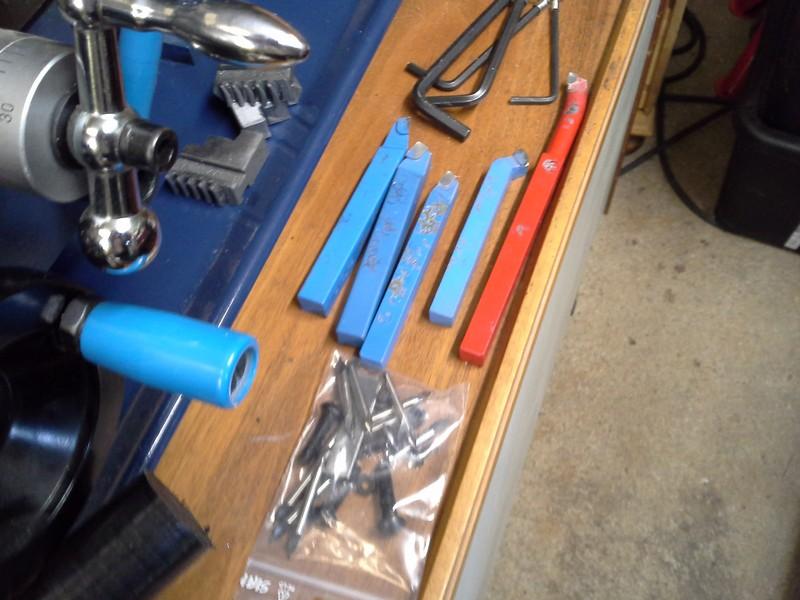

My take on the lathe tools:
* You have there aluminium and plastics (nylon/POM?) which is great for practice
* However you have brazed carbide tools which IMHO is not very ideal for anything else that breaking the skin off from cast iron....
* I never had much luck with brazed carbide, sharpening needs green grit wheels or diamond, dust is carcinogenic, not easy to really really sharp, limited rake angle (inset gets thin, brittle). Most brazed tools I have got is junk.
Can you sharpen HSS? Can you use coolant or do you want to use coolant on iron metals?
There are many opions, but I do most of my turing on my little 150 kg chinese lathe with carbide inserts, dry, and run the hell out of it, really would not mind have extra 2kW more power....HSS needs whole lot less speed and power but really needs coolat and sharpening.
What is your take?

Pekka, I plan to get some HSS and a small grinder, I've read enough about cheap brazed carbide to be wary of it... First projects are an axle for the brake pedal on my Ancillotti, and probably a fly wheel puller for the magneto/ignition on the same bike. Both involves cutting some threads, which will be a challenge! But I will practice before going "live".... After that, I don't know, a "coffee cup stirling" maybe?

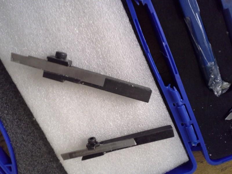

Kjelle, when you fail utterly to do any kind of parting off with those parting tools, dont beat yourself up about it.
I've tried those, and the bladeholders are made from cheese and will deform.
Congrats on the lathe though. Now you only need to get to know it.

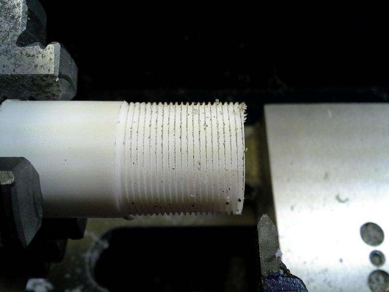

Well, today I tried something I thought would be hard... Threading. Took a while to figure out the banjo and gears, but it wasn't too hard (just bloody fiddly!), and started everything up... First I realised that the 8 mm stuff PO had bought, didn't align with the centre line, too high by 2-3 mm... So off to use the 6 mm stuff, and he probably took some very deep cuts, as they seem to be chipped... Well, I did face and square a piece of plastic, and started threading... No particular diameter, just a random piece reasonably square, but with gearing for 1 mm thread...
The tools are not in their best shape, as can be seen, but as far as I can make out, it's a 1 mm thread. Very happy bunny!! :nrocks:

Very nice! Did you found out why thread has often groove in the end?

Hi Pekka! Yes, did find that out... But I was already expecting that, lurkoing here and on other forums... Waiting for my HSS tools from ARC to arrive, so I can try some more things!

Pekka, I have just what came in those blue boxes.... Brazed carbide. I have ordered a 6 mm set from Arc, and some other stuff (63 tooth change wheel among it), and plan to learn/try some grinding (when I get a grinder). I might build a tangential toolholder, or buy some threading, insert tools if that fails... A flip up threading tool is one project I'm contemplating, after the bike parts/tools, and the list is growing!
