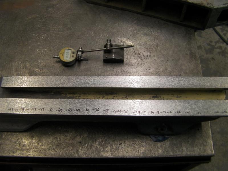

Here's the wear along the front - quite significant. Measured in tenths of a thou with zero at the far right out of shot.

Don't think it's yours I got it off a guy in Medway.
I now have the front and rear shear parallel to about four tenths. Miles better than the 6 thou it started with.
