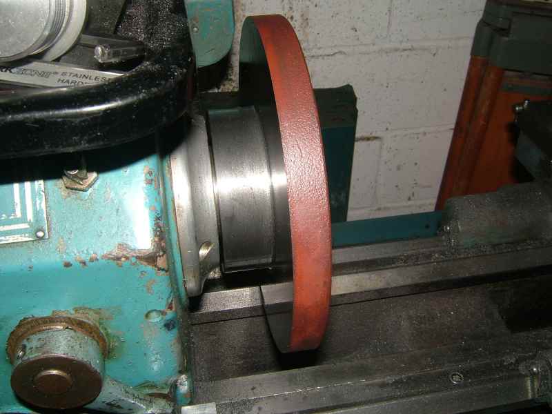

Some time ago I was given a 6 inch 4 jaw chuck.  This is a solid bodied steel chuck - no cut aways or lightening holes anywhere.
It came without a backplate and so I bought a backplate casting.  I followed the advice on lathes.co.uk on machining the thread and register and it fits nicely.  So I took it out of the 4 jaw chuck I was using to machine it.
When I mounted the new backplate I could see that the backplate was about half an inch thicker than it needs to be.  I can't machine that off the chuck side of the backplate and machining it off the headstock side would require very accurate clocking in two planes.
So, does it matter? Is it an advantage as I can get larger stock through the chuck further? What does anyone think?

Personally I like the extra length on my backplates, allows me to hold larger stock deeper in the chuck as you mention. I don't think 1/2" will make a whole lot of difference to rigidity.

When you face off the rear and front, turn the register, counter bore for fixing it wont leave a great deal.

I'm still thinking about this - although I have worked out how to hold it to machine some off the back.

Mount it on the spindle and machine o/d some where near, then machine back then front with register.
Can improvise with tooling to machine the back as there may not be clearance to head stock using a left hand tool. Or right hand tool on a rear tool post.

I decided that for this chuck I ought to reduce the overhang a bit.
I bored another register in the front of the backplate and put it on the spindle backwards.  Turned off enough to remove my first register and then bored a new one.
Put it back the right way round and started cleaning up the front.  I estimate that by the time I've skimmed the front the backplate will be about 5mm thicker than the spindle nose which is OK.

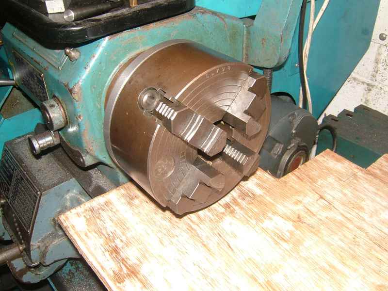

Done! :D
Now I just need to drill the mounting holes.

 Nicely done Russ  :clap:  looks good to me.....OZ.

It wasn't off ebay but it could have been.  I bought it from RDG at a show and they also sell them on ebay.
It machined fine once I'd got the speed right - I used HSS tools and they cut fine.  There was a defect in part of the threads but no worse than on some of my genuine Boxford back plates.
