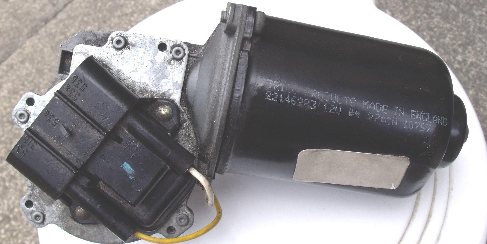

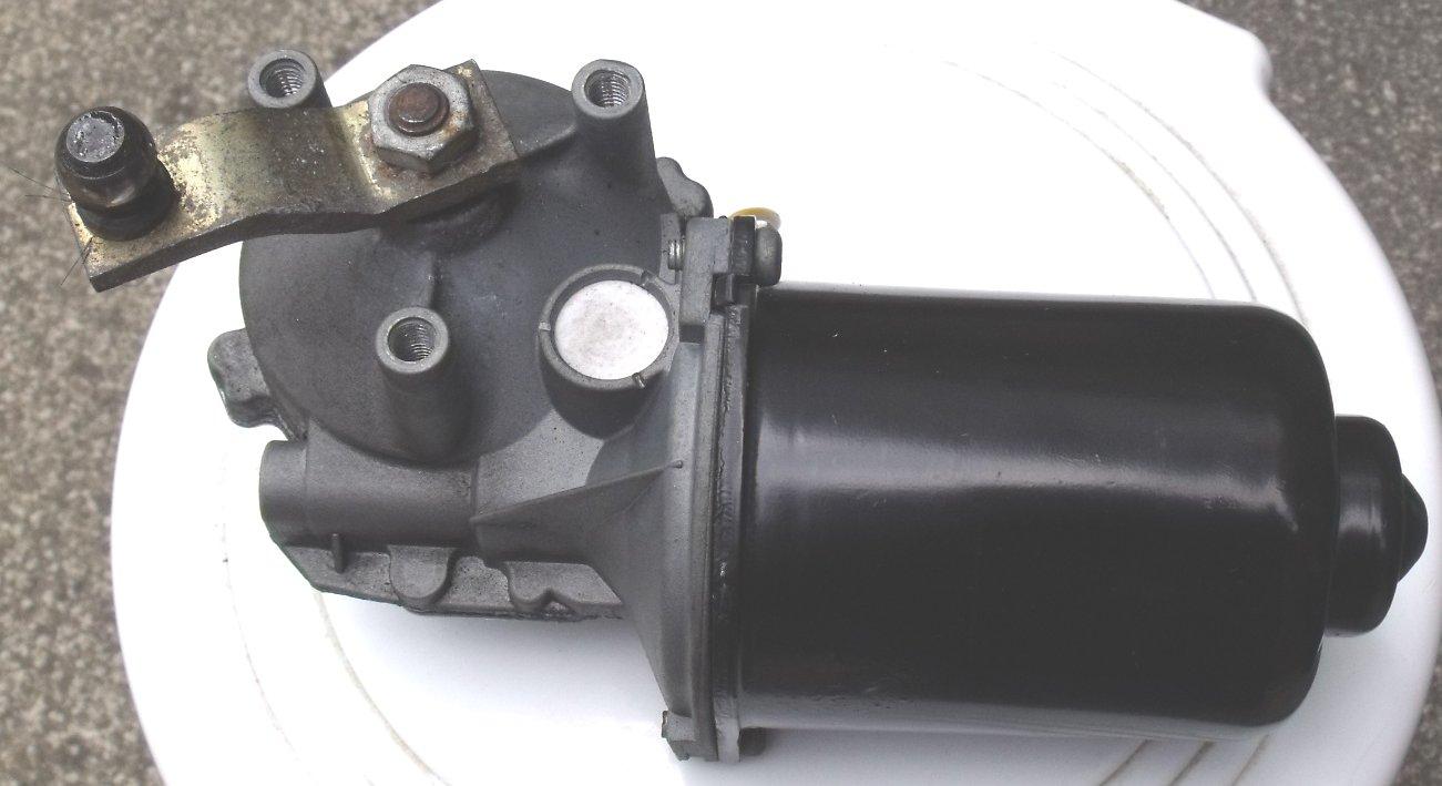

I got this from my favourite scrap yard this morning...
Here comes mill table drive MK2. :D :D :D
Best Regards:
                     Baron

Looks to be in very good nick! How much did you pay for it?
Hi,
The princely sum of £3.00p.   :nrocks:
Actually I know another scrap yard not too far away that tends to strip parts from the cars before they crush them.  This same wiper motor from them would cost me five times as much and there would be no guarantee that it even works.  Having said that if you are stuck for an exchange part it can work out a lot cheaper.
Best Regards:
                     Baron
