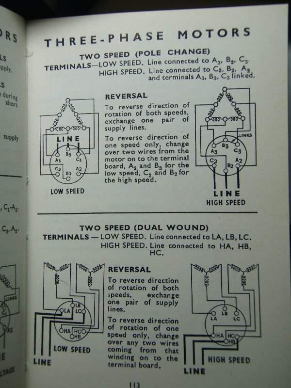

Probably six windings on Normans motor as it is dual speed
  • Posts: 1179
Re: how to check a motor
« Reply #21 on: May 22, 2014, 10:43:58 AM »
It'll probably be the pole changing type like the top diagram attached.
Offline Arbalist
  • Posts: 673
« Reply #22 on: May 22, 2014, 12:05:57 PM »
Good post Bill.  :thumbup: I've saved that picture for future reference!
