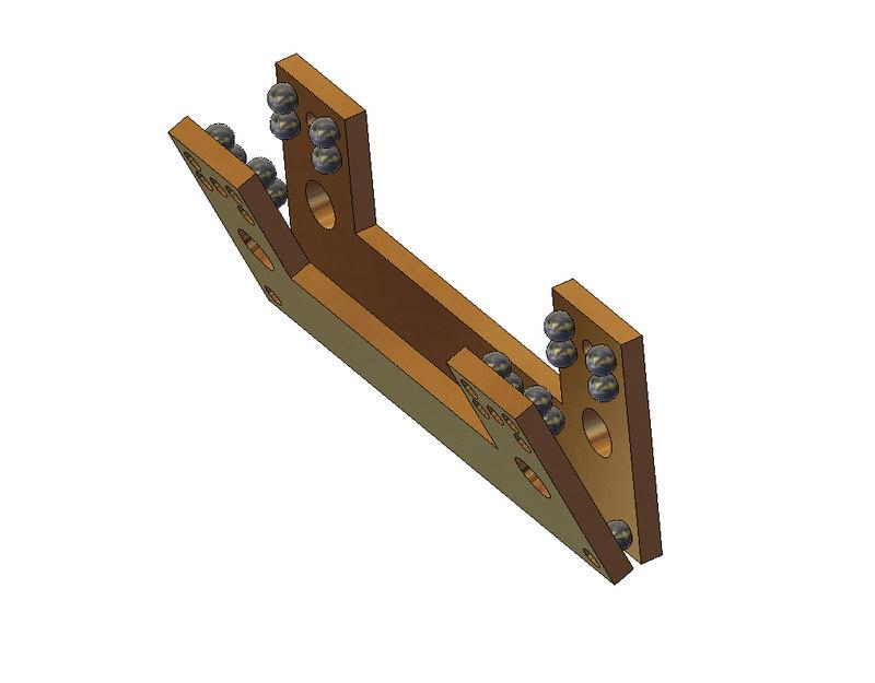

Thanks for the info so far. If a bar running in v grooves is used for the hinge, I dont see how the assembly is held together, I.e force at the bottom on the bar.
  • Posts: 1225
it'll stay together if the force is between the hinge and the adjuster i.e. it is pulling both together.
if groove cutting  is a problem then drill holesand balls would work (I'll try to draw it for you later)

That would be more Vert-Mill friendly than long bored holes. I tend to still think boring because that's how my homemade lathe came together, long before I had a vertical mill. But V-grooving everything makes a lot of sense. You can do all the main body grooves without shifting the part in the clamping setup, which makes them all parallel. Good way to do it!
  • Posts: 1225
grooveless version 1
5mm balls sitting in 4mm reamed holes
I made one out of several 4" brass hinges , knocked the pin from two and rivited them together then reamed for the pins and cut out the centre , stil got it somewhare .

BillTodd - I really really like the ball bearing suggestion! I know I'm being thick but I'm still not clear how they would be held and forced together. Obviously some have the obvious spring on the side bar I mentioned in my first post but I can't see how the others are spring closed without this.  I understand the adjuster is putting pressure on the hinge, bar, ball bearings but what is holding them from just falling apart.  Bill - also, why 4 bearings in each top corner?
This method would stop me needing to machine a parallel v groove for the bar hinge, I'd still need to machine, either mill a groove or bore a long parallel hole along each top side for the runners right.
The length of the depthing tool will be about 170mm long... That's a long way to bore two holes!!  :bang:
  • Posts: 1225
Re: Gear Depthing Tool Plans- ideas, suggestions, plans, machining order
« Reply #11 on: May 29, 2014, 08:27:03 AM »

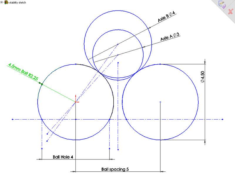

Well this is what I had in mind...
the balls would be a right PITA if not glued in position and the adjuster, as draw, is somewhat sub-optimal (i.e. a bodge)
balls are 4.5mm in 4mm holes. If the holes are drilled and reamed with the two plates clamped together the hole positions will align perfectly.  All you need to do is drill them in the correct places.

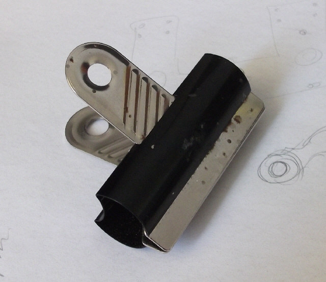

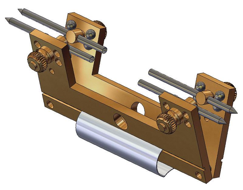

This version uses a spring from a cheap bull-dog clip
  • Posts: 2914
« Reply #14 on: May 29, 2014, 12:53:04 PM »
Bill that really is genius.
So you'd drill all holes with the two frames pinned together. Providing the two frames were set horizontal on the mill, I'm guessing it would ensure the runners are parallel.
Chris
  • Posts: 1225
« Reply #15 on: May 29, 2014, 01:14:53 PM »
actually it does not matter if the frames are slightly off. as long as alll the holes are drilled one row (x axis) at a time the thing should be accurate :)

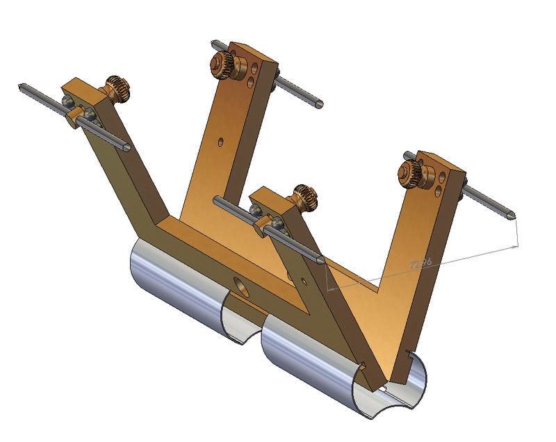

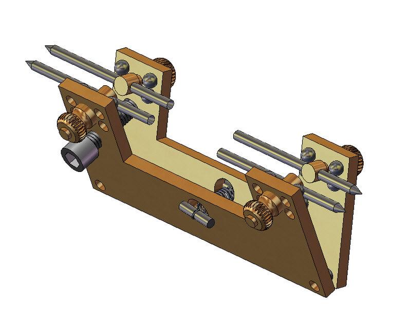

BillTodd, have you by any chance dimensional drawings for that? It looks very much in proportion and would give me a scale to work from.
The next question is brass, steel or aluminium? - brass looks the part but is pricy.
I wonder now if it would be nicer if the depth adjusting screw was now placed more centrally, in the position of the old spring hole perhaps.
Also, I'm just wondering if it would be better to slightly oversize the holes in the runner threaded rods. My thoughts were getting onto reaming these accurate but actually, there job is only to pull the runners against the bearings so having the hole larger would I expect be better, allowing the runner to find its true seat.
Also,could the balls be soldered in position or is this likely to push them out of position slightly with the solder running below them. I would have thought that there wouldn't be a right lot for the glue to stick to.
« Last Edit: May 29, 2014, 05:23:55 PM by raynerd »
  • Posts: 1225
« Reply #18 on: May 29, 2014, 05:33:44 PM »
I can make it any size you want :) ATM it's plates are 100mm wide, throat 80mm x 40 ish  The spring clip is 50mm long
Aluminium might be a bit soft (you don't want the balls digging in too much)
Stainless (say 3-4mm think) would be good
Brass 3/16" - 1/4" would be fancy (and should always be quoted in imperial units! LOL)
Yes. it needs a a rotating/hinging mechanism (left & right thread with thumb wheel in the middle?)
Absolutely right :)   I need to check that the guide ball spacing is OK and that it wont just ping the balls out when tightened
Also,could the balls be soldered in position...
Why not. Clamp and solder from the hole side should keep any lifting to a minimum.

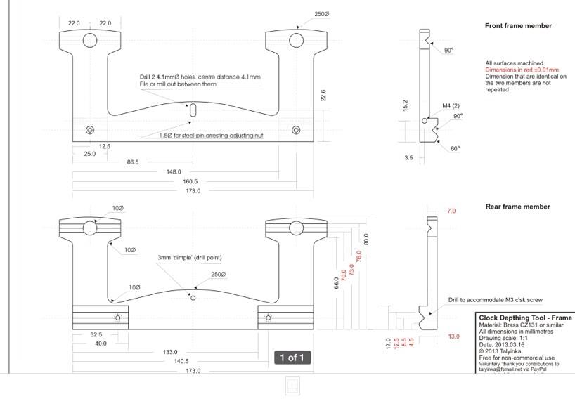

I've attached some plans that were freely available at some point on nawcc forum. The shape and dimensions on here look good.
Chris

The 80mm called for would be best reducing to 3" - 76mm so it can be cut from more freely available 3" bar stock,
  • Posts: 1225
« Reply #21 on: May 30, 2014, 05:51:26 AM »
 cut longways?   or are you thinking a C shaped version?

Hi Bill
I can get bar stock that is 1/4" thick by 3" wide. That means I can use cz121 (?) extruded bar rather than 1/4" brass plate which would be much more expensive!
http://www.ebay.co.uk/itm/like/400441260894?limghlpsr=true&hlpv=2&ops=true&viphx=1&hlpht=true&lpid=108&device=t&adtype=pla&crdt=0&ff3=1&ff11=ICEP3.0.0&ff12=67&ff13=80&ff14=108
Or if that doesn't work, item 400441260894 on ebay
Chris

I have purchased the brass needed for the depthing tool today - 1/4". Would two large bulldog clips be more suitable?
Could you just explain your thoughts on bearing size for the pivot/hinge? You mentioned 4.5mm in a 4mm reamed hole. You also mentioned that slightly larger may be better for the hinge - why? And what size - 5mm, 6mm?
Chris

So why can't the hinge part of this just be a piano hinge all it does is open up.? The acuracy to me would be in the shaft suports and if there is enough room to drill and ream for the spring tension in the shaft to hold the gears.
  • Posts: 1225
« Reply #27 on: May 30, 2014, 03:54:44 PM »
It can be any kind of hinge as long as it is parallel to the axles - it is ensuring the alignment of all the parts that is critical.

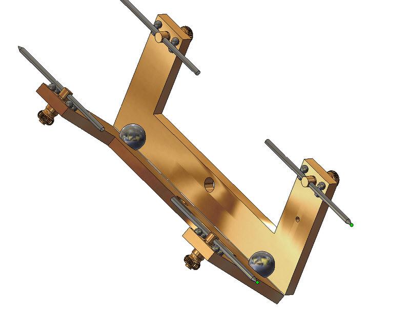

Bill - did you see my earlier messages regarding ball bearing size?
I have brass and 15 of each, 4.5.  5.  6 mm ball bearings
Also, do you think a 1.5" frame all arounds sounds ok? I'd still appreciate any dimensions of your drawing if you have any.
  • Posts: 1225
« Reply #29 on: May 30, 2014, 04:05:33 PM »
Yes, the bigger the hinge balls the larger the opening (although this also requires a bigger diameter spring)
ATM I am experimenting with a 15mm ball. This gives it a 66mm axle spacing (not much point in holding one large gear only)
I've been looking around at bull dog clips the largest standard type clip (70mm wide) has a maximum throat of 17mm (the spring would probably open to 20+), which is a bit too small even with small ball hinges.
Anyone know of a source of larger springs?
This design is 3" x 170mm the arms and base are 25mm wide
  • Posts: 2914

Bill,
Would the 15mm bearings still sit in a 4mm hole, i.e could you drill out and experiment wit appropriate sizes?
  • Posts: 1225

« Reply #31 on: May 30, 2014, 05:03:51 PM »
Bill,
No it sits in a 12mm hole.
hmmm it's just occured to me, what is the minimum axle spacing?   putting the axles on the outside of the plates may give some useful extra room:D

  • Posts: 1225
« Reply #34 on: May 30, 2014, 06:21:00 PM »
Why not make it so that the pins can go either side of the frames?
Yes there is no reason why you could not attach the balls to both side of the plate :)
This one uses 6mm hinge balls in 5mm holes with 70mm bull-dog clip springs

Bill - what opening does that give?
Thinking about it, the opening would have to be larger than the maximum wheel diameter radius. Otherwise, the depth would allow you to fit the wheel on but if you couldnt space it to the radius, you could not mesh it with a pinion.
  • Posts: 1225
« Reply #37 on: June 01, 2014, 05:14:06 AM »
it opens to about 73mm
it is impossible to design a ball in hole type hinge that will open beyond 60° , so to get a larger opening requires a  spacer (e.g. a big ball) or longer arms.
if you need a greater angle then it a will require an enclosed hinge.

Offline PeterE
  • Posts: 458
  • Gothenburg
« Reply #39 on: June 02, 2014, 04:50:16 PM »
Hmmmm, felt like I kind of stalled the discussion. Too bad and not my meaning. To try to illustrate what I was after, I quickly made a 2D sketch.
http://i577.photobucket.com/albums/ss219/H0n3/Tooling/GearDepthingToolSketch-01.pngGear Depthing Tool Plans- ideas, suggestions, plans, machining order
It is based not on a ruler but on two bars, say about 6 mm dia and some various sized brass blocks about 25 mm high and 10 mm thick. Should be sturdy enough. Thickness probably OK if 8 mm.
The two end pieces are pinned to limit the risk for twisting. At the right end the end block is wider and carries one of the depthing pegs. The other larger block slides sweetly on the bars without any slop at all. This block carries the other depthing peg.
To achieve a micrometer adjustment, the smaller moving block to the left of the left peg block, has a locked in thumb screw working into a thread in the adjacent peg block. With a spring between them it will be easy to adjust minutely the gear centres.
Locking the depthing pegs is done like a height gauge and locking the peg block and adjustment block is done using a cross "bar" nipping the slide rods like the arm locks on a GHT pillar tool.
This would be easy to make and if the rod holes are drilled and reamed before parting the brass bit, the distances will be exact. Probably simple to make as well.
BR

Offline PeterE
  • Posts: 458
  • Gothenburg
« Reply #41 on: June 02, 2014, 05:08:49 PM »
I thought that the depthing pegs shall allow to insert a 2mm? gear axle at the top to fit the gears on, and then when marking exchange the 2mm pins for a piece of say 5/2 mm extension piece to tap upon.
Much like the image on page 1 of this thread where the depthing pegs goes bweteen the "bars" 90 degrees compared with my sketch.
/Peter

  • Posts: 1225
« Reply #43 on: June 02, 2014, 05:29:04 PM »
Chris here's a drawing of the plate. There's nothing critical except the spacing of the axle holder balls which are for a 3mm 0r 4mm axle (is that large enough?)
BTW the max opening is 83mm not 73 as previously stated.

Are they bulldog clip springs???  :dremel:
Don't know about you but looks homemade! Could be a clog mile out.
Bill, I'm not going to lie. Since having this discussion I have actually got my hands on some original Malcolm Wild depthing tool castings. However, I promise you I'm so excited about the ball bearing idea that I'm going to attempt making that as my first project when my workshop is setup!!
  • Posts: 1225
« Reply #55 on: June 17, 2014, 06:33:53 PM »
they certainly look like them :)

Offline IACooper
  • Posts: 2
« Reply #68 on: April 04, 2026, 02:43:46 PM »
Sorry for well and truly raising a thread from the dead - but at least it's the right time of year for such things!
Having need for a depthing tool and liking the simplicity of this design, I decided to have a go myself.  In the absence of detailed drawings I've needed to sketch it out myself, hence the reason for necro-posting to add some dimensioned drawings should anyone in the future have a similar need and come across this thread.
I went with 4.5mm balls in 4mm reamed holes (no countersinks or chamfers!)  with 6mm balls in 5mm holes for the hinges.   I also roughly cut out the 'C' shape of the frames first to let any stresses and distortion out of the metal, then machined to shape and again unclamped to let it relax before then drilling and reaming all the holes as the last step so they should all remain true to each other.
The adjustment has a half-round 'nut' which sits in a similar half-round groove on the inside of the one plate, with the end running in a short vertical half-round groove on the opposite side:
If I wasn't too careful slackening off the adjusters the flippin' balls would drop off their seats.  I fixed this by fully cleaning all the parts then assembling and clamping the runners in position before using a wooden stick to add a small drop of cyanoacrylate glue down the hole behind.  The ball is blocking the hole and is held in position by the runner, so the glue is just going to tack them in position without the risk of preventing them sitting down accurately into position.
I haven't tried it in anger yet, but just setting the arbors together for this photo seems to suggest it's going to do the job for me just fine.
Ian.
  • Posts: 6941
« Reply #69 on: April 04, 2026, 03:46:54 PM »
Thanks Ian. That's a beautiful tool, and photos as well.  :beer:
And especially for contributing a drawing!
  • Posts: 1225
« Reply #70 on: April 05, 2026, 11:14:30 AM »
Nicely made tool.
I always felt the design was overly dependent on the edges of the holes , and perhaps I should have thought of something more robust.
Looks good though  :D
Offline IACooper
  • Posts: 2
« Reply #71 on: April 05, 2026, 01:52:01 PM »
Thank you.
I agree the sharp edge and narrow contact area for the balls is a potential concern for future wear.  For the time being I'm just being careful not to wind them up with a torque wrench, just nip them.  I suppose the cyanoacrylate will help spread the load a little as well.   Another approach I've seen is to have a machined 'V' groove to locate and align the runners.
Having spent the afternoon depthing and measuring, it seems to have done the job.  To fit the barrel arbor I made a couple of press on adapters with larger coned sockets.  These are partially reamed 4mm but left the taper lead in of the reamer at the end so they wedge onto the end of the runner and thus saved me having to make an extra pair of runners with larger sockets.
Ian
