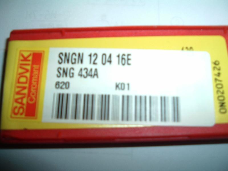

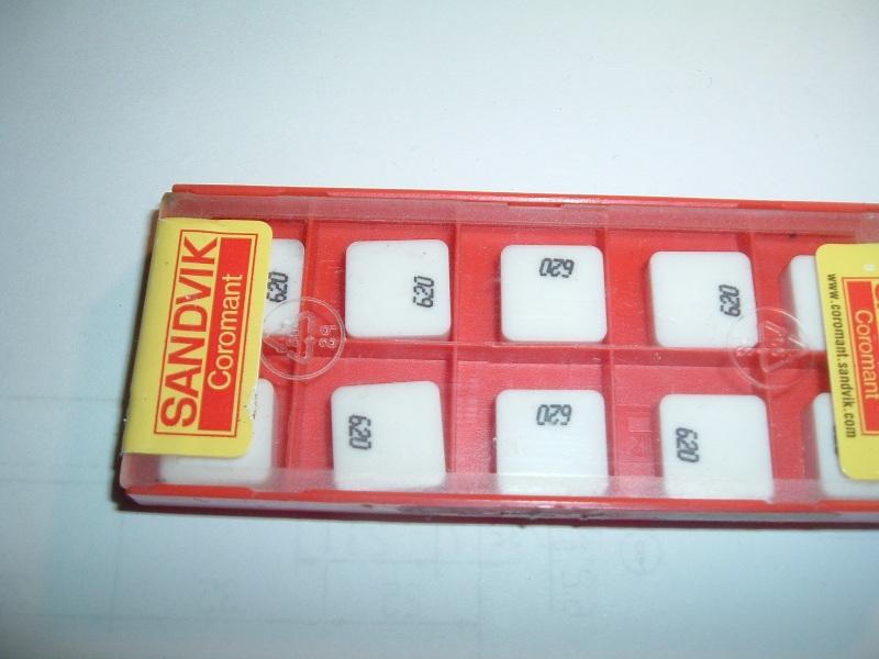

 I was gifted with 2 packs of Sandvic Coromant inserts. The gifter swears they work miracles on hard steel. I did not get the tool holder or clamp for these inserts. The inserts are marked SNGN 12 04, 16ESNG 434A, and 620.
I have researched these inserts and found lots of info on metals they will work on, speeds and feeds, but cannot find an insert holder for them.
Can someone with knowledge of these inserts please explain how to find the insert holder and clams for these inserts? If I can get the proper clamps and spec for the tool holder, I think it’s within my capabilities to make the tool holder.

Ceramic inserts. They need pretty big and stiff machine + very hard shim under or they'll crumble.
You are probably looking for CSYNR-L tool holder?
Something like this:
http://www.turning-tools.com/csynr-l-tool-holder-for-sngn-and-sngx-ceramic-inserts
You probably have the dimensions of the insert?

with square sided inserts, I would just use about 5° front and sideclearance by milling the holder at the two angles (let the top rake be set by the insert.
I would set the tool at an angle, in a small tool-maker's vice then grip that vice at an angle in the milling vice.
As Pekka says, you'll need to support the whole under side of those inserts if they are not to fracture.

oh and either floodcool or no cooling at all . squirting coolant ono a hot insert can crack them.
