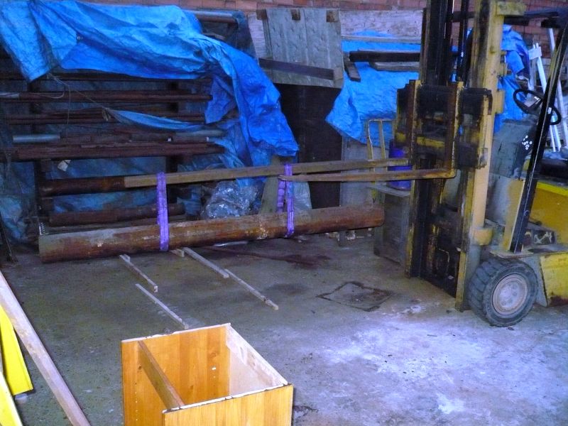

Don't know the price of the steel as I had an eight foot long left over of 6" from a few years ago when steel as a damn sight cheaper that it is now.
Bit heavy thought  :bugeye:
Don't think your lathe will be big enough, Mine is 14 x 40 and it's not gripping on much with the jaws right out.

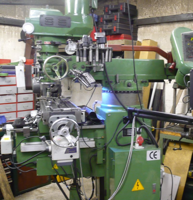

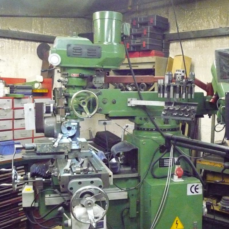

Just put a spacer block on the Bligeport [ Taiwanese clone ] It's the same as a Bridgy one, in fact it came off my old Bridgy and before that it was resting in Mr Mawson's emporium of slightly soiled goods. I did have to have the register skimmed by about a mill as it wouldn't quite fit.
Only problem now is I used to have a small pallet to stand on to swap tools, now It need two.
Pre the riser block.
Post riser block. Incidentally if you wind the ram forward as far as it will go and bolt a hollow box table to the mill table and then to the ram, once the 4 bolts are removed the kneee is more than capable of lifting the head and ram so you can slide the spacer in.
Bit this on the old bridgy and also did it on this one which is actually bigger than a bridgy in size and weight and this also has a slotting head on the back end.
Thanks again for the faceplate trick, that will speed things up no end but safely.
