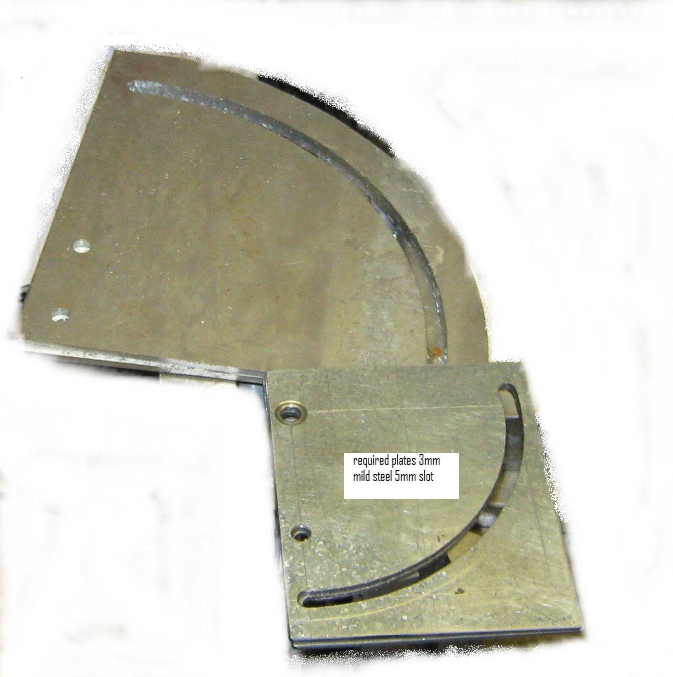

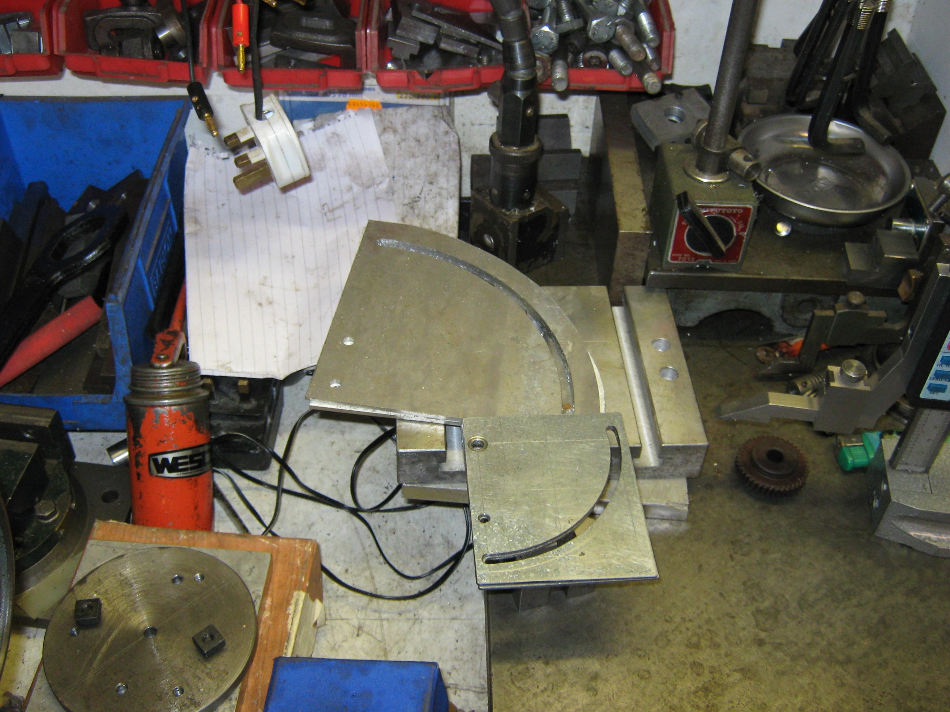

my problem is i wanted to make a couple of 90 degree plates to angle a table for a sander and also make an adjustable angle plate for use on the mill whilst i managed to make said plates using a couple of cheap rotary tables i also managed to bugger up the gears in the rotary tables
question is should i have disconnected the gears and moved the tables manually i think i probably should have but my understanding was i would be able to just mount the plates set them up and mill the angles required
the material was used was only 3mm mild steel plate for one and the other was 4mm aluminium the slots were only 5mm and 6mm hardly heavy graft the mill is a raglan the tables were bolted down and sacrificial plates were used under the plates
i'm more annoyed at the rotary tables being buggered up
and before anyone suggests i just make new gears like i said i am a crap engineer who can't even screw cut properly
sorry to be so long winded about this but any help or advice would be appreciated i look at all the things and projects everone else submits with a high degree of envy thanks in advance

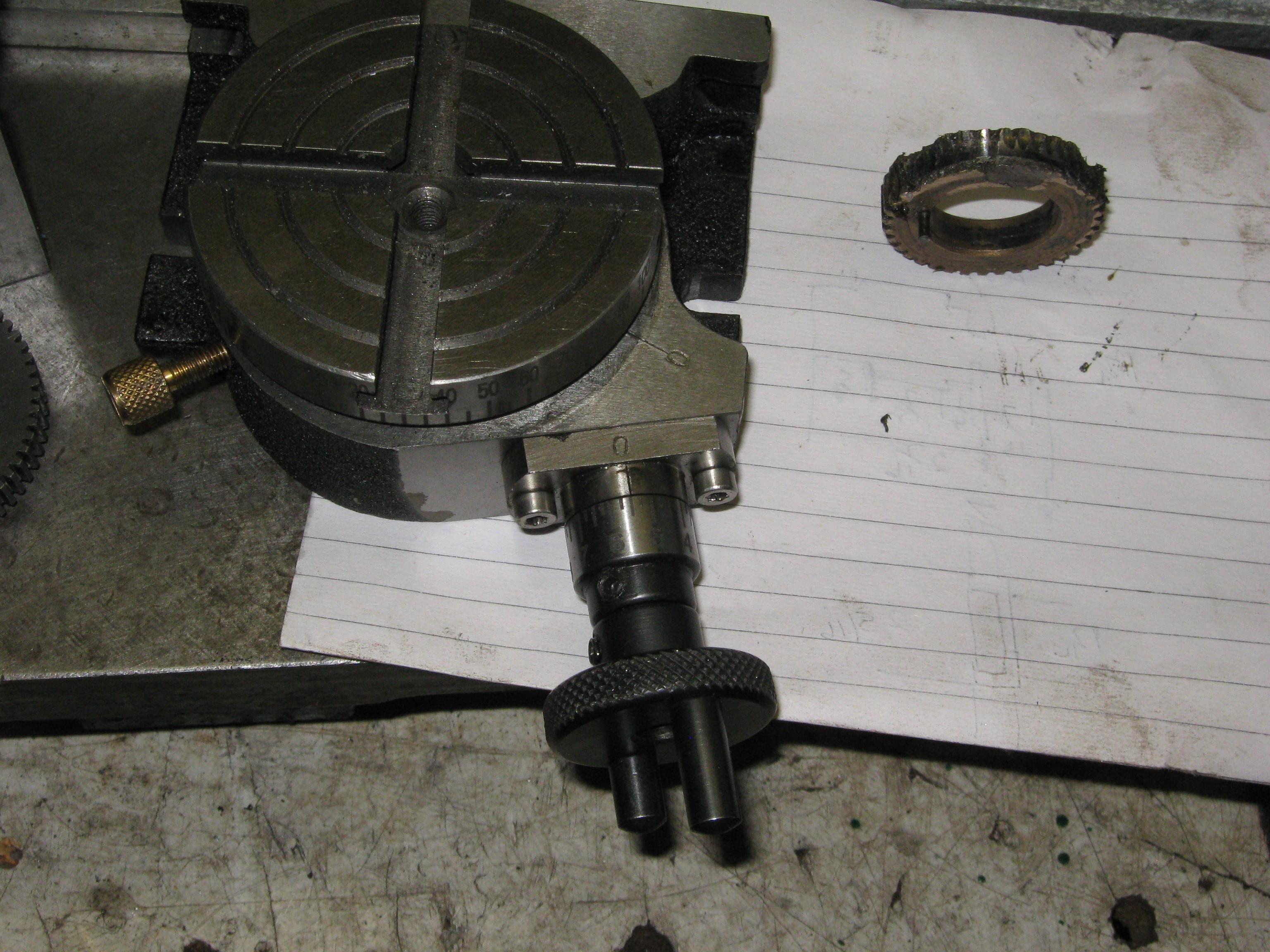

Did you release the lock on the RT , and is there adjustment to push the worm into the wheel ?

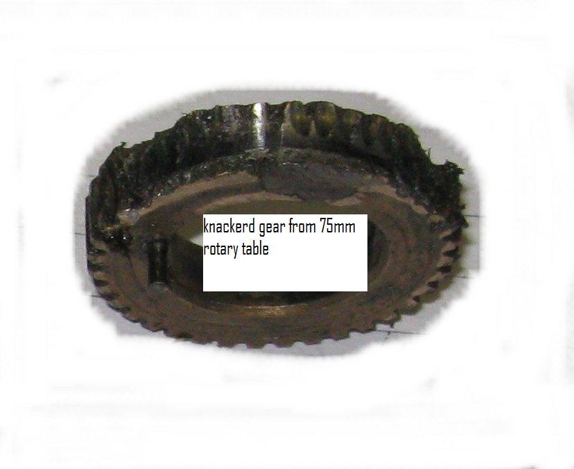

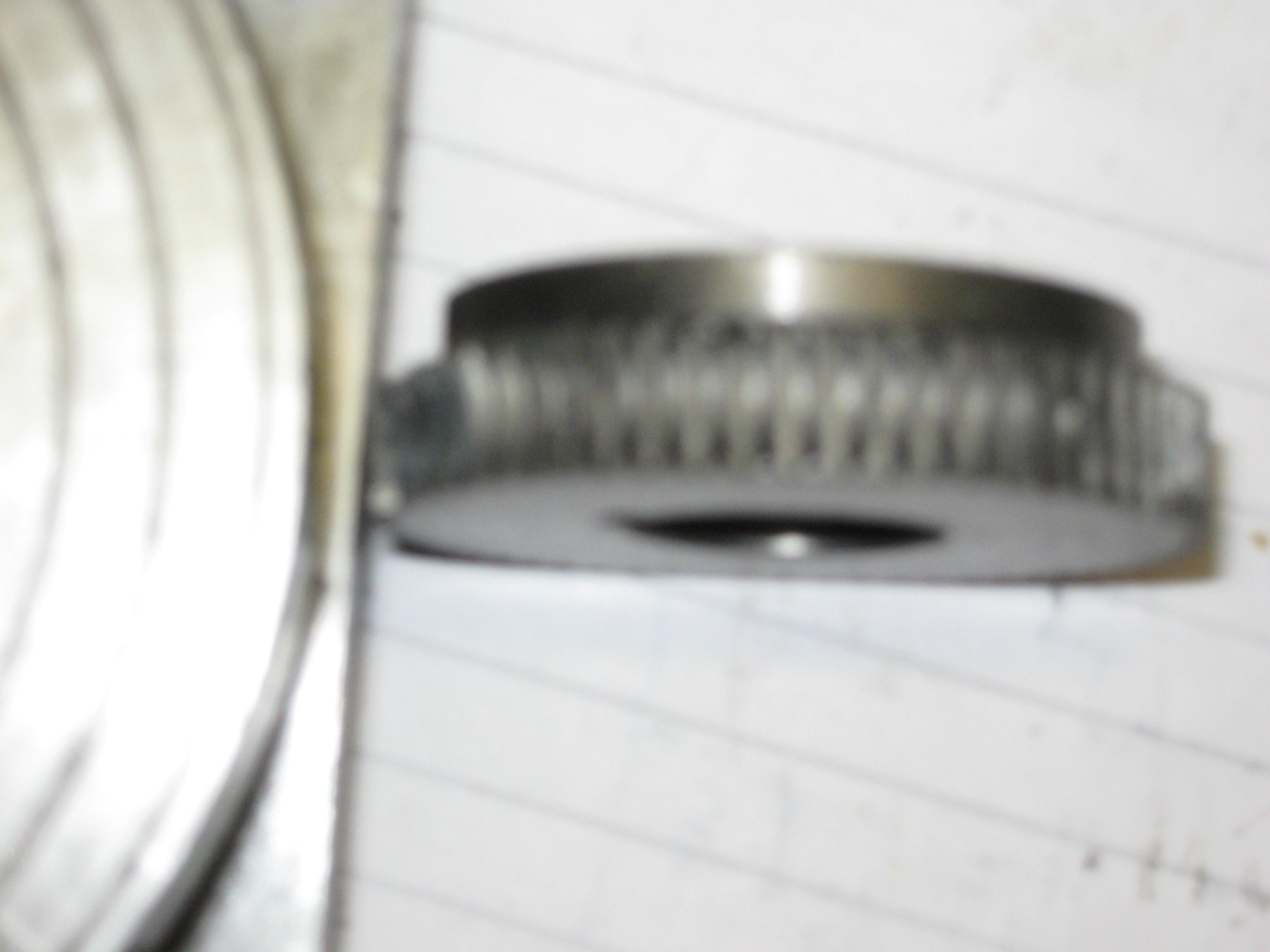

sorry i was not thinking straight at the time i will try and enclose the pictures again but photo manipulation is not my strong point and i don't know how to resize the photos to 800 pixels
the photos of the plates are what i was trying to achieve and did at an obvious cost to the rotary tables
in my lack of knowledge i thought to create the plates all i had to do was centre the tables bolt down the plates to the tables and cut the grooves in them using the rotary tables the first set were doubled up the material was 3mm mild steel the cutter was 5mm and brand new the mill is a raglan and the speed was about 300rpm cuts were very light about 5-10 thou some cutting oil was used no support was used between the tabe and the plates i realise now i should have fixed  the plates  better but again lack of knowledge   i just did not know any better i also realise now that what i was doing was wrong
ie i was winding the table both ways ie climb milling and conventional milling obviously not a smart thing to do which probably caused the destruction of the table gear the rotary table used was a 75mm table i also realise now that i should have removed the worm assembly and manually moved the rotary table but did not realise the damage i was about to cause or i would not have done it once again lack of knowledge i am not an engineer i am more electrical biased but like engineering i have lots of tooling and its cost me a lot of money no wonder i hear you say the way i destroy rotary tables but i am getting tired now so will continue this saga tomorrow

I have a HV6 (150 mm) rotab. I routinely use it for "circular milling" and rounding off. Pretty soon when I got it, I disassembled and cleaned it (least twice). I had some crud inside and needed some fitting. These rotabs are not really as strong as old properly build ones. It's very importat to get tooth contact close to correct, but it's almost impossible to get it very good, because build quality is not that great.
I have done 60 mm dia hole in 30 mm thick aluminium plate using 10 mm slot drill. Doing was pretty slow but not extremely slow.
http://madmodder.net/index.php/topic,5041.0.html
I tried to mill teeths of welded chanin sprocet wheel....something like 30mm thick and 170 mm diameter and that was not happy going even when rotab was locked.
How did it fail? Did something crab the the mill and rotab failed catastrophically? Or did it disintegrated gradually while you we cranking it?

                  1. Using the rotary table :  Do not use this device unless the worm and wheel are fully engaged, lubricated and running freely.   Never use manually with the table disengaged.   Never climb mill.  Always positively support the workpiece, and securely clamp it.  I use a 10 inch dia. piece of 3/4 inch plywood made from hard wood, bolted to the table, when cutting circular slots as you describe.
                  2.  Cutting Speeds for Milling Cutters :  The cutting speed for mild steel for a cutter the size used 5mm should be at least 1000rpm and for aluminium much faster than that.  Before carrying out any more machining operations you must aquire  more basic knowledge, you could have a serious accident.  Here is a website on  Milling : Cutting Speeds and RPM Calculations, which in your case is a must read.  its.foxvalleytech.com___ Download and keep for reference.
                  3.  Cutting Fluids : Different material require different cutting fluids, and some none at all.  Aluminium requires WD40 or parrafin, to avoid aluminium building up on the cutting edge of the milling cutter.
                  4. Cutting Feeds :  Feeds depend on the material being cut (cutting speeds) and the number of teeth on the cutter, the more teeth the cutter has the faster the feed can be.
                   I believe the teeth on you worm wheel sheared due to build up of pressure due to a combination of problems, referred to in the incorrect uses of the items as detailed above.

i decided to make a bigger set of plates with my other r/t which was a kit purchased a while back it had a steel /cast gear which i thought would be stronger and be able to handle the pressures better but that was not to be
this time i used a piece of hard wood between the table and the work fixing them securely
this time i used aluminium plates and again worked but at a cost ie the gear was destroyed but since then have as was suggested by pekka i then converted the table to be used  without the worm drive i can use a tommy bar
