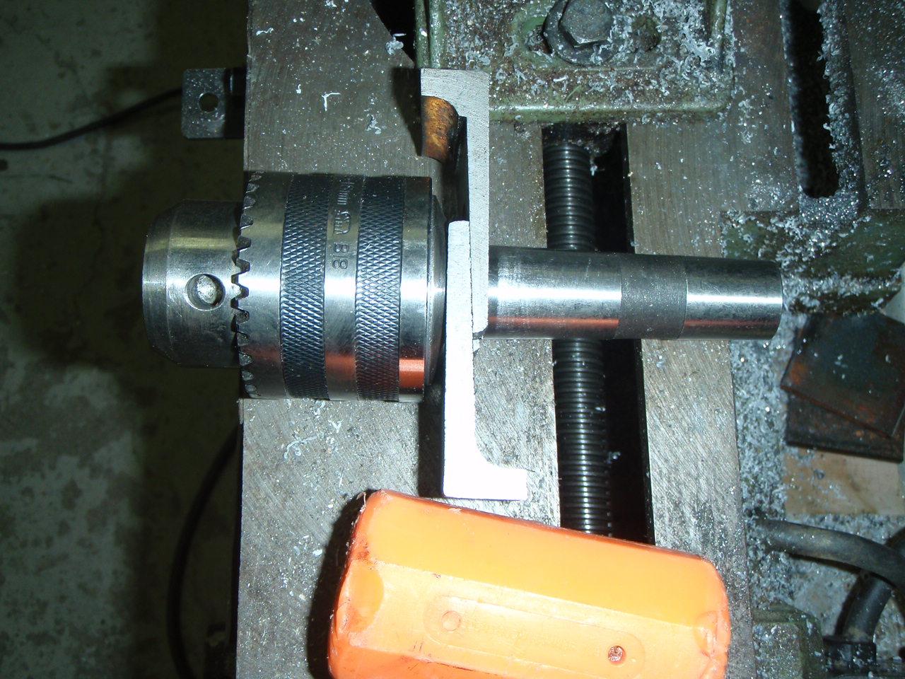

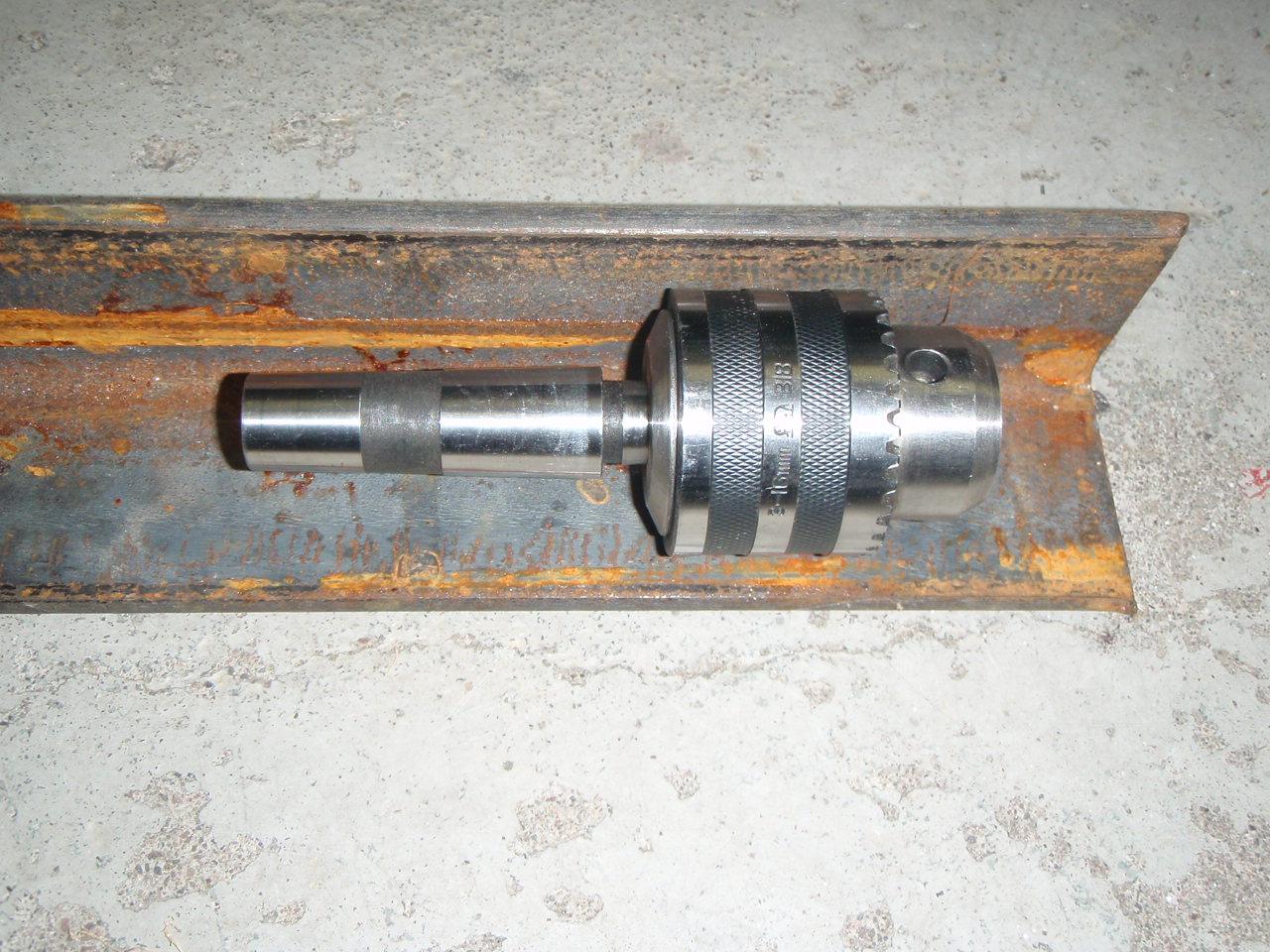

Every now and then I see someone asking advice on stuck chuck. Being avid MT user I though I'm already old hand and stuff does not stop me right on track anymore.....you saw it coming.
I have 3-16 mm drill chuck in B16/MT3 arbor that has M12 thread.

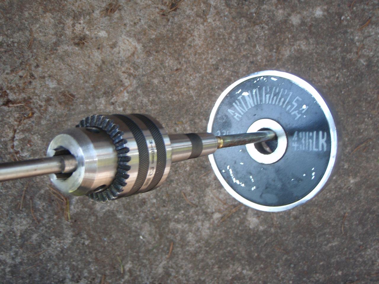

Usually I use a slide hammer on M12 thread and a bar chucked into the chuck. Few blows and no drama. I had lend slide hammer to my brother and right now he is away. I tried to use 200mm long  bolt, but it just did not have enough impact.
How about freezing and heating? Chuck it into freezer for half a day and then applied hot air gun into chuck + makeshift impact hammer. No progress.
I had to make wedges. Two hours in total, I had to cleanup etc. After fitting wedges , short application of freeze spray into arbor and two exploratory thumps with a mallet separated them.
Phew.

Here is pictures of before and after
