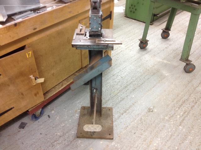

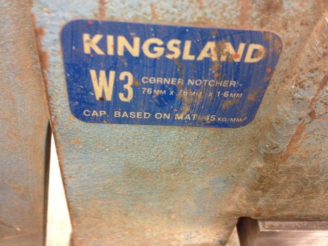

« on: April 29, 2014, 12:14:39 PM »
A recent addition to my sheet metal working kit is this Kingsland W3 Corner Notcher, reputedly able to cut a corner notch of 75 mm x 75 mm from 1.6 mm plate.
It would be extremely usful if it did what is says on the tin, but it doesn't  :bang:

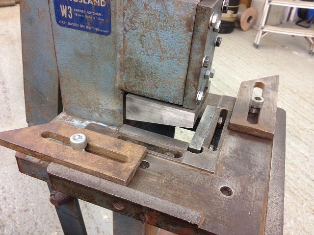

This is potentially very useful when folding up trays and boxes.
The massive 75 mm square punch is foot driven and arranged by having the cutting face tilted, so that a progressive cut is made. First contact is at the rear, with the shear action progressing forwards to the corner, then from left to right across the other face of the corner.
Now the punch was pretty blunt and someone looked to have titivated it with an angle grinder  :bang: However I brought it down parallel to what looks to be the original face giving clean cutting edges. As the face tilts in two directions but is a plane, it was a tricky bit of setting up.
It now cuts very happily on its first fore & aft edge, but with the 1.5 mm plate I've been using it is virtually impossible to progress the cut on the side to side direction.

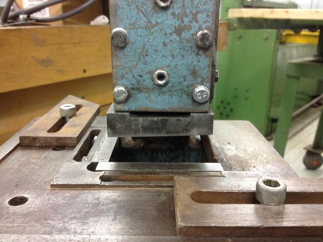

Now if you look at the two sides of the cutter block, they have markedly differing angles to them.
Re: Corner Notcher Mystery
« Reply #2 on: April 29, 2014, 12:29:15 PM »
Now the fore & aft cutter changes in height by 11 mm in its 75 mm length, whereas the side to side one only changes by about 2.5 mm
Surely this cannot be correct  :scratch: :scratch: :scratch:
Anyone with experience of these things, or has one who can make comparative measurements for me?
I have a feeling I may need to dig out some of my hoard of O1 tool steel blanks and make one with equal angles, but it's a bit of a bind to have to go to that trouble

« Reply #3 on: April 29, 2014, 12:59:59 PM »
What do the other two edges look like?
Is it possible that the cutter could be mounted in the wrong position?

« Reply #4 on: April 29, 2014, 01:05:21 PM »
I was just about to suggest it was in the wrong way, I havent ever used a non hydraulic one but the ones i have used (as far as i can remember) tend to have the leading point pressing out the center first. I believe this would stop the tendency for the cut to push the work away from the stops.

« Reply #11 on: May 03, 2014, 04:55:18 AM »
It would suggest the shear force starts at the rear left of the blade & progresses toward the centre point where the second shear force on the front takes over from the side hence giving you only one blade edge shear action at any one time, the stops would prevent the plate from moving either way, imagine trying to cut initially from the centre point on two sides, the amount of shear force required would be enormous  :scratch:   :smart:,  that's my 2 penn'orth anyway.

« Reply #13 on: May 03, 2014, 11:35:06 AM »
This link has some pictures of another one.
http://www.cottandco.com/lots/kingsland-w3-corner-notcher---1
This one looks right to me, cutting the corner first as Shipto says. I think the reason they are at different angles is to reduce the pressure required (as they are cutting at different rates) to complete the cut. I think yours is just fitted the wrong way round awemawson.
Making a new one with both angles the same is unlikely to improve things.
