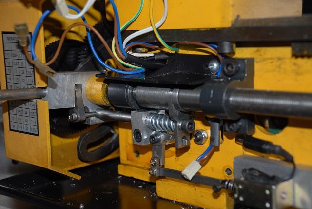

Offline drmico60
  • Posts: 69
    • mikesworkshop
Re: mini-lathe leadscrew clutch?
« Reply #7 on: April 26, 2014, 10:39:34 AM »
Hi Metal Muncher,

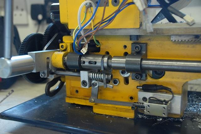

I have redesigned the change gear bracket and replaced this with a more conventional banjo, see http://mikesworkshop.weebly.com/new-threading-banjo.html
This new banjo can be easily swung away from the drive gear and this enable the leadscrew handwheel to be turned easily even with the change gears mounted.
I have taken this concept a step further and fitted a separate variable speed leadscrew motor to the lathe, see
http://mikesworkshop.weebly.com/leadscrew-motor.html
The banjo can be swung between the lathe spindle gear (for gear cutting and fine feed) to the variable speed leadscrew motor (for variable speed leadscrew feed). In between these two position the banjo does not engage with either and the handwheel can be used.

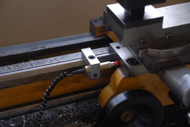

I also have an autostop coupled to the variable speed motor for cutting to shoulders, see:
http://mikesworkshop.weebly.com/autostop.html
The autostop can also control the main lathe motor for high speed gear cutting, see:
http://mikesworkshop.weebly.com/lathe-motor-control.html
It would be easy to modify the banjo so that it could be swung by a lever that passed through a opening in the change gear cover.
Mike

I cannot see how you can effectively use the dro whilst using the autostop. You use the DRO to set the autostop but once the cut is being made the dro serves no purpose.
With my banjo it is clamped very securely to the lefthand pillow block extension and I have had no problems with the gears disengaging during use.

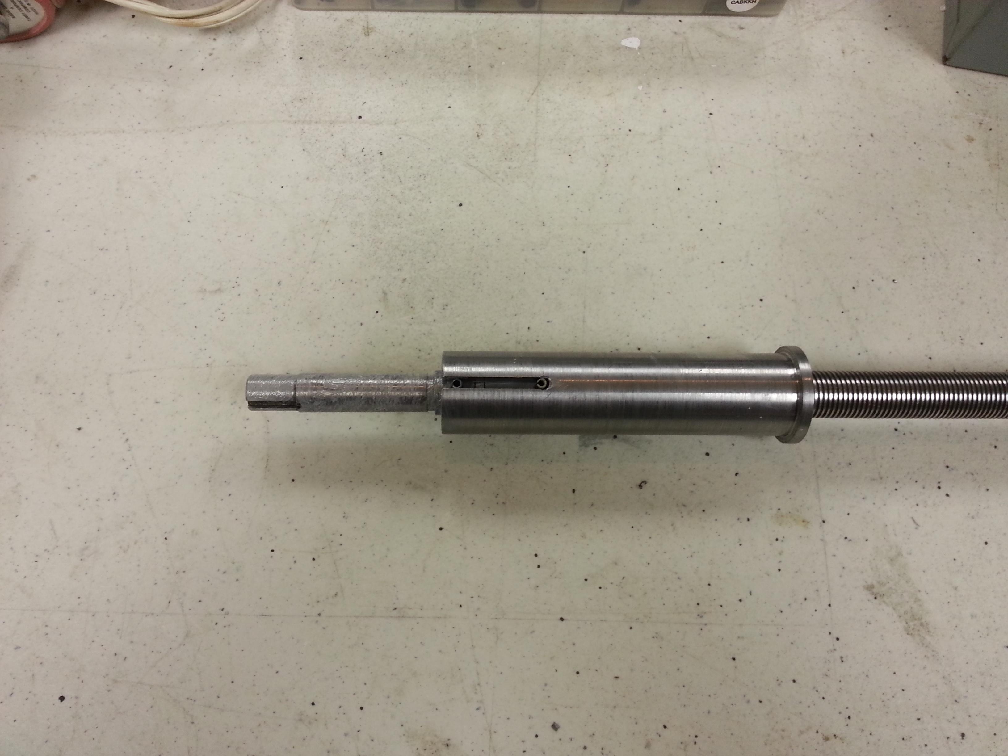

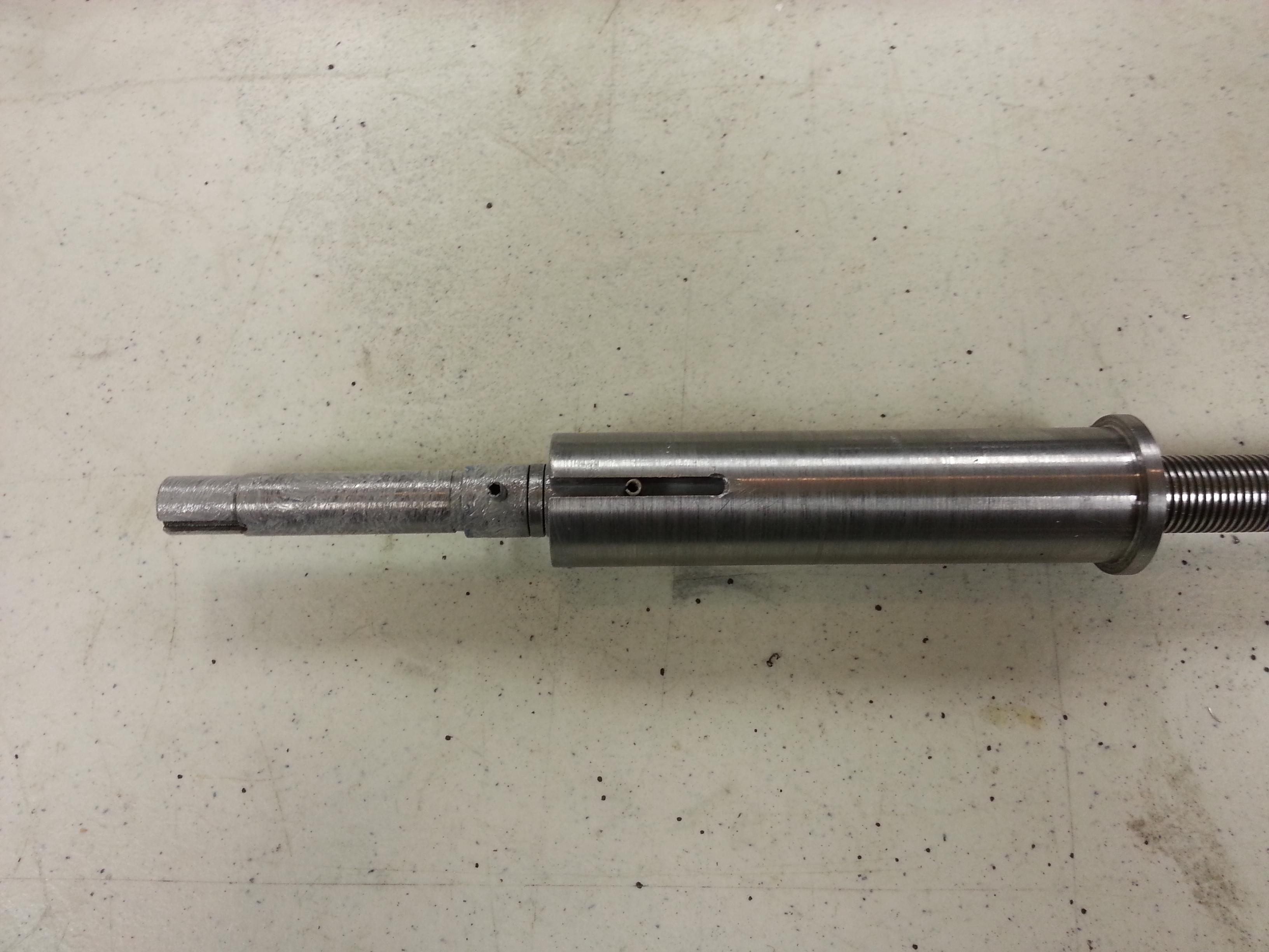

My current thinking is to cut the leadscrew shaft (this would reside behind the lower portion of the control box) and bore a 1/4" hole in the cut end of each segment. Ream the holes to end up with a nice slip fit for a piece of 1/4" drill rod. In the short piece of leadscrew shaft, toward the gears, hold the rod in place with a roll pin, extending out from the surface on each side of the leadscrew shaft enough to provide a dog for engagement. On the longer section of leadscrew, toward the carriage, another roll pin through it, but past the depth of the inserted drill rod, which now acts as a pilot shaft to hold the rods aligned as they rotate freely from one another.
Because the length of the leadscrew needs to remain a constant, the material sawn out of the cut will need to be replaced, so a bushing washer will need to be made to fill that gap, turning freely on the pilot shaft.
Next, make a sleeve that is reamed to a slip fit over the surfaces of the adjoining shaft segments. In that sleeve, mill a slot from one end on opposing sides that will fit to span the two roll pins as it slides toward the gears, providing the dog clutch engagement. It will need to be long enough to have abundant material toward the right end of it, unslotted, so it will be strong enough to keep the sleeve slots from trying to widen under the load of engagement. Round the inside corners of the open end of the slot to assist engagement as the sleeve is moved.
I need to do some measuring, but I am hoping to have enough clearance on the unthreaded section of the leadscrew to park the sleeve when disengaged, and have some way to slide it (lever, knob, etc.) protruding out the right end of the control box, yet not get into where I have my carriage stop clamped to keep things from hitting the chuck jaws. I use an aftermarket 4" chuck, which is rather large, so there is a lot of leadscrew below it that never sees use. If necessary, I may have to allow the back end of this sleeve to cover some of the unused leadscrew threads when it is disengaged.
Depending on how these dimensions work out, I may have room to put a yoke lever on the RH end of the sleeve to move it. (Like a clutch yoke on a manual transmisson car.) Otherwise I am thinking a sort of top hat shaped knob on the end of the sleeve, to pull it right or push it left. I wonder if such an arrangement would stay where it is set while using the lathe, or if a detent system would be needed to hold it in each engaged/disengaged position?
Offline drmico60
  • Posts: 69
    • mikesworkshop
« Reply #23 on: April 27, 2014, 12:05:22 PM »
I think the concern with your setup, at least for me anyway, is that if it is easy to swing the banjo to adjust it when you want to, could it possibly move on its own when you don't want it to? What holds it in the position you set? If it is the clamping action on the pillow block that holds it from moving, well, that seems just as much work to adjust as manually removing a gear from the stock setup. And still requires removing the gear cover. I had thought the clamp was a means of mounting it to something that is allowed to turn, so it could be effortlessly engaged/disengaged. That's why I envisioned a means of moving a control lever/knob attached to it, with a detent system.
What I am after is something that can be adjusted as easily as moving a knob or lever, with no tools required.
Hi Metal Muncher,
The banjo clamps to the pillow block extension with a screw. A quarter of a turn will lock the banjo securely to the pillow block. If you replaced the screw by a rod threaded at one end and cut a small piece of the gear cover away then all the operations to swing and lock the banjo can take place from outside the gear box cover. No tools would be required.
Mike

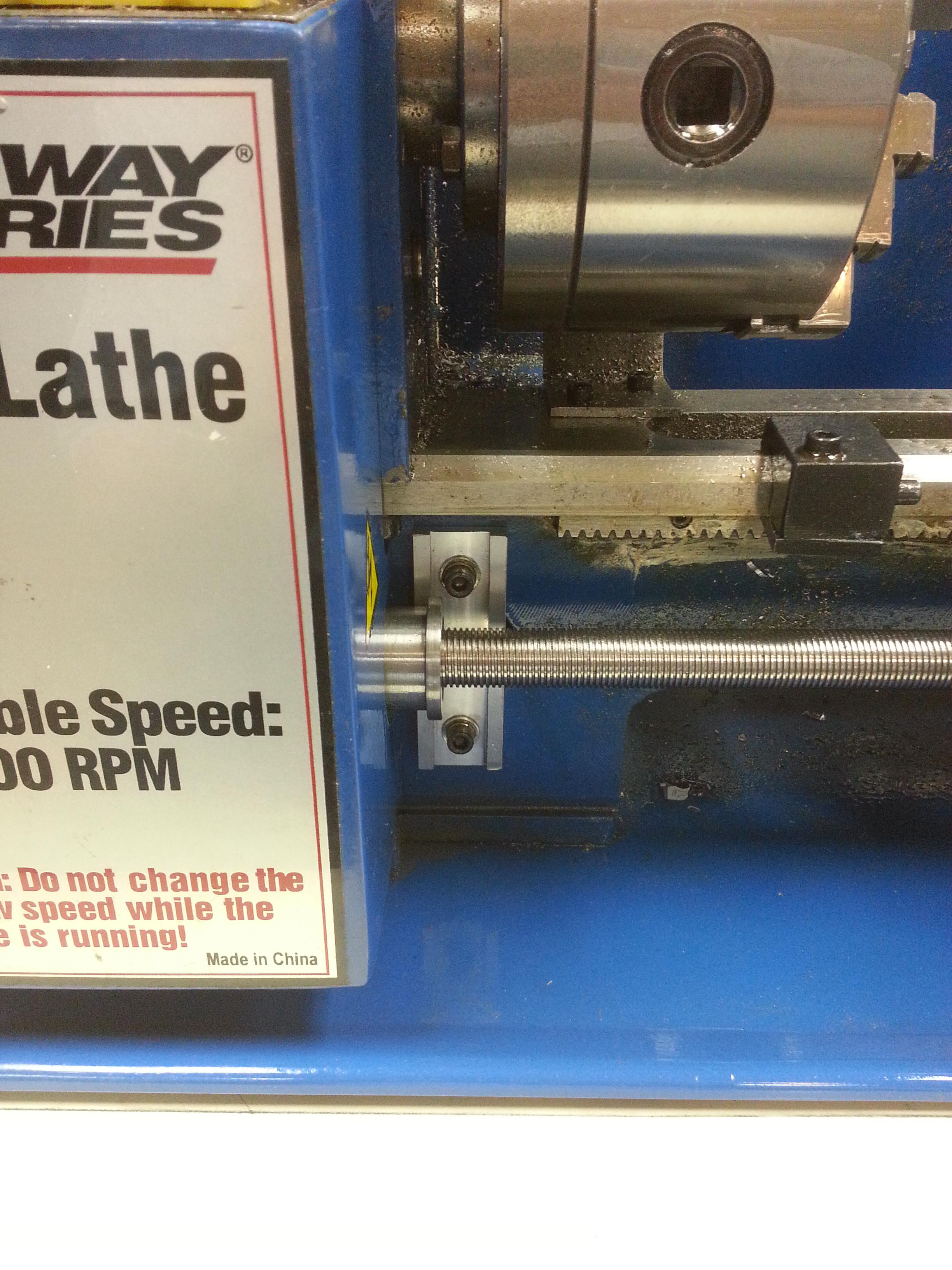

Offline guminase
  • Posts: 1
« Reply #24 on: April 27, 2014, 12:45:24 PM »
This Gentleman has made a nice, detailed Desciption of a Dog-Clutch for a Mini-Lathe:
http://www.gadgetbuilder.com/Dog_Clutch.html

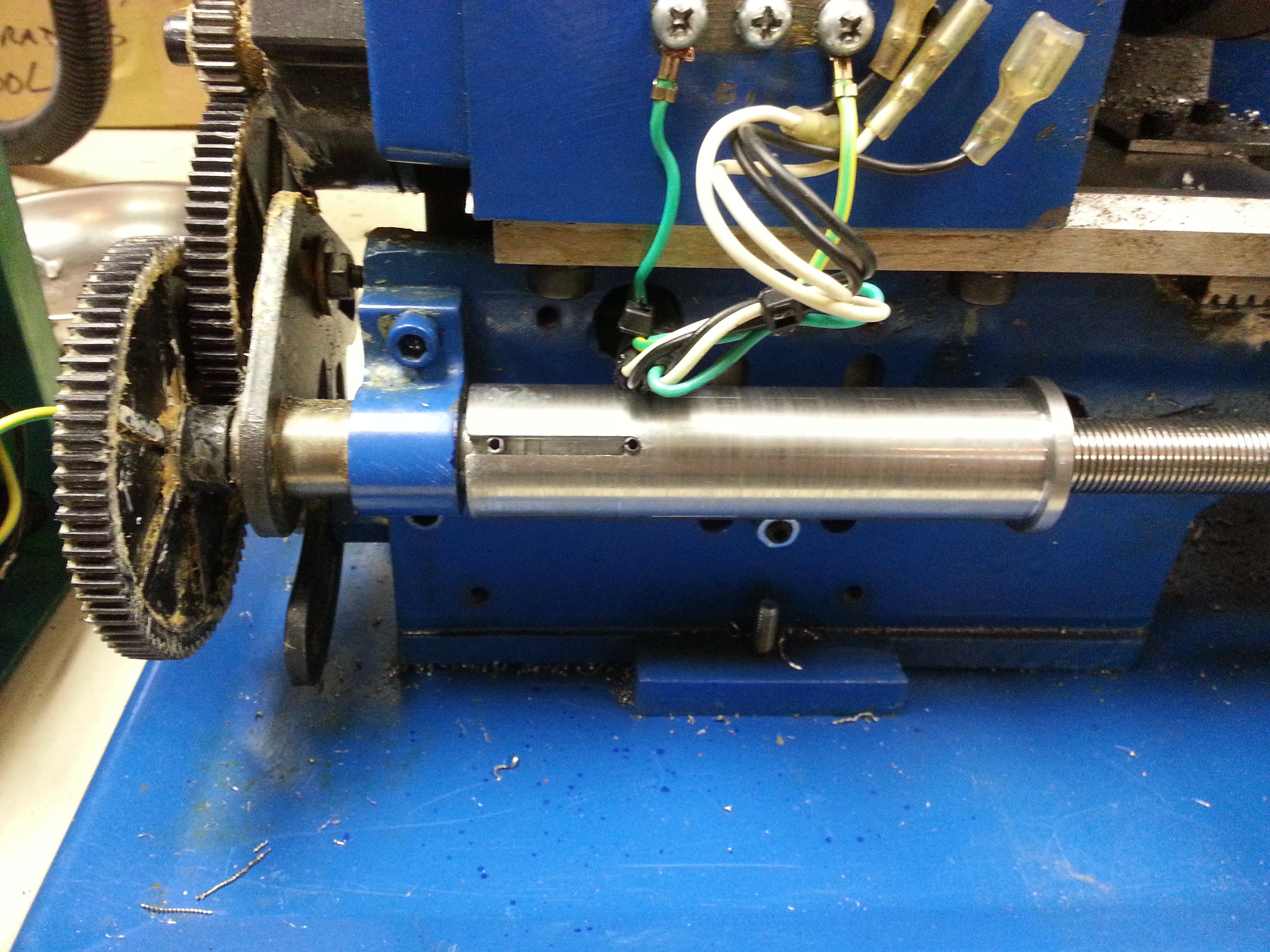

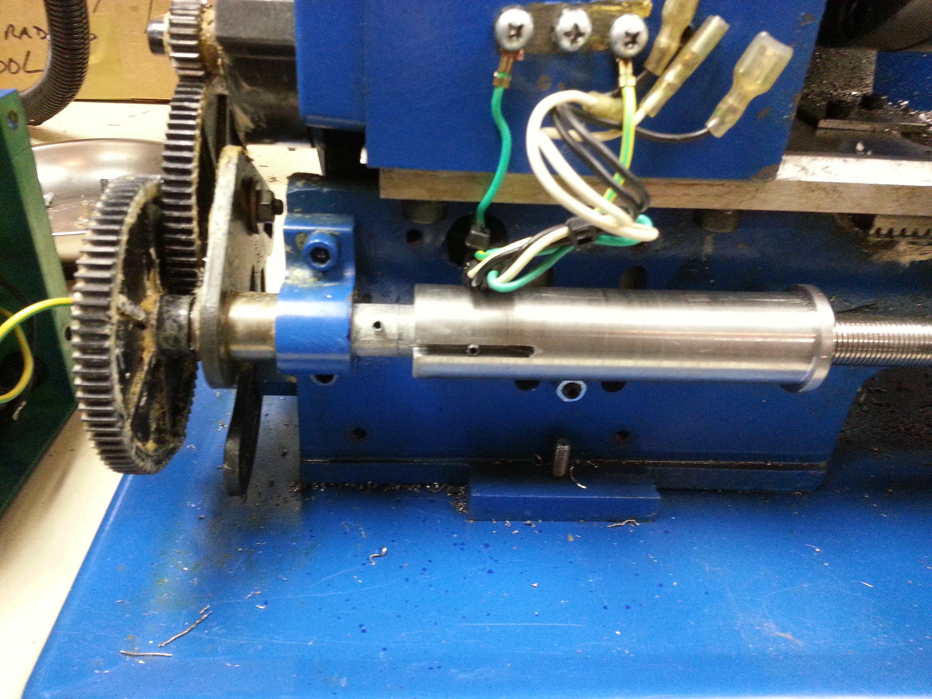

Hi MetalMuncher, and everyone else. I'm a newbie to this forum but have been a reader for a while and learned a lot from folk who are very obviously more skilled than I can ever hope to be.
But I just had to join to post a reply to your plea for a leadscrew clutch for a minilathe. This is my third attempt to post, others seem to have become lost somewhere in the aether, probably because I had some large photos attached.
I faced exactly this problem a while ago and built an electro-mechanical dog-clutch for my minilathe that seems to work very well and also acts as a very accurate and flexible saddle-stop when turning under power.
I am not posting any photos this time in the hope that this post makes it through, if someone can tell me what I'm doing wrong with the photos (attaching jpg's from my desktop) I'll get some photos on. I should also have some hand-drawn dimensioned sketches somewhere if those might be of interest.

« Reply #29 on: May 01, 2014, 07:42:55 PM »
Hi MetalMuncher,
Sounds similar in some ways. But I fitted additional leadscrew mounting blocks to keep the alignment of the two parts of the cut leadscrew (it is possible in the space available) and disposed of the problem of leadscrew endfloat that way. I then used cross-pins in the two parts of the leadscrew with a sliding sleeve to engage. The sleeve is moved manually into engagement against a spring and held in engagement by a latching mechanism. The latch is released by a low-voltage solenoid that is powered via a switch mounted on the lathe ways and operated by contact with the carriage. In fact because there is no mechanical linkage to the solenoid alternative methods of switching are possible and the switch could be mounted anywhere on the ways or even on the carriage itself. The only sensitive issue is finding a spring that is strong enough to disengage the mechanism while cutting under power, but not so strong that manual engagement is difficult.
I'll have another go at posting a photo.
Dennis
Offline DennisS
  • Posts: 8
« Reply #30 on: May 01, 2014, 07:51:11 PM »
Another go at posting a picture

Interesting setup, Dennis. What is the vertical rod gizmo out on the end with the gear drive?
Offline DennisS
  • Posts: 8
« Reply #32 on: May 02, 2014, 07:21:12 PM »
That is the operating lever for manually engaging the clutch. Mabe a bit of overkill in size. See attached.

Offline MetalMuncher
  • Posts: 93
« Reply #36 on: May 03, 2014, 01:45:31 AM »
OK, it seems trying to add multiple attachments to an original post won't work. But I was able to attach ONE photo to a post. Then using the Modify option on that post, I was able to add 3 more attachments, one at a time, saving after each one, and re-clicking "Modify". Klunky, but it worked. :)
So here you can see the sleeve and modified leadscrew. A 5/16" pilot pin of drill rod is inserted between the 2 pieces of leadscrew, and then I made a custom washer to remove all endplay when the leadscrew is installed. The washer is visible between the two roll pins. The left roll pin holds the drill rod pilot pin in place. The right roll pin passes through the leadscrew shaft away from the pilot pin, so that end of the leadscrew can rotate freely on the pilot pin when the sleeve is disengaged from locking the 2 pins together.
I'll have to enlarge the shaft hole in the right side of the control box. The ring on the sleeve will extend a little to the right of the box when engaged, and extend a little more when disengaged. The sleeve moves about 0.400" to operate the clutch. The sleeve is 1.1" in diameter (not counting the ring on the end for moving the sleeve) and the inside has 2 different diameters, as the threads on the leadscrew are approx. 5/8", but the un-threaded shaft is 0.593". The sleeve is just over 4" long, made from 12L14 leaded steel.
I had to shorten the top setscrew that helps align the motor housing, so it did not stick out so far, as it was in the way of the sleeve turning. I cut down a setscrew so that the locking washer is nearly flush with the socket head, and put that in place of the stock setscrew.
The plastic baffle that keeps the control wiring off the leadscrew may work with some modification, otherwise I may need to make something to replace it.
« Last Edit: May 03, 2014, 02:09:43 AM by MetalMuncher »

Hi Metal Muncher, an elegant solution and probably certainly more easily accommodated within the limited space available. I presume that you will be using a selector fork of some sort to engage/disengage.
I had to relocate the big electrical "choke" that normally occupies space in the bottom of the control box but did manage to fit that within the box and added a cooling fan to the power transistors as well - I was already running low volts to the relay and happened to have an old 12v computer fan sitting doing nothing, so ...
I snipped a little off the black plastic guard that keeps the electrics off the leadscrew and was able to refit that. See photo attached which is an earlier
As for photos, previously I had been posting very large jpg files that were not being accepted. Once I resized those to 640x480 there was no problem at all.

« Reply #38 on: May 04, 2014, 01:11:46 AM »
There's a lot going on in there, DennisS! :)
I had thought I might use a fork to position the sleeve clutch, but with some careful tweaking and lithium grease I have it to where I can move it with a finger. The tendency to stick a little at either extreme of travel, beyond the amount needed to work, got annoying, so tonight I provided a solution. I constrained the "knob" ring's travel so that the sleeve can't dead end against either direction. So it is no longer sticky. Works very smoothly now. :)
I had to deal with that plastic "shelf" inside the box too, because it would have contacted the sleeve in my design. After kicking around some ideas, I settled on creating a wedged spacer to go under the mounting flange for the shelf. One side is flat against the lathe bed, and the other side is at a 15 degree angle. This causes the shelf to tip upward at 15 degrees, missing my clutch sleeve, but still doing its job of keeping the wires away from the leadscrew.
Here's a shot of my constraint bracket. The knob's raised end travels 5/8" between the ridge on either side of the bracket, but has to stay within it.
There must be some difference in the way models of this mini lathe are wired, because I don't have a choke in the bottom of my control box. I can't say I've ever noticed any problem electronically here while the lathe is in use.

« Reply #40 on: May 04, 2014, 10:09:17 PM »
Hi DennisS,
I have a couple ideas if the sleeve tends to wander, but now that I have the little channel doing its constraint job, the detent style that first comes to mind would be a little curved piece of spring steel mounted in the "valley" of the channel, oriented in the path of the sleeve's ring, so it has to slightly compress the spring to get past it. Or I could accomplish the same goal by mounting a pair of small bearing balls in the line of travel, (one for each position against the channel edges) drilled in from the back side, with something springy behind them, so that they just rise above the flat valley on the front of the channel. Much like how a typical ratchet wrench retains a socket. Perhaps a layer of rubber, inlaid behind the channel, to compress against each ball? The whole thing is only about 0.140" thick, so I am limited to what I can do in that regard.
Or the option for a fork lever would still work. But I like the clean simplicity of how it works now.
Hmm. I made that channel 5/8" wide. I wonder if a piece of broken tape rule, mounted convex outward, in the channel would do the trick? I could screw each end of it and leave the center section free to compress.
