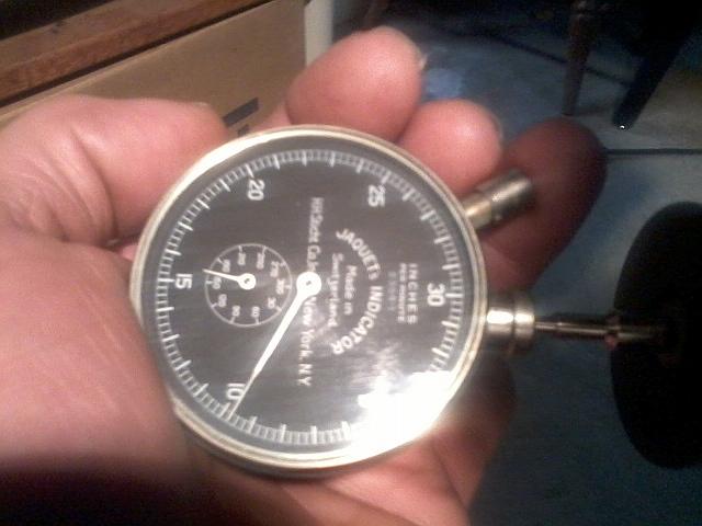

I have a decades old ShopForce brand 4x6 bandsaw.  After several decades of happy use it began giving me problems such as the blade not cutting, etc., then the belt finally reached the end of it's stretch and came apart.
I wish to share my findings.  First, it does NOT use a 1/2" belt.  Use of a 1/2 inch wide replacement belt produces wildly high excessive blade speeds.  Instead the saw pulley uses a 10mmx8MM or 3/8" belt.  This size of Metric belt is called an SPZ class belt.  Your original belt may, or may not, have a 3 digit number on it.  Mine had a 559.  That is about 22".  559 560 and 562 are all available SPZ belt sizes.  Since the pulley arrangement has a lot of play in the adjustment range any of those should work in your machine assuming you too have one of the older metric belt arrangements.  I suspect the American 3/8 x 22" size belt would probably also work in my machine.
Be dubious when you read someone else just threw in a 1/2" belt of some kind or another and everything has been just fine since then.  Tell them to check their blade speed.   :)

My statement was, "use of a 1/2 inch wide replacement belt produces wildly high excessive blade speeds."
There exists a reason I chose those specific words.  I measured the speed that resulted with a 1/2 inch belt and the pulleys configured for a blade speed of 80 feet per minute.  Precisely, with a Jaquets Indicator.  Then I double checked pulley setting and also the Jaquets against a known standard (a tractor PTO) and yeah it works just fine.  Then I took a reading of the blade's speed again, and again.
I stand by my use of the words wildly excessive.
Average feet per minute speed of the blade with a 1/2 inch belt was about 1,100 fpm.
In the 6 seconds allotted the  small wheel spins and passes the 300 inch mark not less than 7 times.

You can usually see the welded area of the blade so why not just time how long it takes the blade to a full pass.
The 4x6 bandsaws use a 64.5" blade. At 80 feet per minute the blade would take about 4 seconds to do a complete lap.
For 1100 feet per minute the blade would be doing a full lap in 0.3 sec!
Something just doesn't add up.

Philf,
A full lap in about 0.3 seconds.  Yeah I'd say that's just about right and what I see.
Actually that does add up very nicely and your calculation is completely explaining why I am getting at least 7+ rotations of the 300 inch mark in 6 seconds.  In short both your rough calculation and the Jaquet indicator agree..  300 in. / 64.5 = 4.65 blade lengths to one revolution of the 300 inch pointer.  7 revolutions in 6 seconds mean 2,100 inches.  For linear foot per minute readings with the Jaquet,  /2 = 1050, now add 1/2 of the big pointer's number.  Voila 1,100 fpm.

For those not familiar with Jaquets Indicators, these things are early manual tachometers designed specifically for the purpose of checking and adjusting the speed of spindles, conveyor belts, cog wheels, saws and the like in factories or in the field when making repairs (say on a combine or a tractor's PTO).  They are very accurate.  Electricity and changes in technolgy has led to them pretty much being replaced by cheap electronic laser readers, but the hand held mechanical things can still be special ordered although I note with some bemusement the newer ones work in meters rather than inches, feet or yards.  My understanding is Jaquet started marketing them through HH Sticht sometime around 1910 but by 1990 switched manufacturing emphasis to cheaper plastic and laser readers.  Multiple versions exist, some with faceplates set up to show RPMs, some with faceplates set up to show inches or linear feet per minute, some with hi-lo ranges, some (like mine) that don't care, some with both the RPM  and the linear feet per minute reading shown plainly on the dial, some with a built in 3 second chronometer, some with a built in 6 second chronometer.  You select one kind of probe for pressing against the central axis of a shaft or a spindle to get an RPM, or a wheel of the appropriate size for getting a linear reading.  Both HH Sticht and Jaquet are still in business.
http://www.vijaytradesyndicate.com/index.php/textile-instruments/jaquet-swiss-make-mechanical-tachometer
