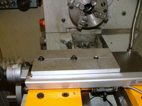

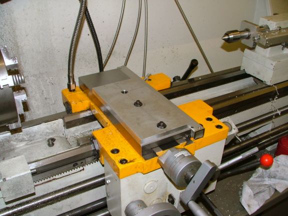

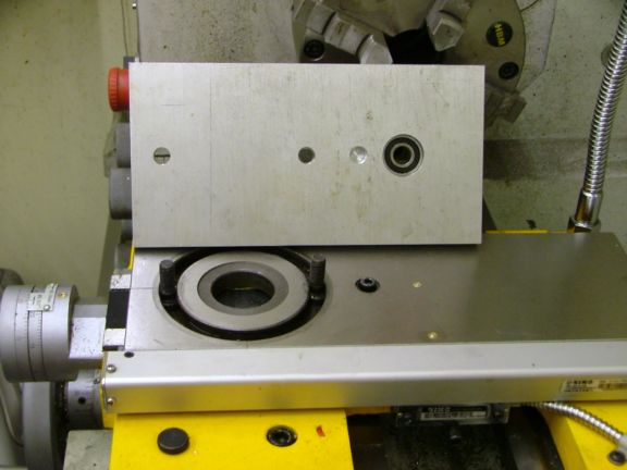

There are two main issues you should be looking at when fitting one to our type of lathe.
The first, and major one is that because we don't have a slotted cross slide, the cross slide will need to be either drilled or machined to accept the vertical slide. Not a thing I would like to do. I have already asked the question about slots, but after having a good look at it while it was off, there isn't really enough meat on it to put a decent slot in there.
You cannot mount it where the topslide fits as that will not give you enough movement in the Y axis to get the full functionality and versatility of the vertical slide. You could make an extender plate, as I am doing with my ball turner, that utilises the topslide mounting bolts, and move the operating centre across by about 75mm to 100mm. It would need to be fairly substantial in it's thickness to take the stresses of cutting, say 12mm or thicker steel plate.
I have just been out to my shop and set up my plate to show you what I am on about. See attached pics. Mine is in ali because it will only be taking fine cuts. It still needs a cross slot putting in, to clear the ball oilers.
The other is that if you do get one, make sure it has a rotating base, it looks like the large one from Chester has some functionality in that department, but I can't tell for sure from the pic.
Here is the type you should be looking for, but unfortunately, they are out of stock. As you can see, it also has a slotted face for versatility. But because it is designed for a Myford, it might have imperial graduations. Maybe an email could clear up when they will be back in stock and what the dial graduations are in. But you would need to fit a vice as well. The Chester one has some sort of excuse for one already on theirs.
