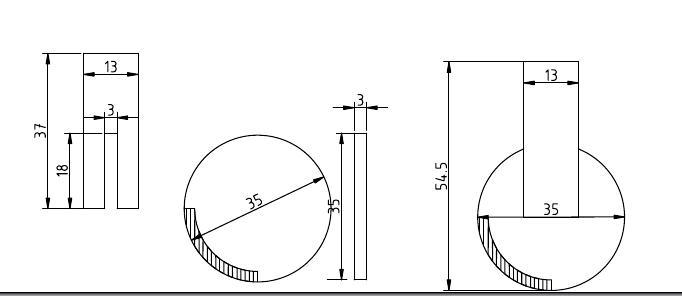

This is how I would do it.  Obtain a short length of steel bar of a suitable diameter or a little larger.  Turn it down to the correct diameter.  Part off a disc, say 3 or 4 mm thick.  Make a spindle from a bit of 1/2" rod and mill a slot in the end to take the disc. Braze or weld the disc into the end.  Now grind a relief on opposite edges, like a spade drill, so that it will clear the work when cutting.  Heat the disc up to red heat plunge into a tin with some sugar in it.  Repeat, then dunk in water.  This will harden it.  Use like an end mill with plenty of lube.
The other way would be to put it in the four jaw on the lathe and use jubilee clips to keep it together. True it up and then drill a pilot hole as deep as you can and then use the big drill.  You will still need to use lube.  I use paraffin for alloy.
HTH.
Attached drawing.  May help !
