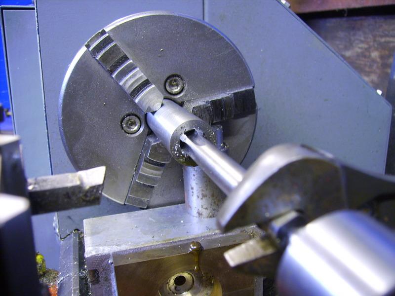

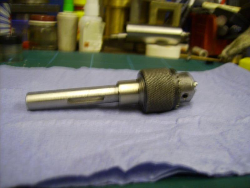

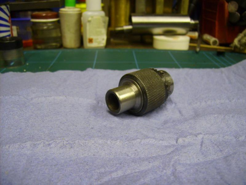

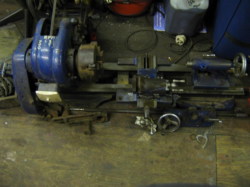

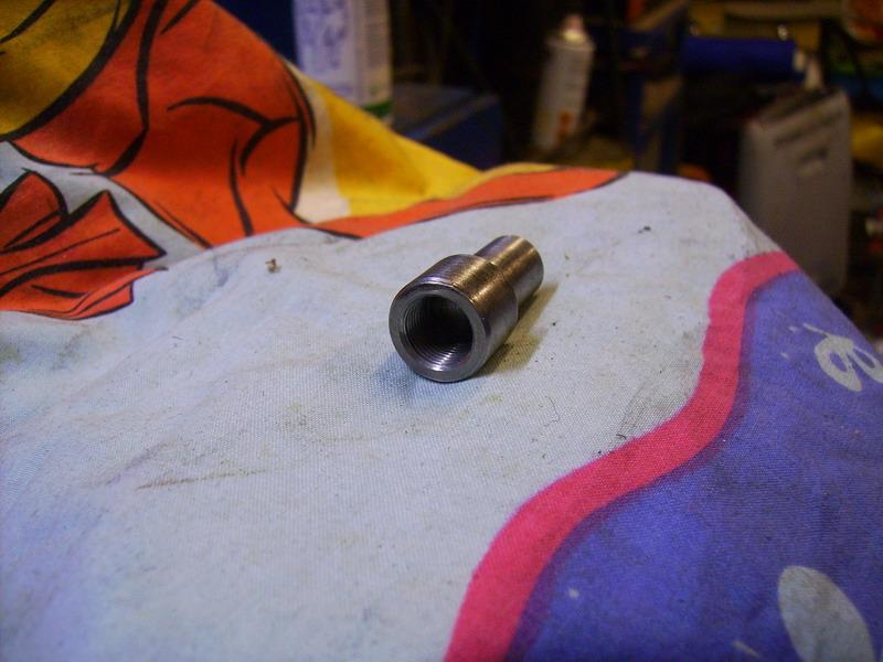

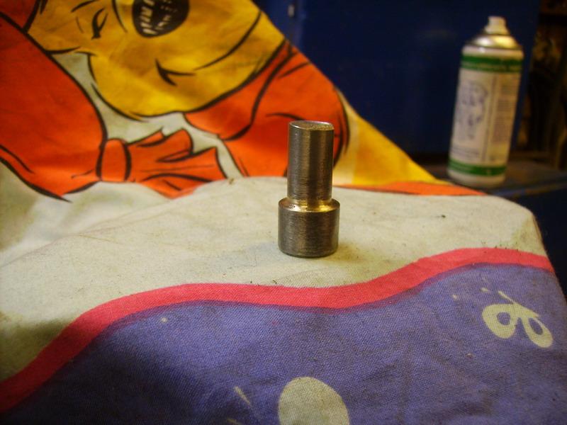

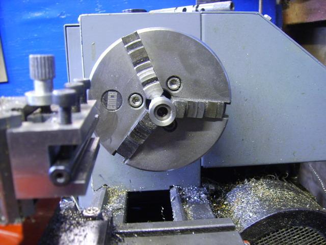

hi all well i started this and for got to tack pics of it befor i started
striped the lathe right dawn removed the old pant and started to make a adapter for a drill chuck for the tale stock striped the tale stock out got sum stainless bar chucked it up in the lathe and drilled it 11m by 35 deep then taped it m12x1 witch i borrowed from work then cut it off by 15mm then screwed it on to the tale stock sleeve then turned the OD to 16mm then bored out the end to 12mm that is as far as i have got tonight will post sum more tomorrow right pics

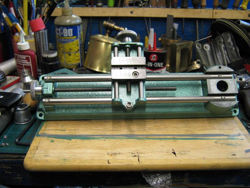

hi i have plast a order fore sum 12mm od silver steel for new rales fore the bed

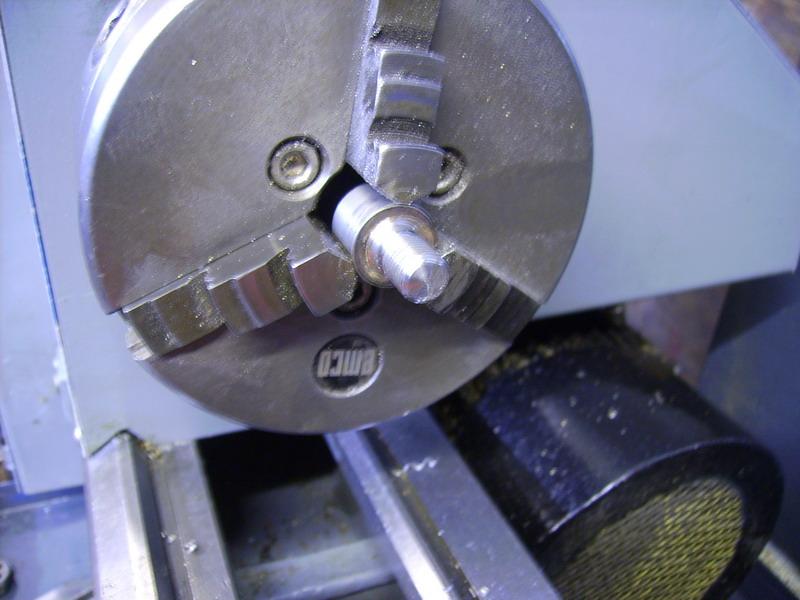

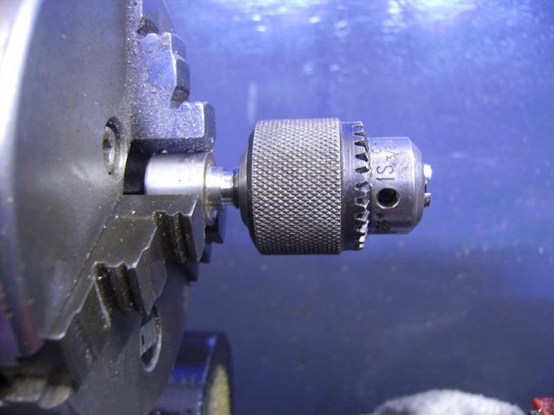

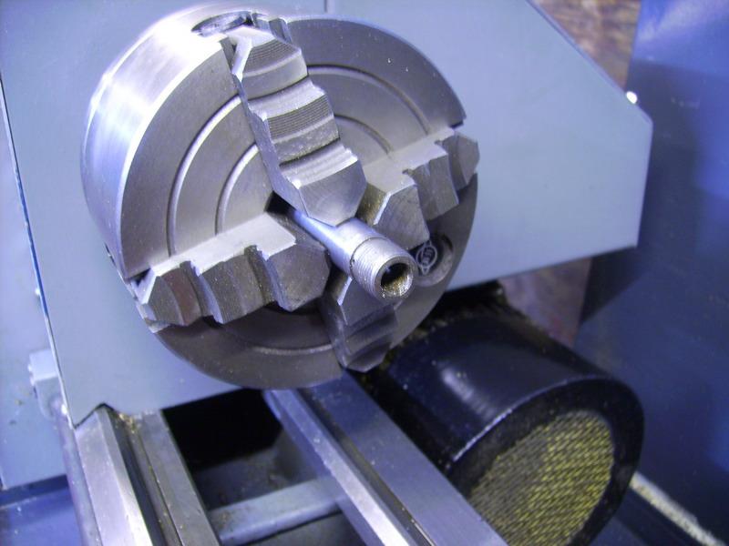

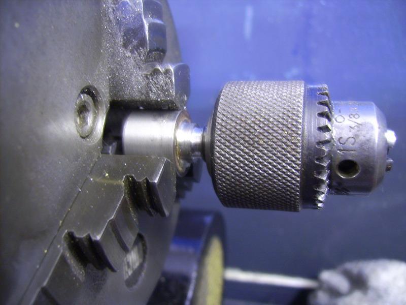

hi as promised but late i finished off the tale stock adapter for the chuck i put the tale stock tube in me 4 jaw chuck and cloced it in sos no pics of that bit then put the edapter on to it and turnd it paralel it the tube then threded the end 20 unf to fit the chuck then all was dun but i had to put it back in me 3 jaw chuck as i did not put a grove at the back of the htreds to let the chuck go right back right pics

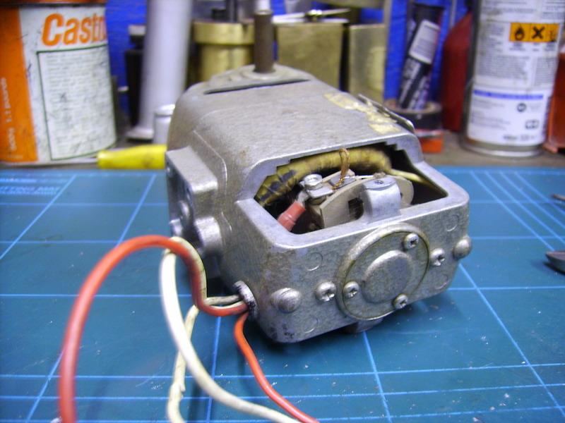

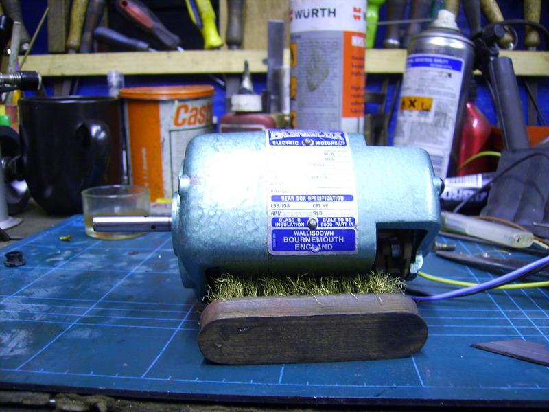

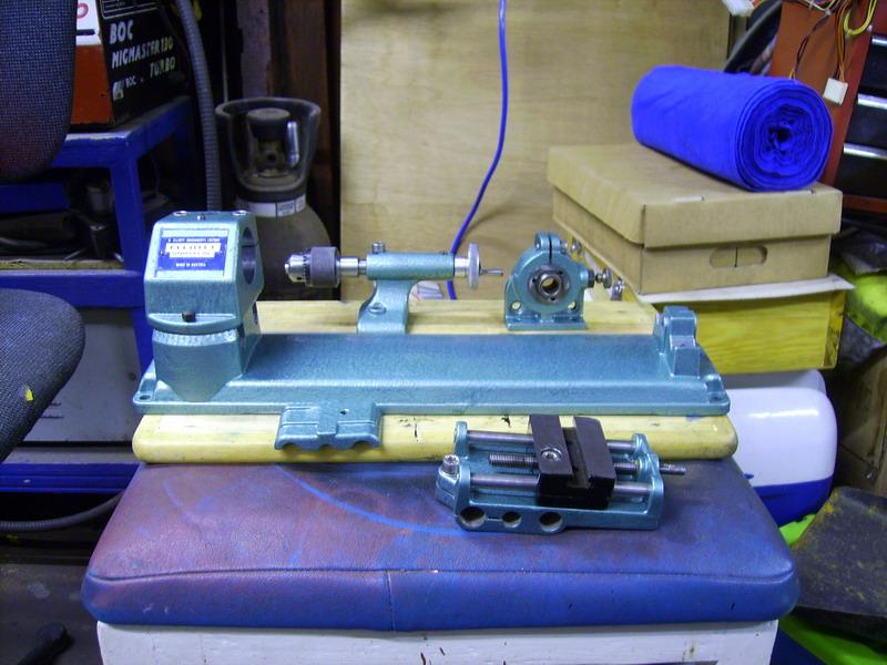

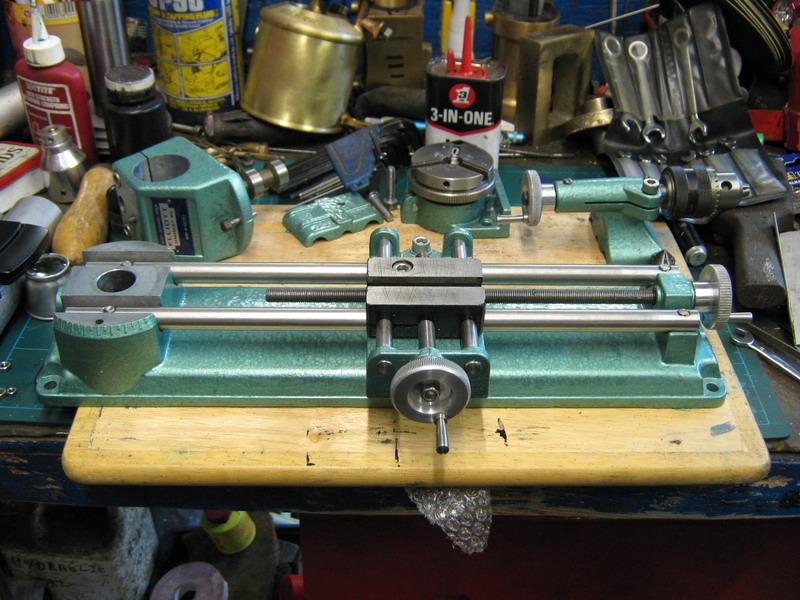

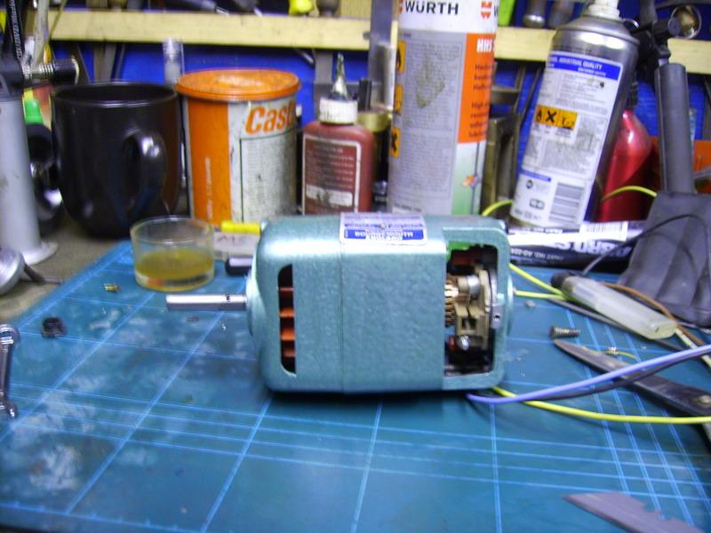

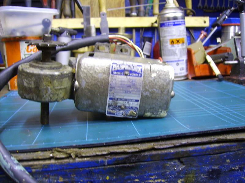

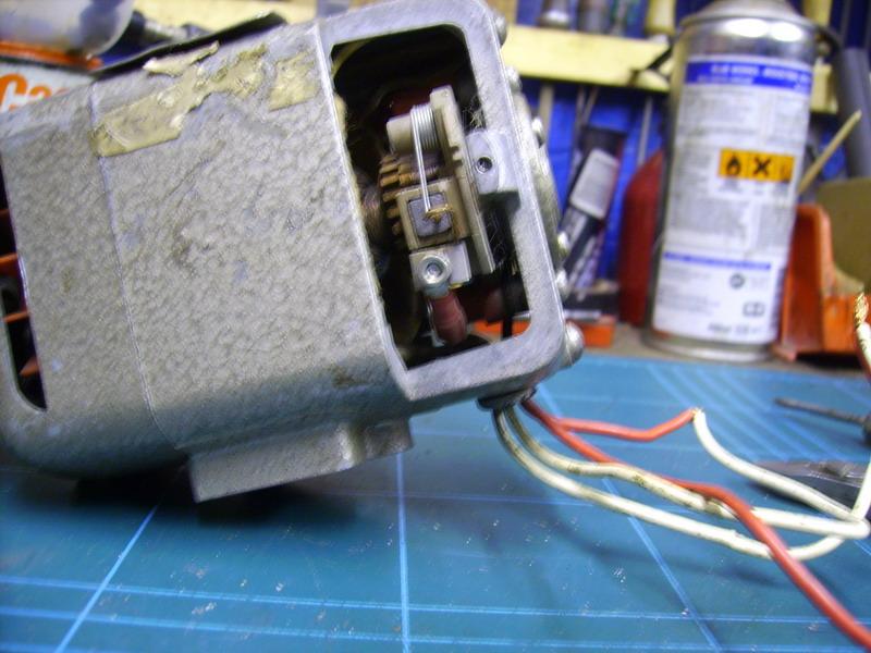

hi all well its all panted gnaw and i have a rotating head witch was given to me by mick thank you so much witch the jaws fit the chuck on the lathe so i don't need to look for a replacement chuck pad a visit to peters and he had a rummage and came up with a motor for it not a original motor but one that will do the job nicely so today i have spent striping the motor re-panting it and re wiring it it needs two new Bering's but their are plenty of them on the net right pics

Hi Bob, its looking really smart now , should look like new once you are finished with it. I am glad the rotating head and chuck have solved your chuck problem , looks like Peter has come up trumps with a motor so just really the bed bars you need now ? I look forward to seeing it up and running soon

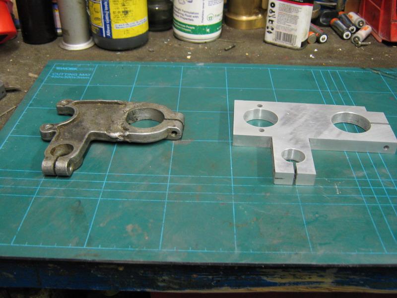

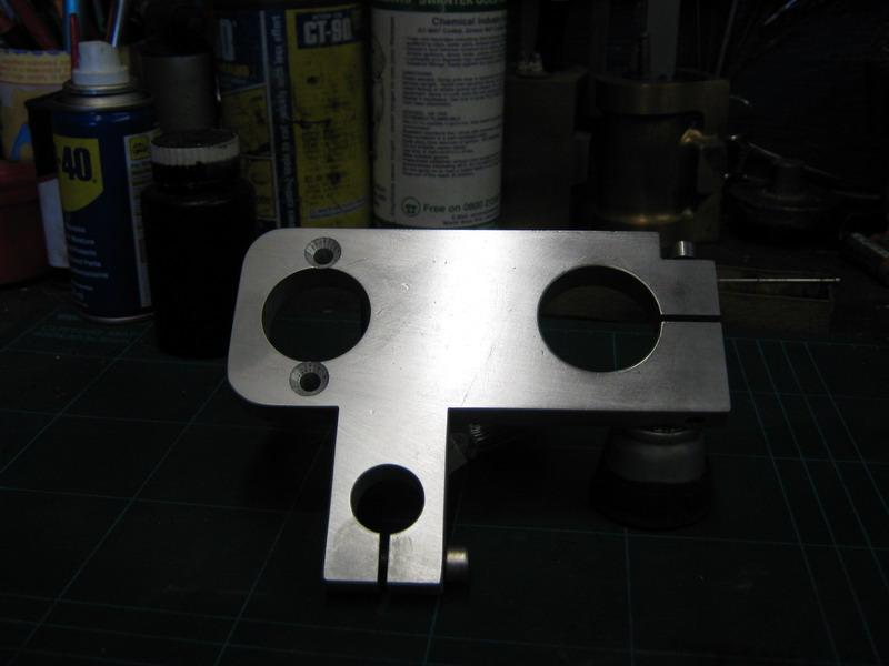

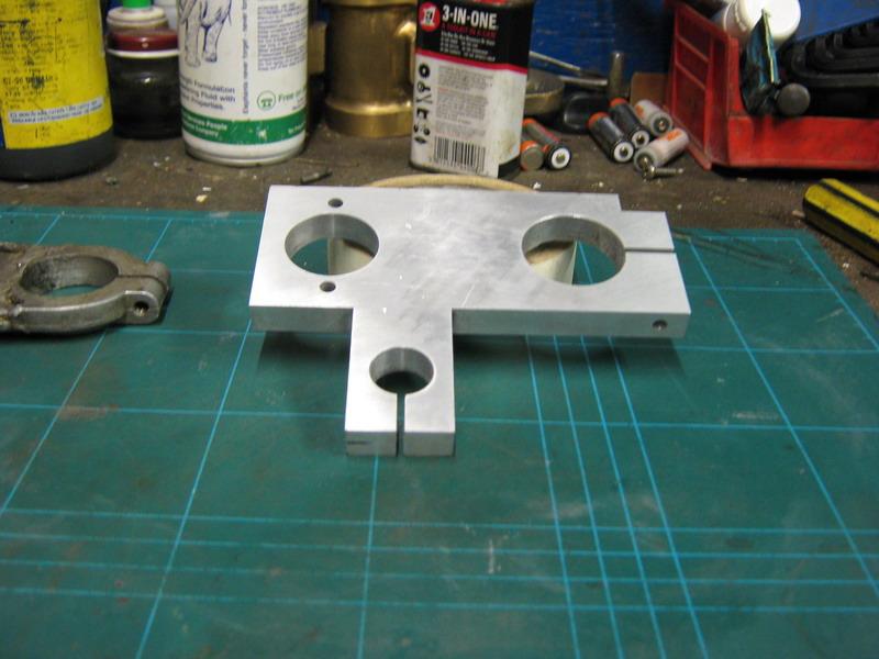

hi all SOS for the long delay in post on the lathe had a problem with the motor i got a replacement motor for£5 at the boot sale the next job was to mack a new motor mount bracket as the original one had bin welded up badly i marked out a plate sum time a go but without a mill it wood of bin hard for me to get it dun but then John IE doubleboost offed me the use of his mill to do the bracket SOS no pics of me milling it just ones of the finished bracket right pics

May 26, 2014, 06:38:37 PM »
Better than the flimsy original part Bob , a fine job , should be a really nice little lathe once you are finished with it.

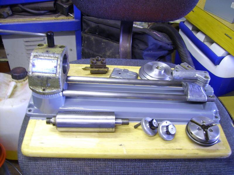

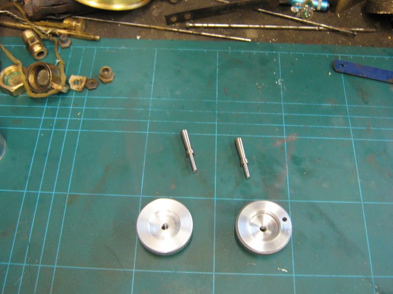

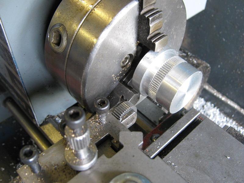

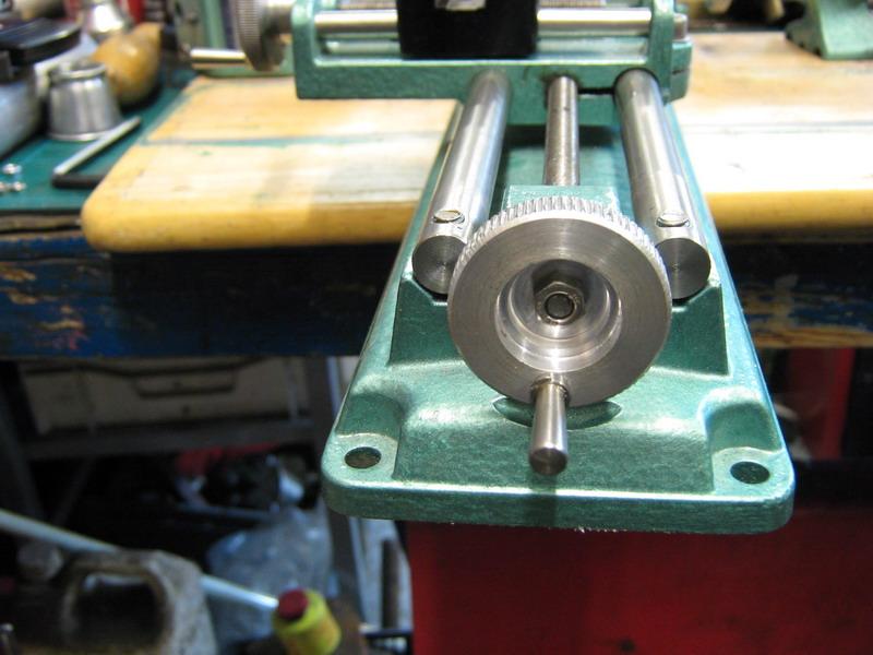

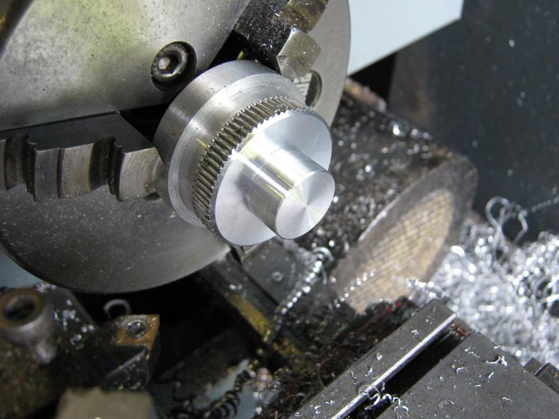

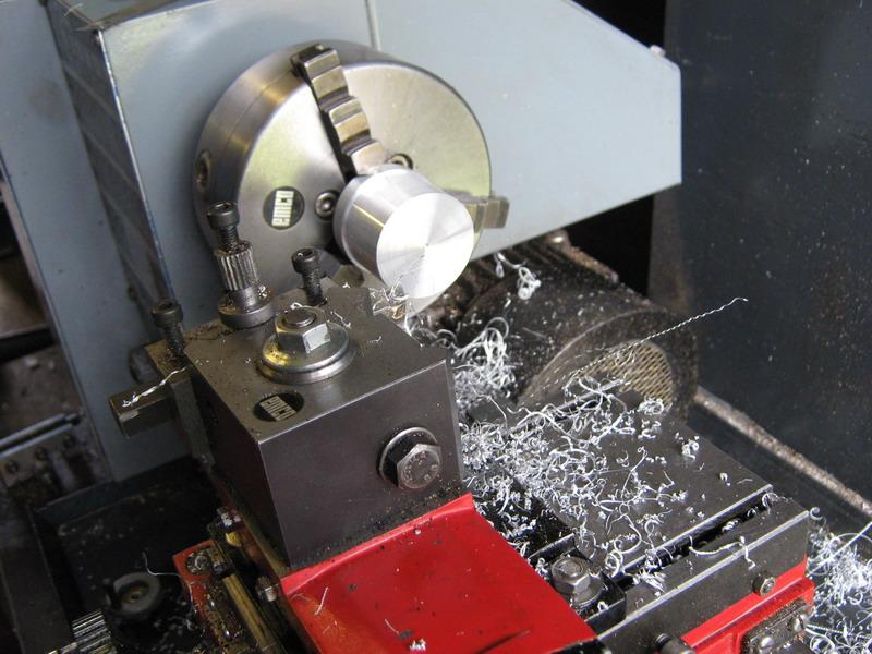

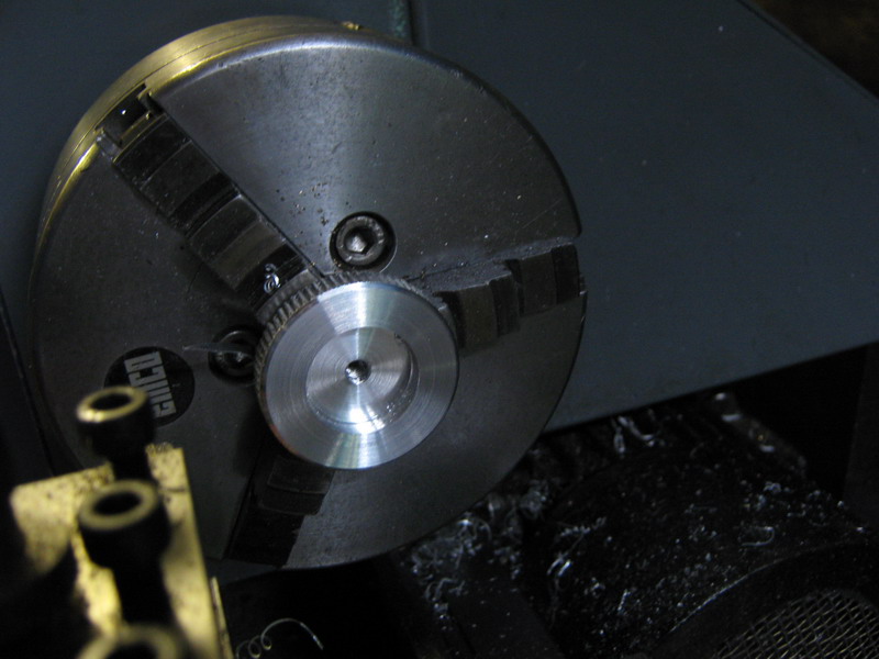

hi all as on the last leg of restoring the sl lathe. john ie doubleboost drilled and tap the new bed bares thank you so mutch john :thumbsup: so i have fitted them the next thing was to mack a new hand wheel as one of them was missing got a lump of aluminum turned it dawn just under the OD of the original one then put a knurl on it then turned it dawn to the size of where the indexing macks shod be then drilled it and tap it for m5 then mad up two handles out of stainless steel then tried to fit the Handel for sum on reason their seemed to be not enuf thread sticking out of the Handel to fit the nut on to had it back to bits and fawned that the end of the feed screw thread had bin cut off so i had to mack the recess deeper in the Handel so the nut can go on right pics on a different note i have this lathe to sort out to its a Atlas 10 need a pdf on one if any one has one
