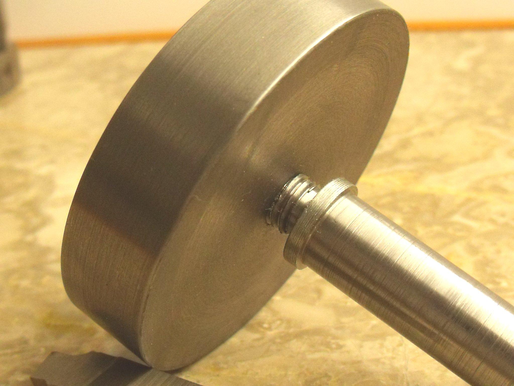

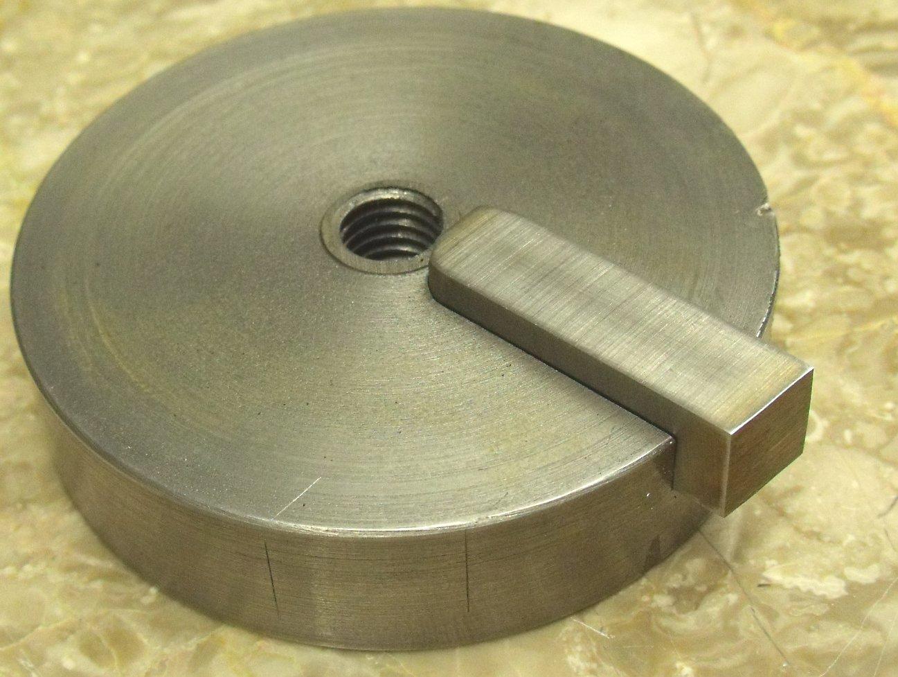

Hi Guys,
I posted this as part of another thread but since I seem to be making fly cutters lately I thought I'd post it/them here.
The first one is a simple 1/2" inch thick disc, in this instance stainless steel, with a 2.5" inch length of 16mm silver steel rod for a shaft, turned down on one end to be a press fit into a 1/2" inch hole drilled in the centre and an 8mm hole drilled near the edge to hold a 6mm square toolbit secured with a 2Ba grub screw.  There are a couple of pictures of the toolbit cutting edge.
Best Regards:
                     Baron

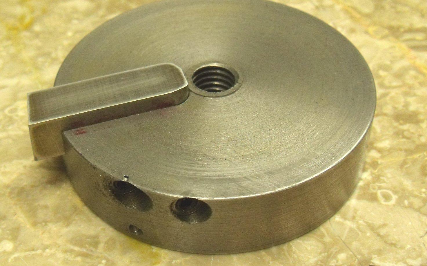

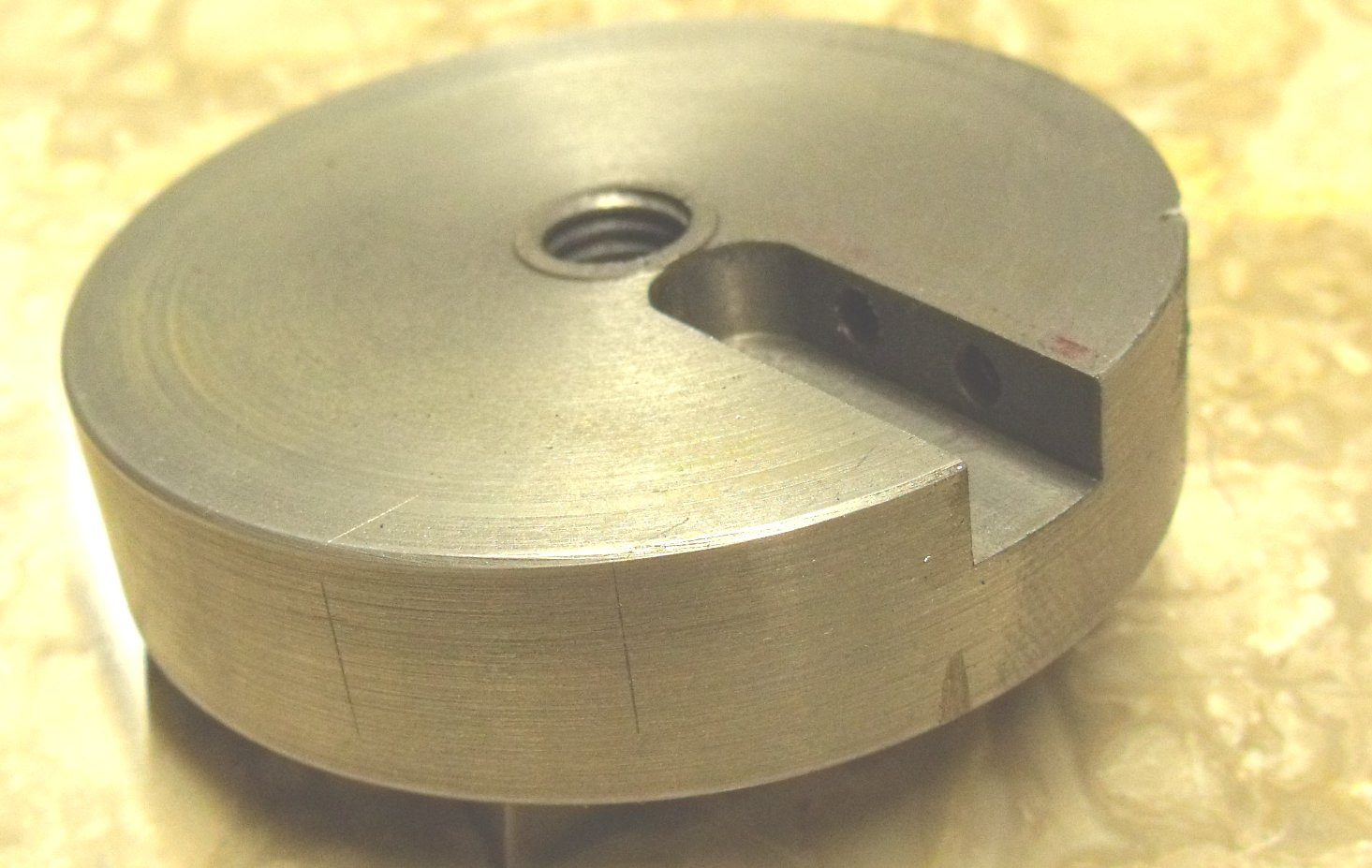

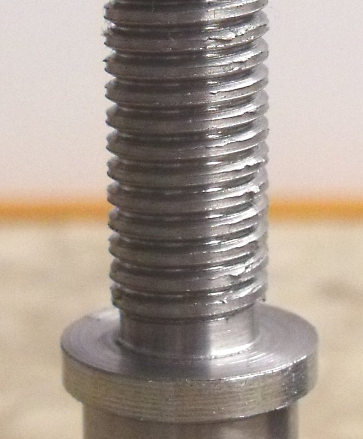

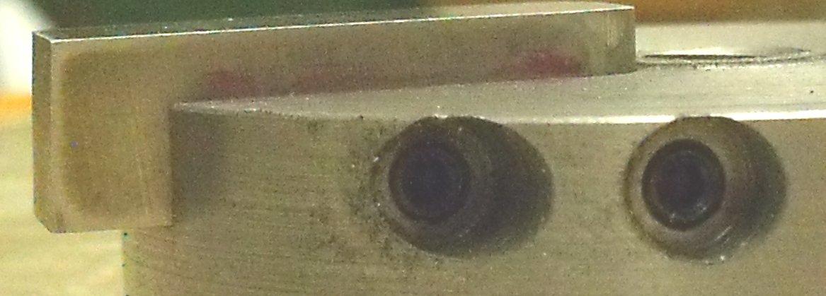

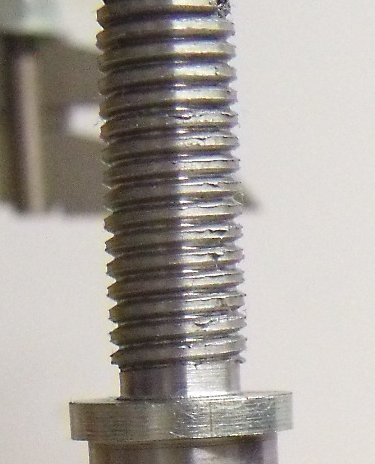

Hi Guys,
This is the second fly cutter.  Similar to the first one but intended for a different job.  Here I used a cast iron disc 3" inches in diameter with a milled a slot to hold a 6mm toolbit horizontally the tool bit is held in place by two M4 grub screws.  Also I used a M10 threaded spindle cut from a short length of 1/2" silver steel rod so that I could use the spindle for another job.
I think that I cut the threaded part a bit small since the threads have a flat top on them.
Best Regards:
                     Baron

« Reply #3 on: March 01, 2014, 03:08:30 PM »
Hi Rick,
They are pretty easy to make.  Both these were made with scrap bits culled from various places.  The second one using a cast iron disc is more complex but still not difficult.
As you can see from the pictures I made a small error in the diameter when turning down for the M10 thread but it fastens securely and buts up to the flange dead square.
I'll take some more photos of the second one showing the toolbit and fastening screws.

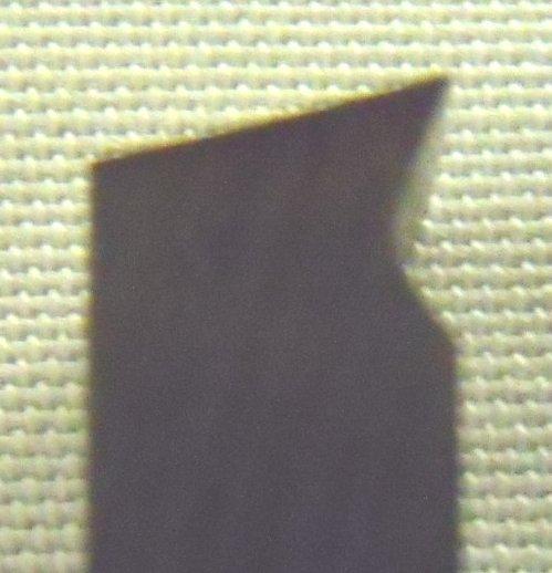

It really depends on the toolbit shape and angles.  I did some tests with a semicircular tip on BMS and got good results, on cast iron just have a look at the second fly cutter pictures.  I found that a sharper edged toolbit seemed to be better on aluminium and a much higher speed around 1000 rpm.  I did try an uninterupted cut of 0.5mm on a piece of black plate, fairly low speed but found that the mill struggled quite a bit.  A learning experience really, discovering what the mill was capable of without pushing it too hard.

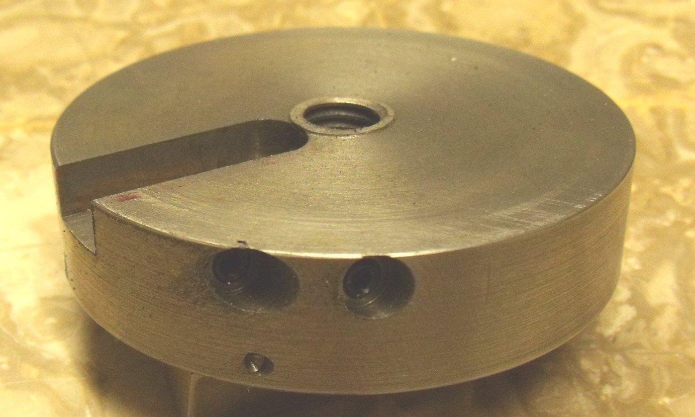

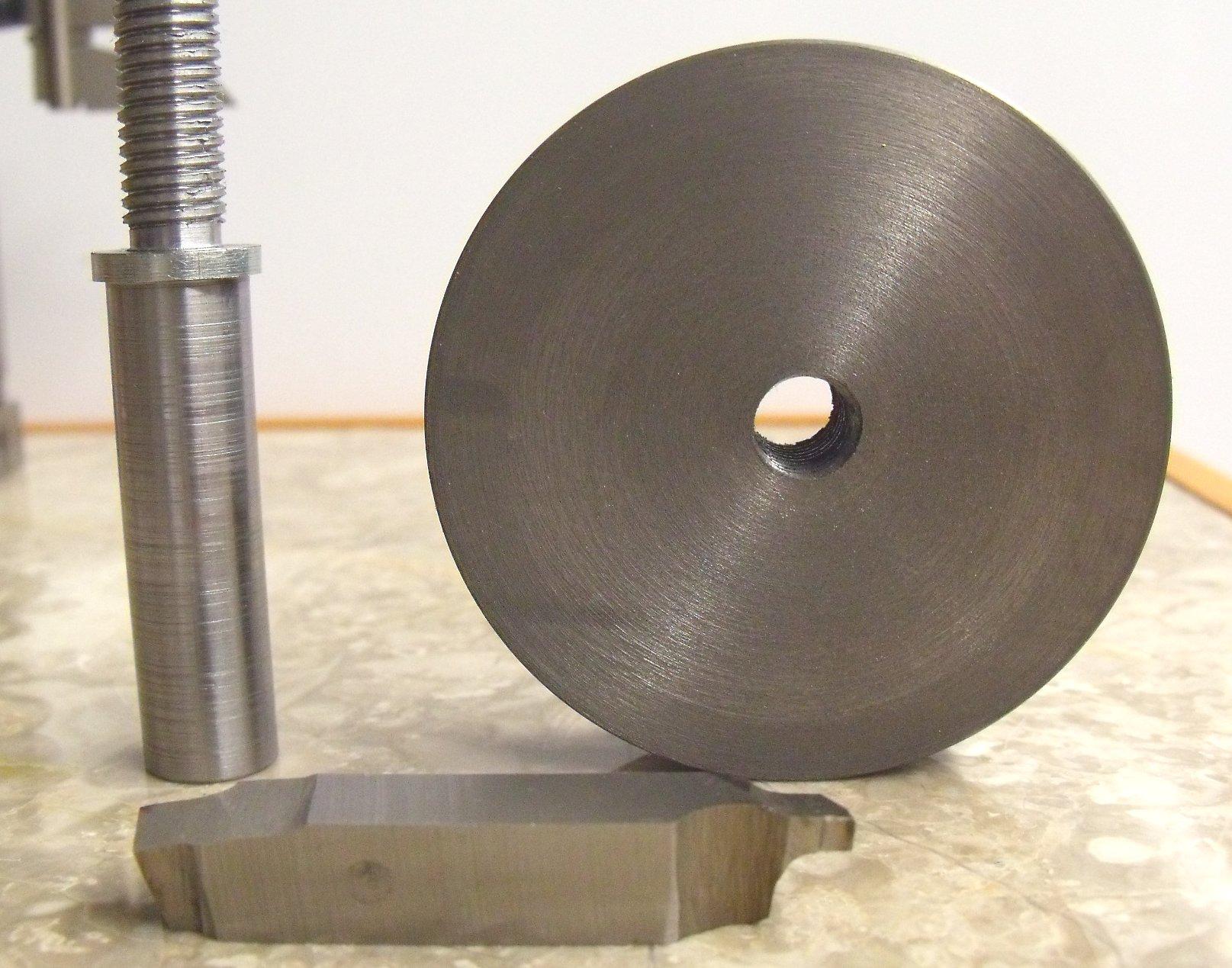

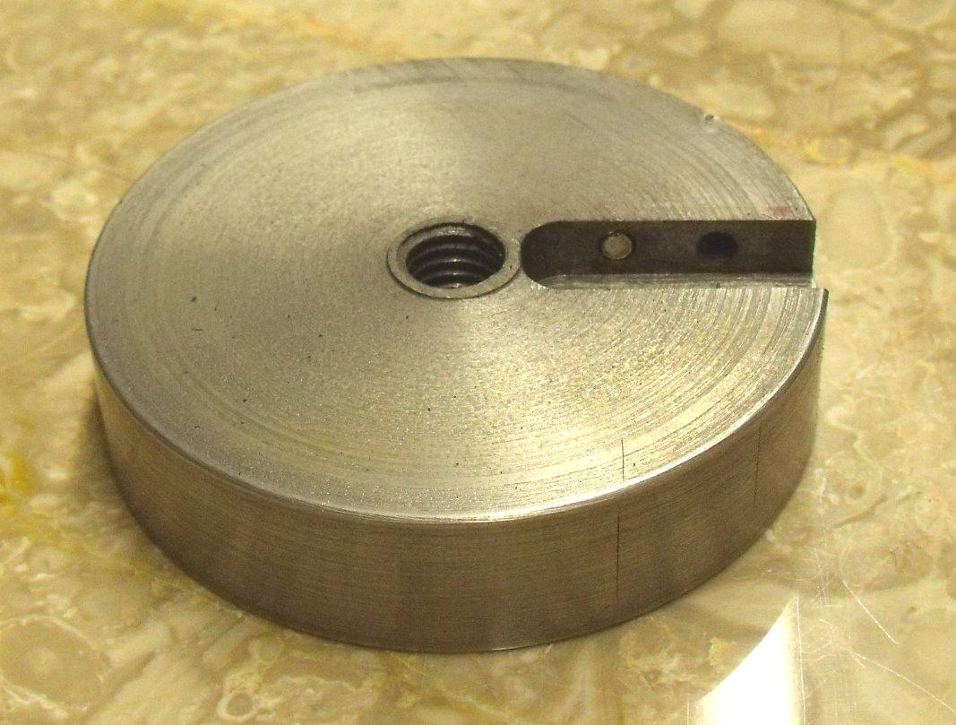

« Reply #7 on: March 02, 2014, 10:46:58 AM »

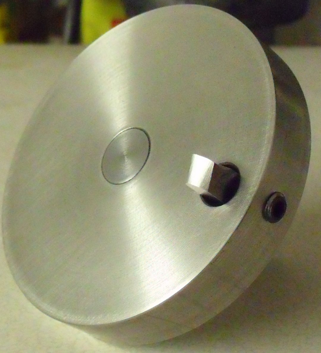

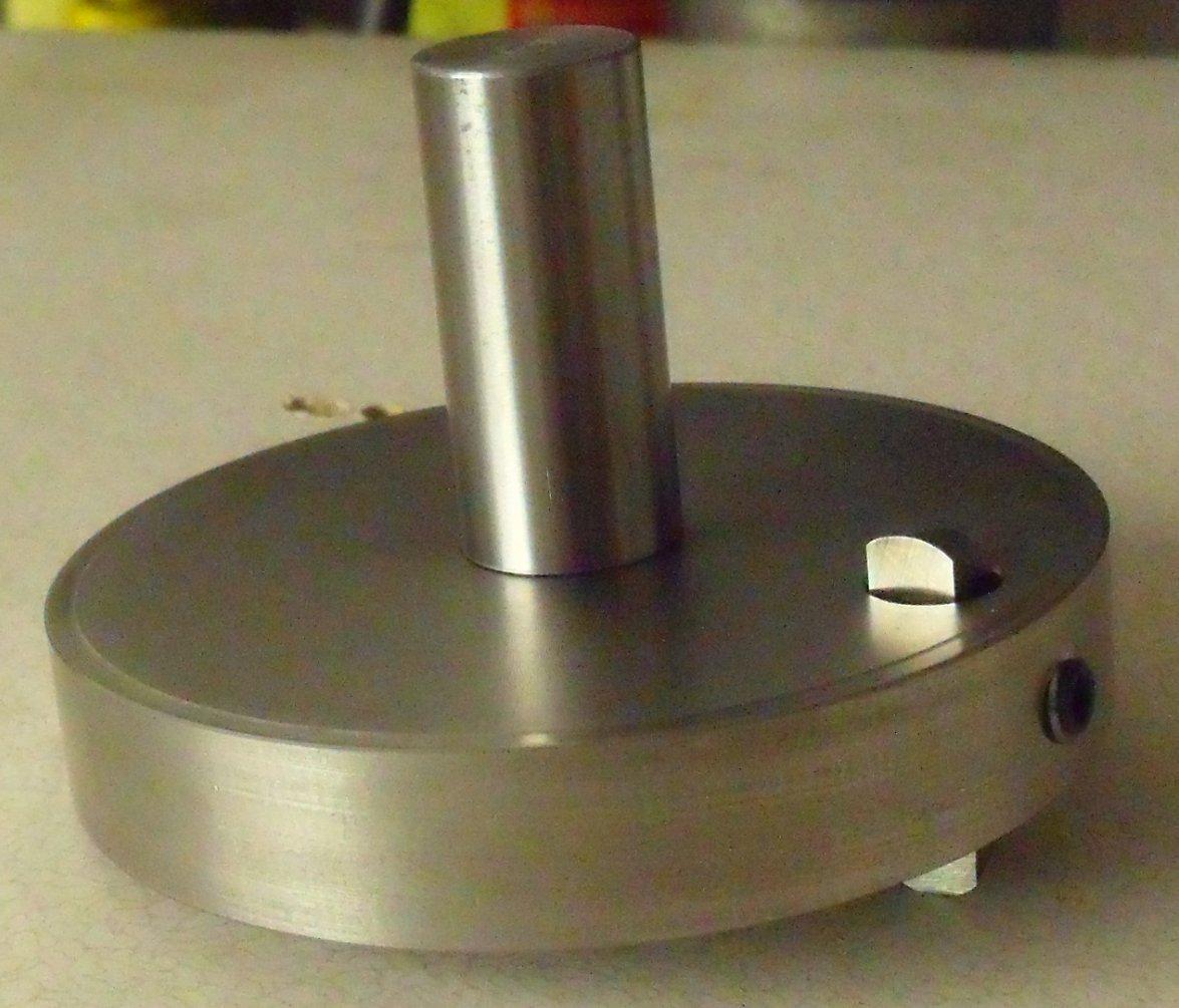

Hi Guys,

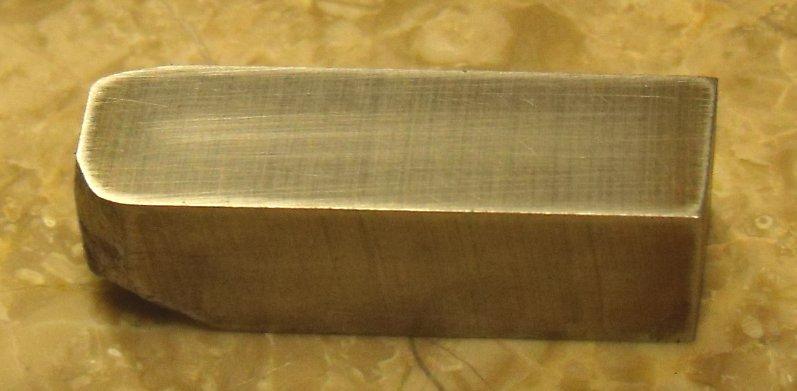

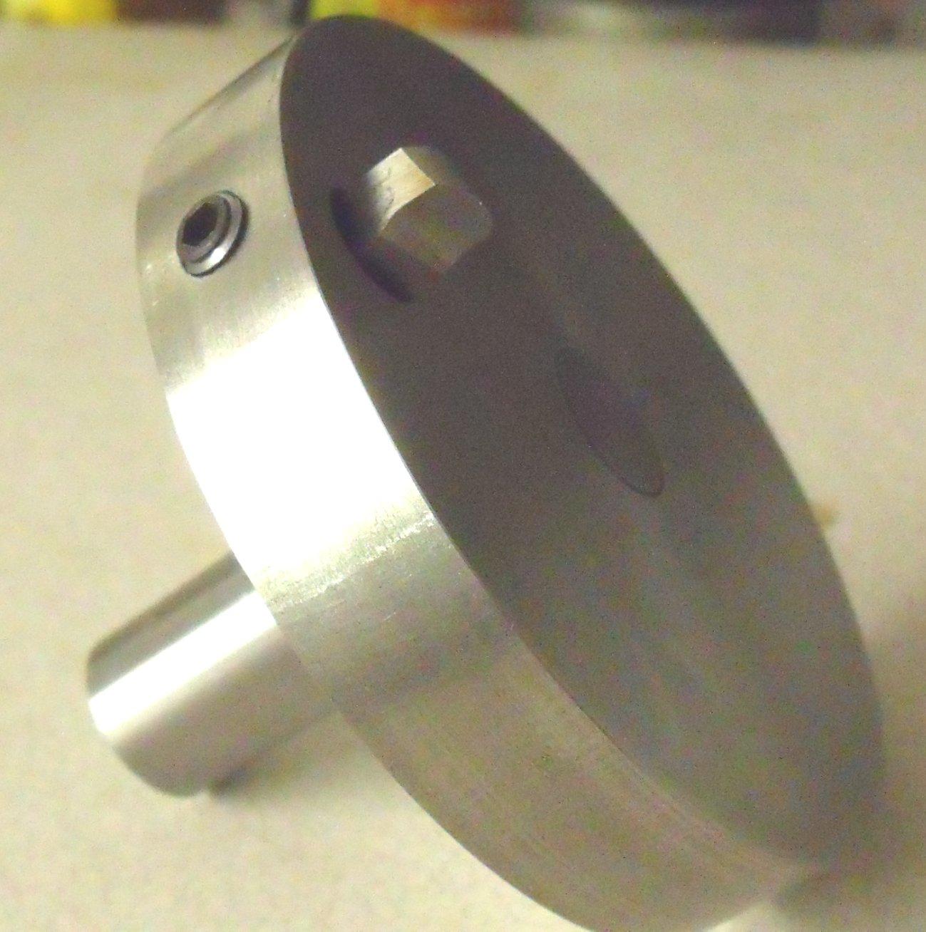

Here are the rest of the photographs as promised of the second fly cutter.  You can see a couple of mistakes that I made along the way, though neither affect how the cutter functions.  They seem quite rigid since the shaft goes completely into the collet or drill chuck.
Best Regards:
                     Baron

« Reply #8 on: March 02, 2014, 11:08:17 AM »
I was thinking of making a head I can attach to my Taig slitting arbor.  Then I just have to make the disc.  I should start a list of what to make, so I quit forgetting what I need when I get in the shop.
Hi Rick,
I would be a little cautious about using an existing arbour.
The first one shown has the 16 mm silver steel shaft turned down to form a shoulder, the spigot of which is a good press fit into a 1/2" inch hole drilled in the disc.  Also the disc of this one is a bar end offcut of 314 stainless steel.  Which is why I avoided trying to thread a large hole in it and used a press fit.  This stuff work hardens if you look at it the wrong way.  Drilling the smaller holes wasn't too bad, but you have to keep the drill cutting.  The hole for the grub screw tapped easily.
If I were going to make another I would definitely go for BMS or cast iron for the disc.  I also would drill a second hole for a toolbit 10 or 15 mm further in.  Then I would drill and tap the grubscrew hole right through both.
This fly cutter was designed to cut a 65 mm diameter surface and it would have been useful to have a second tool position for a smaller diameter.
Best Regards:
                     Baron

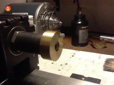

« Reply #22 on: March 09, 2014, 04:16:55 AM »
I got pictures
My fly cutter
Not quite happy with the finish yet.  Working on cutter geometry
The use of the 1/2-40 thread.  To make a jig/fixture to cut 40 tpi in any diameter on my taig lathe that has no threading capabilities as sold
Using Tapatalk

Hi Rick,
I rotated the pictures for you !
It looks fine.  As far as the cutting tip geometry is concerned I just treated it like a lathe tool.
Best Regards:
                     Baron

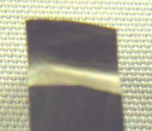

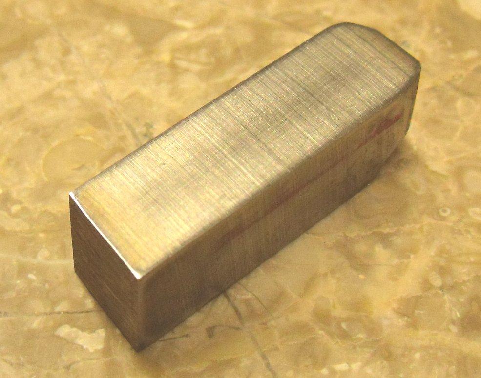

I use carbide insert tools in a similar R8 shank flycutter, but I use the TT221 triangular ones. These seem like they would make beautiful cuts, especially in aluminum. Before I used the inserts, I was grinding tool bits from HSS blanks, and I found to get a nice aluminum finish I had to use a radius and grind it similar to an ice cream serving paddle's profile. Can you tell me the model number of that insert? I think I'd like to buy a holder and one of those inserts to try here.
Do you ever have any problem with the insert rotating on its own? The triangular ones mate up against a flat recess on the back side not cutting.

I grind mine like this when I use HSS.
No idea what the insert reference is, sorry. Not had an insert rotate in use so far.

If you ground a radius into the cutting face of your cutter, parallel to the bit's long axis, and about the same radius size as you have on its cutting corner, you would have what I had mentioned.
I tried to find the round insert and holder you pictured above. I found the inserts. Rather pricey, but considering they offer several times the 3 cutting orientations to which I am accustomed with the triangle shaped inserts, the price seems justified. However, I could not find a holder for them anywhere, and I looked for quite a while using Enco, Amazon, MSC, and eventually just Google. Nada.
Rather strange none of those vendors listed the holder on the same page as their round cutter. Most vendors try to get you to look at "what others purchased along with this product" to get more items in your cart. But I admit most vendor search engines are completely abysmal. Even after finding the technical code name for this style of round insert, sites like Enco could not find anything using that name. Without someone's part number for the actual holder, I would probably have to dig through a paper catalog to find it. Aren't computers supposed to make life easier?? lol

I just used a piece of 3/8 steel bar. I cut a pocket for the insert then just drilled and tapped a hole for the screw, M4 I think. Unless you chip it you should get anything from 10-20 cutting edges from each insert so they do last a long time.
Oh, you made your own? Cool. Sounds like a good idea. Thanks!
Yes I think its neat !  I've got my eye on a couple of likely candidate inserts.  When I get them I'll post photos.  :D
Best Regards:
