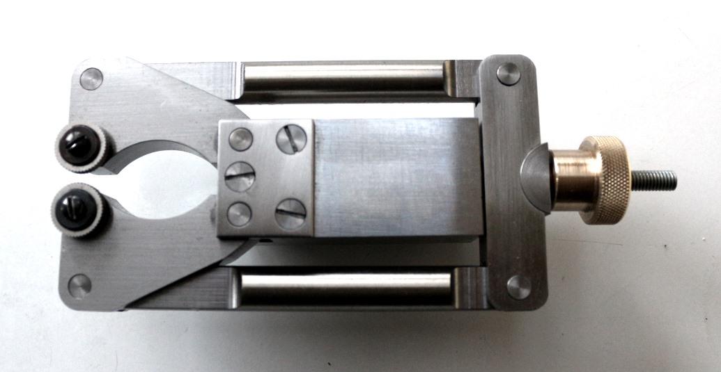

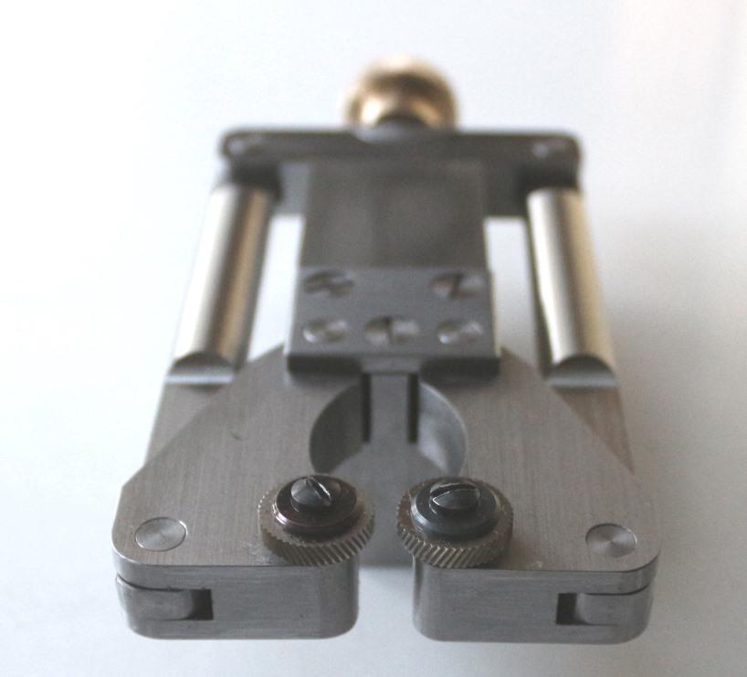

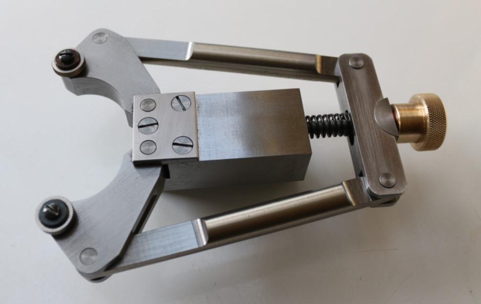

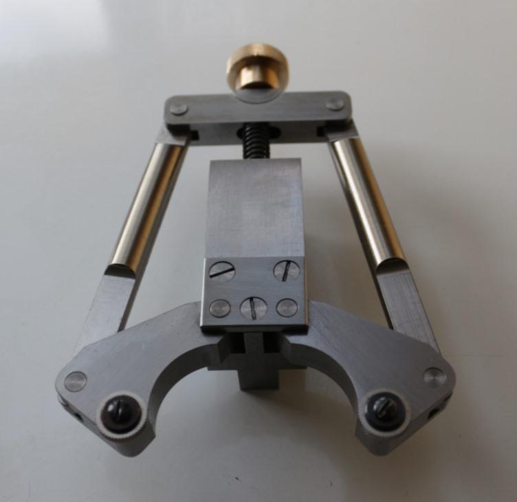

This is my take on a calliper knurling tool. I made it from bits in my scrap box. The adjuster arms I made from a stainless steel cupboard handle for instance. The only things I never made on it are the small patterned knurling wheels which were manufactured by QUICK and the three screws holding down the keep plate (although I did dress and polish the heads on the screws). This version of a knurling tool is based on a design which was originally manufactured by a company called MARLCO and is considered to be the Rolls Royce of knurling tools.
For a small lathe - mine is a WARCO WM250 VF - this is a hefty tool at nearly 7" long and weighing one kilo but it  cuts the mustard big time. I have included a photo of a knurl that the tool formed on a steel bar.
Rik

This is probably one of the easiest constructions ive seen on these clamp knurling tools.. brilliant.! =)

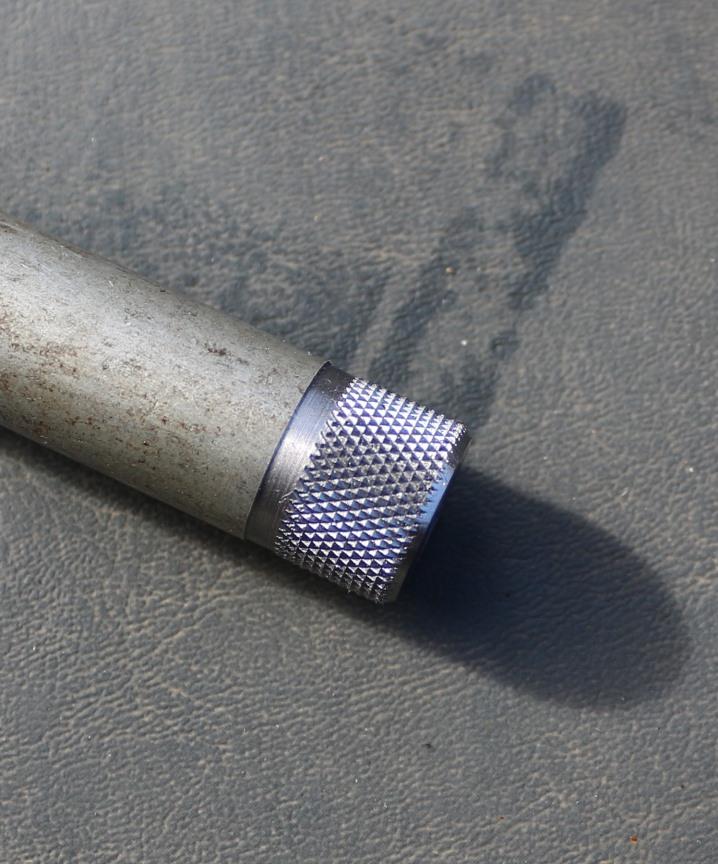

Hi Rik,
Nice work !  Looks good with very clean lines.
Your photos should have something in there to give an idea of size.  Those knurls look tiny.

Rik
I absolutely agree with Neotech that's a sleek design. i just completed one myself otherwise i would build this one myself.
Thanks for showing it.
