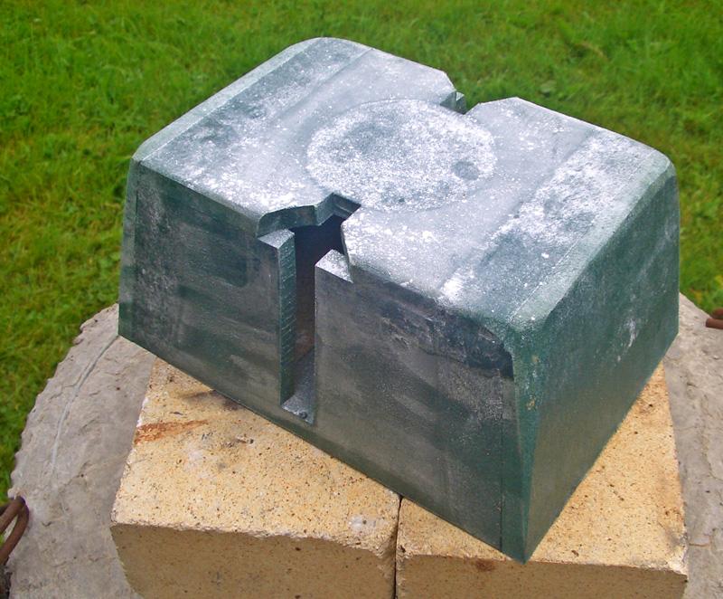

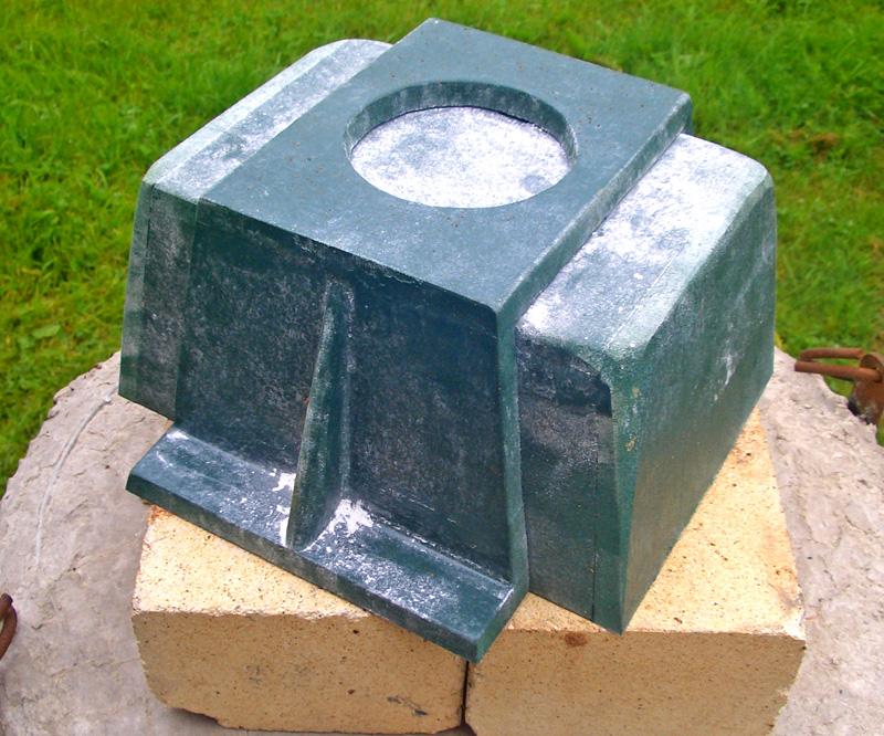

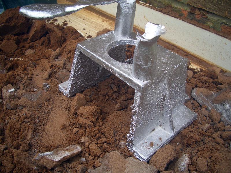

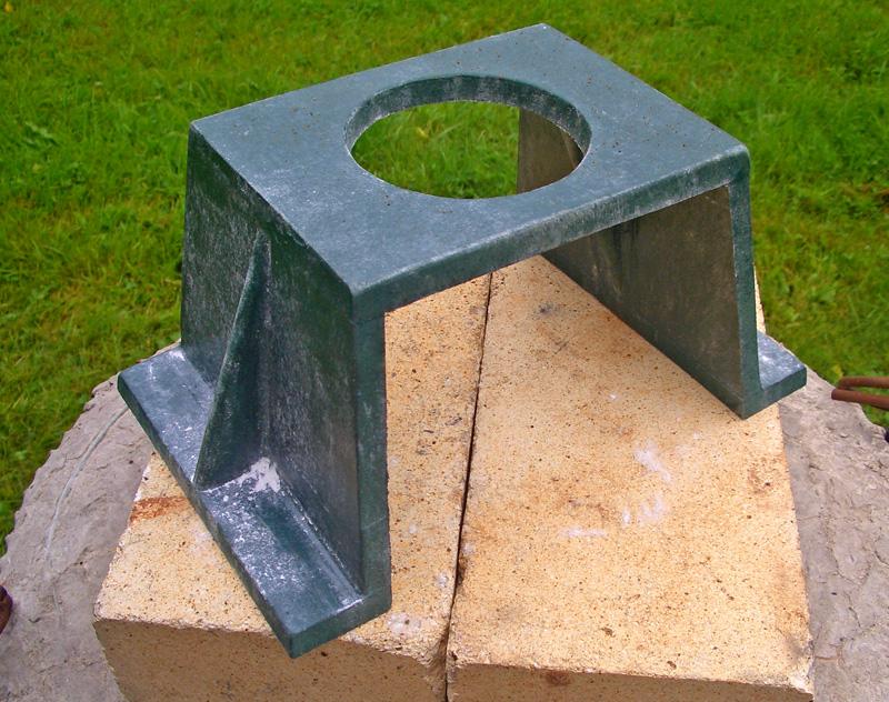

« Reply #80 on: May 28, 2014, 05:31:29 AM »
I've done a bit more today. I had to wait for a period without rain which was rather frustrating.
Today I cast a part for mounting the pulleys for the drive. It is a lot lighter than most of the other parts I have cast for this machine. It is only 10mm thick.
It was a bit more complicated to mould than the previous parts I have made and I was pleased how my way around it worked out.

« Reply #81 on: May 28, 2014, 05:37:09 AM »
I made the pattern in two parts, the main part being the item itself and then the separate part that fits under the main part to fill the awkward cavity underneath. I moulded it with it standing upright on the mould board and when I had rolled it over I removed the filler piece and completed packing the sand in. I rolled it back to open it leaving the cavity filling sand on the base. The sand broke away a little at the base but that is unimportant as it can be trimmed off when I tidy up the casting.

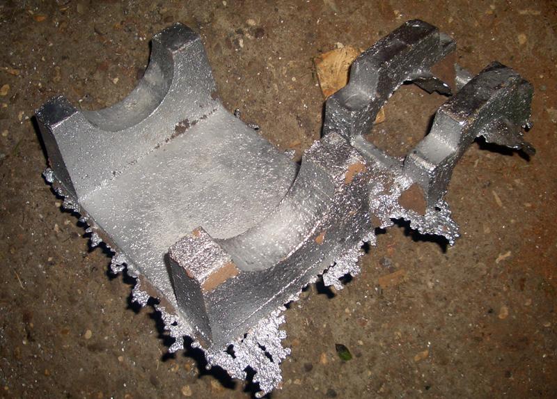

« Reply #83 on: May 28, 2014, 03:45:15 PM »
Buoyed up by my success this morning I thought that I would do some more casting this evening even though the weather was looking a bit dodgy. I tried to be clever and cast three items in one pour. I know(?) that I cut gates between all three patterns but when I poured it seemed as if I hadn't. I got two of the castings OK but with a lot of flashing around the edges.
That will teach me not to try to rush and to beat the weather!

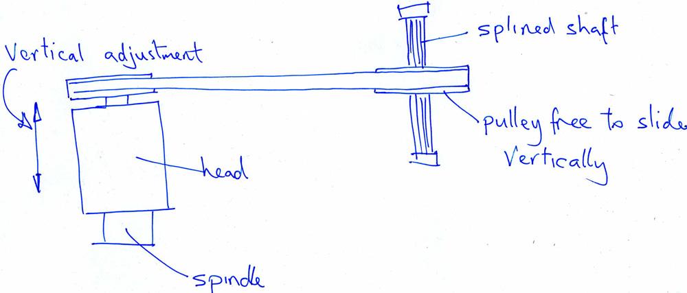

« Reply #85 on: May 29, 2014, 03:05:11 PM »
I need some advice, I hope that someone can help. I intend taking the drive belt to the spindle on this machine above the horizontal tube that carries the head and motor. The head can be adjusted vertically, it does not have a quill as in a pillar drill but moves on a vee slide.
What I was proposing to do is mount a fixed pulley at the top of the spindle and the belt will be driven from an idler pulley mounted on a splined shaft. Do you think that the idler pulley will follow the pulley on the main spindle and automatically align itself?
Here is a sketch showing what I wish to achieve, any comments would be appreciated.

« Reply #86 on: May 29, 2014, 11:34:15 PM »
Hi Norm, looking at your drawing it may work if the pulley sheaves are a fair bit larger in diameter than the belt track diameter,otherwise I think it may try to shed the belt of the edge of the pulleys as they get momentarily misaligned.
Maybe you could rig up a rigid arm from the top of the head and extending to the pulley on the splined power  shaft.
 On the end of the arm nearest the splined pulley you could have a guide fork arrangement with a couple of bronze thrust slippers bearing on the top and bottom bosses of the spline pulley,this should keep the 2 pulleys in better alignment with each other rather than just relying on the belt....OZ.

« Reply #89 on: May 30, 2014, 08:14:25 AM »
Oz, I had considered that idea but I haven't yet worked out a way to mount it on the head. I didn't design it with such a thing in mind and I don't really want to make a complete new one as there is a lot of work in the one I made.

« Reply #91 on: May 30, 2014, 01:01:14 PM »
The "big idea" for doing a different way round is because I have used a milling spindle for the main shaft and I cannot see how to fit a splined shaft to it and the mount for the pulley without having to remake the whole head.
Yes, I should have planned it in advance but I didn't.

« Reply #93 on: May 30, 2014, 03:59:41 PM »
What about a spring fither side of the pulley.
 Lyn.
Offline NormanV
  • Posts: 633
  • United Kingdom
Re: Building a milling machine
« Reply #94 on: May 30, 2014, 05:47:26 PM »
Lucky you Tom, that's half the price I had to pay and I believe that it has gone up since I bought my scrap.
Lyn, that's something I hadn't thought of. I can see the value of a spring underneath the pulley to counteract gravity.

« Reply #95 on: May 31, 2014, 06:42:01 AM »
OK. I get it. I think (not sure, but I should consult my friend) that this construction might have a problem trough a belt tension putting strain on splined shaft. Also this would have a tendency to stick the pulley onto splined shaft. I think that the both problems would trivialize, if you could mount an arm to drilling head and use a bearing on the moving v-belt pulley to retain the pulley and absorb the belt tension. Probably deep grove ball bearings with pretty big clearance should be good for it. Or is there very minimal space for a arm?

« Reply #96 on: May 31, 2014, 12:27:45 PM »
Pekka, the point you make about belt tension "sticking" the pulley onto the splined shaft is something that I hadn't thought about. I think that this could be a real stumbling block with my idea.
It would not be possible to mount an arm between the two shafts as the vee slide is in the way, I will have to use 100mm pulleys to enable the belt to pass either side of this.
I think that I will have to revisit the normal way of doing things. I would have to rely on the torsional strength of a 10mm thread to make it work, I will look into it more closely.
Thank you for your input, I was irritated by what I perceived as sarcasm in your original response but now realise that you were trying to help. Thank you.

« Reply #97 on: May 31, 2014, 03:59:58 PM »
I'm really sorry about irritation I caused, English is not my first language and I have tendency to use wrong wording even when my intention is help.
One more thought....I'm mot sure how much you have space there, but how about using the head design as it is and put poly-v belt on it (easy on draw bolt and such). And offset a jack shaft that is this splined shaft. Would that allow you to move the belt out of way?
