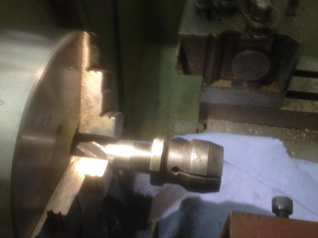

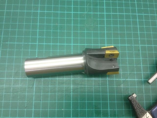

I acquired an inserted tooth end mill, 32 mm shank, 4 inserts on a 40 mm diameter. Great thought I, I have a large Acramil collet chuck, I just need to get a 32 mm collet and backplate
Re: Grinding HSS Threads
« Reply #1 on: February 24, 2014, 11:18:16 AM »
Then the horrible truth dawned on me - it hasn't got threads for the backplate to screw on  :bang: How I overlooked this is a mystery probably attributable to the passing of years and death of grey cells   :scratch:
Never mind - I vaguely remember an article showing threads being ground on an end mill shank on a Clarkson T&C grinder. If I remember correctly whoever was doing it used a slave thread and a shoe as a follower.

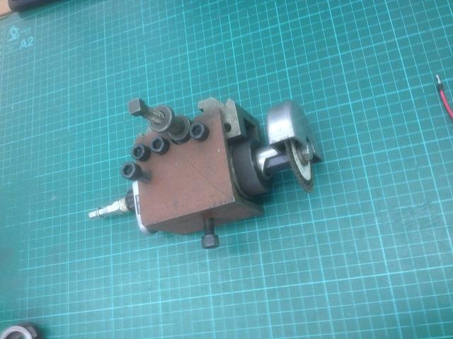

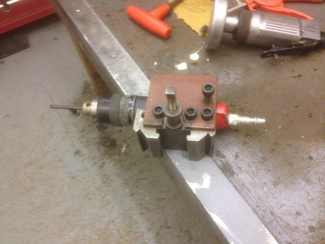

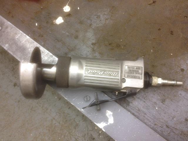

But surly you could do this using conventional threading gearing on a lathe if you could mount a grinding wheel correctly dressed and presented. A thin disk could be form ground to the thread angle and off you go.
Well, I have a hand held 3" 'cutoff saw' intended for car bodywork - perhaps I could mount it up and try an experiment? Then I remembered that years ago I'd made a holder for a DeSoutter air drill to mount in my Dixon tool post - perhaps it could be adapted:
« Reply #2 on: February 24, 2014, 11:19:01 AM »
It wasn't a perfect fit, but for a quick test 'it'll do'

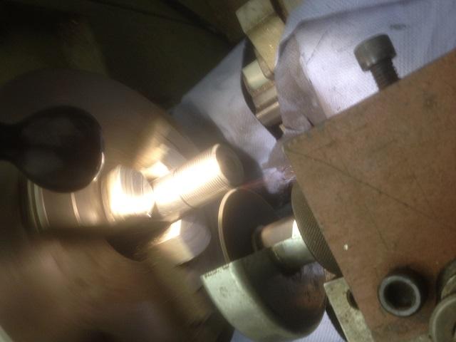

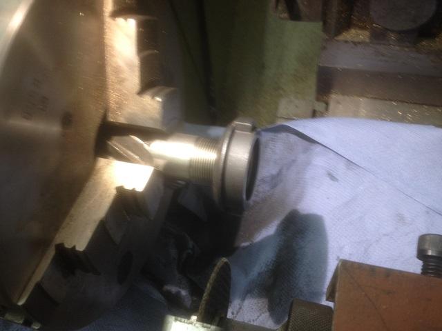

« Reply #3 on: February 24, 2014, 11:23:01 AM »

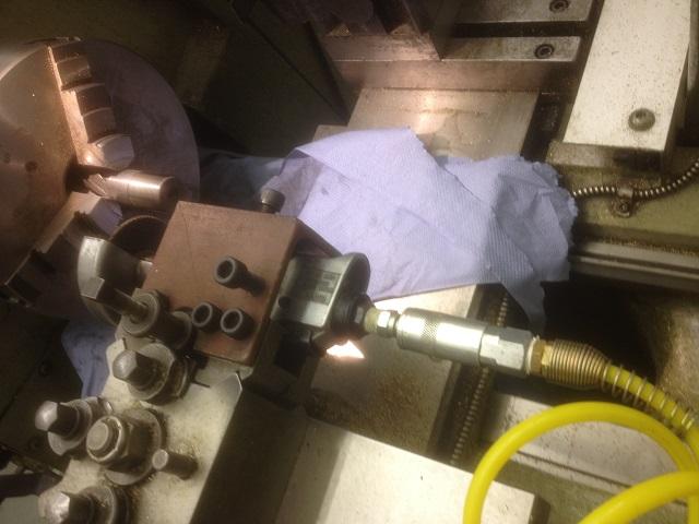

I hand dressed the abrasive disk to the thread angle using a diamond dresser, checking with a thread gauge, set the lathe up for 20 tpi, selected a 1" shank victim from my box of large endmills (I wasn't going to experiment on the real thing  :ddb:)
and set to cautiously taking a thou a time off, having covered the ways with workshop tissue. Lathe was turning at it slowest speed of 30 rpm.
« Reply #4 on: February 24, 2014, 11:27:59 AM »

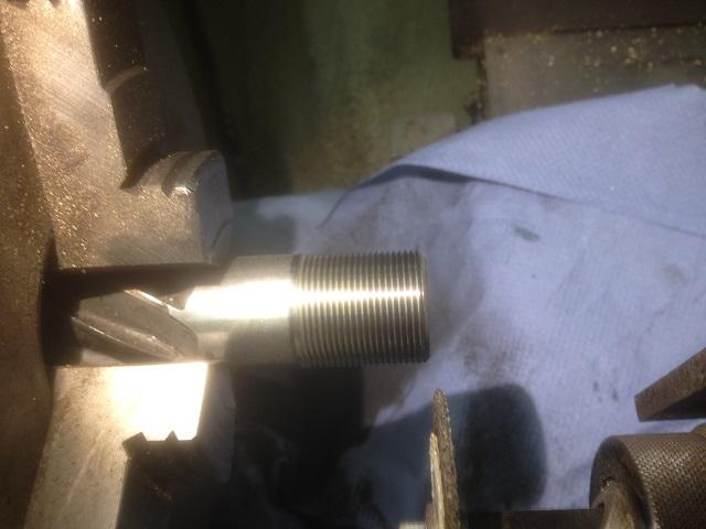

Now this got frightfully boring, as my 1 thou was really half a thou as my DRO is set for diameter. Thread depth for 20 tpi is 32 thou, so 64 thou indicated on my set up. I thought what the heck, and increased the in feed to 1.5 thou per pass. It was obvious that the grinding disk 'point' is going to suffer, and I expected very rounded troughs on the thread. In fact is wasn't as bad as I expected. From a theoretical cut of 64 thou I actually went to 67 thou for a reasonable thread fit to my collet back plate

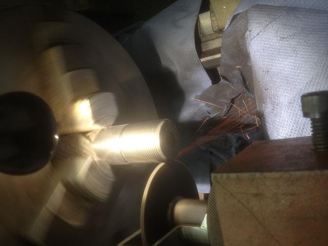

« Reply #5 on: February 24, 2014, 11:30:12 AM »

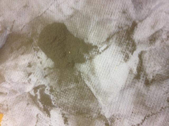

Now when doing this sort of thing in the lathe you have to be very careful to catch all the stuff off the cut or you will slowly grind your lathe into oblivion.
Here is what I caught :
« Reply #6 on: February 24, 2014, 11:36:05 AM »
Now much of that will be high speed steel, but I bet something like 5% is abrasive off the cut off wheel.
Overall a successful experiment that gives me enough confidence to attack the inserted tooth endmill. In an ideal world I'd try and rig a method to dress the wheel during grinding, and also tilt the wheel to the thread helix angle - but as is - it works  :ddb:
I now just need to work out how to mount the inserted tooth cutter for grinding. For the experiment I just used a three jaw chuck as I wasn't much bothered about concentricity (in fact it was out by only a few tenths) but the cutting bit of the mill could fit within the chuck jaws. For the inserted tooth cutter I want it between centres, but the tailstock fouls the grinder, so some other arrangement will have to be cooked up.

Hi Andrew,That's turned really nicely.
I've often considered the possibility of grinding threads in the lathe with a die grinder on the toolpost,and your little experiment here proves it's a very practical method. :clap: :clap:
I also believe that making a couple of metal discs of 60 and 55 degree forms and getting the outside margin diamond coated could be done for reasonable cost.
These would never need dressing and guarantee the correct thread form is maintained at all times.
OZ.
Just turn it down what evers largest you can hold.
Its only the last half that's usually hardened.
« Reply #10 on: February 24, 2014, 04:00:29 PM »
Jonny, that was my first intention, but the shank is HSS for the full length according to my file testing :( I also have considered grinding it down, and may still as I have a cylindrical grinder. But this was an experiment that was triggered by this tool - the interest was to see if it was a feasible approach.

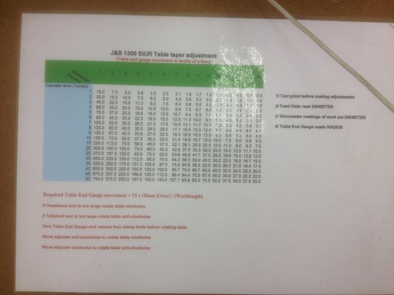

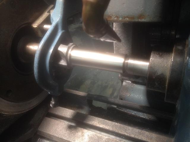

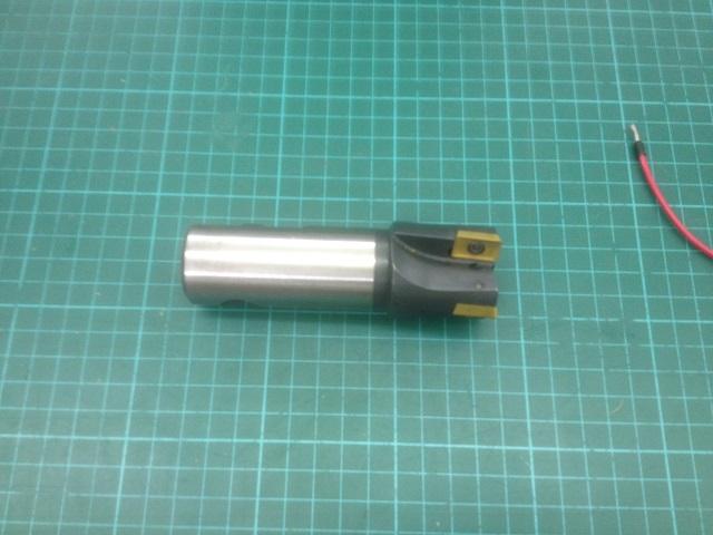

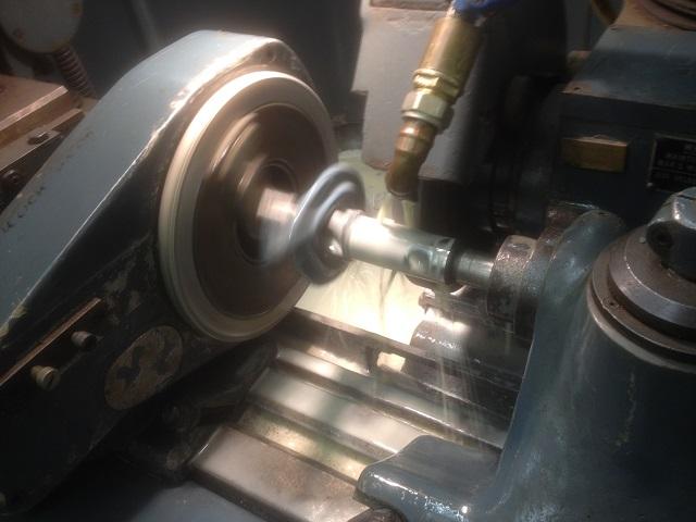

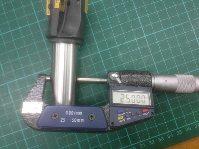

In the end I decided to shove it on the Jones & Shipman 1300 EIUR Cylindrical Grinder and take the shank down to 25 mm. I rarely use this machine, so there's a bit of a learning curve each time I do. Actually using it is easy, but getting work ground parallel is another matter. As it's working to tenths of a thou you only have to breathe on it and things get out of kilter. Work is mounted between stationary centres, and the work rotating mechanism spins round the centre in the headstock.
Mounting work involves moving the tailstock, which returns 'almost' to where it was, requiring table corrections. Years ago I made up and laminated a table of error corrections, which I dug out today and it got me out of trouble :)
It's a question of taking a cut, measuring both ends of the work, applying a correction, then starting again. Easy with this shank as I was reducing 32mm to 25 mm so room for lots of iterations !
« Reply #21 on: February 26, 2014, 10:19:44 AM »
It came out ok - I think I have about half of a tenth of a thou taper in 3" which is far from perfect but much better than the collet it's going in  :lol:

It never ceases to amaze me how this cylindrical grinder can sit unused for sometimes years, then step up to the mark and produce good work. It's a big lump to have taking up space but has got me out of lots of holes in the past.

It's just begging for a special tool post adapter to be made, with inbuilt  spindle belt driven electrically from the 'outer' direction to give good clearance, and able to accurately tilt in a calibrated fashion. Needless to say it would also need dressing facilities on board at calibrated angles. Would make a fairly easy project. Vacuum extraction would be sensible, or at least a suitably mounted catcher and spigot. Bells and whistles would be a microscope to inspect results !

Our thinking patterns must have been on the same plane today,as I was looking at my lathe and coming up with very similar ideas to yours as to how a tool post grinding spindle with a belt connecting to remotely mounted motor could be best situated for thread grinding and the like  :smart:.(great minds think alike) :lol:  :doh:
I was just thinking how best to keep the spindle & bearing housing to a minimum whilst also incorporating a simple tilting mechanism to facilitate helix angle set for coarser pitches.
