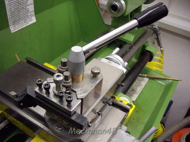

I've recently purchased a Warco WM240 lathe.  Has anybody fitted a quick change tool posts to one of these machines?
Warco do one thats specific to this lathe which includes a knurling tool and drill chuck, I have these tools so don't wish to duplicate them.

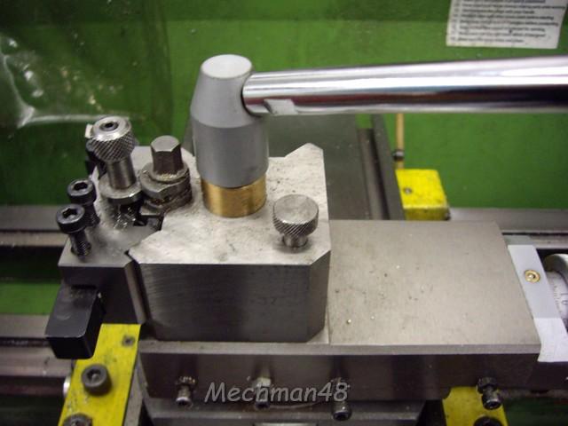

I have fitted one to my WM250V-F; it was one I had fitted to my previous machine, a Clarke C500 combo, Warco also said that they could provide one but would require to be machined out (at extra cost of course). Considering I already had the QCTP plus 10 holders I wasn't going to pay for another set so I set about modifying my machine to suit.
What I did was to machine the boss off the compound slide & scraped the casting flat to ensure the QCTP sat flat on top, I initially made a sleeve to fit the bore of the QCTP as it was made to fit a Myford stud but then decided to machine a new stud to fit the QCTP proper. This gave me the opportunity to see what sort of assembly methods the Chinese 'Technicians' used at the factory.. as found the original tool post stud hadn't even been faced off & had been press fitted into the compound slide, the anti rotation pin had been drilled by hand, at an angle, & a 'bit' of a roll pin 'bashed in'   :hammer:. Having made the new stud I drilled a new anti rotation pin hole vertically on the joint line, tapped it 4mm & fitted a grub screw with a drop of thread locking compound. I finally drilled two other anti rotation / locating holes into the compound slide spotting through from the QCTP tool post. To date it has served me well, should I need to use the original tool post (not so far as I much prefer the QCTP)  all I would need to do is machine up a dummy boss to fit the original tool post.
As the 240 & 250 are not too dissimilar the compound slides are the same so you shouldn't have any difficulty modifying it to suit the QCTP you have /intend to buy. Drop me a pm if you need any further help.

Thanks for that George.  After reading your post I decided it was time to take my slide apart and have a look at it.  I had thought the stud was held bolted from the underside and that's the reason for it having such a large boss. Your description matches mine right down to the hammer marks.
I've jumped from a Cowells ME lathe to this, having only had it for a month or so I'm not that confident in attempting your solution.  There's only 14mm of material to fit a new stud into and wouldn't be confident the result would be firm enough.
From the top of my slide to center height is 25mm and the hole in the existing tool post is 10mm, would you know if if a QCTP is soft enough to bore out to fit the stud?  thats assuming there's enough meat on it in the first place.

No doubt you will have resolved your QCTP queries by now but never the less; I general find that most of QCTP are heat treated & therefore 'hardened' so drilling these is a no go, some are case hardened so it may be possible to drill through the case hardening with a TC drill & get through to the ordinary steel core of the block other readers may have better solutions  :scratch: ? hence why I made a new tool post stud/bolt. hope this is of help (belatedly).

They are just hardened done 23 holders to at least 1 1/8" high just need decent cutters.
Toolpost same material and will have an over large hole already in with a  sleeve.
I wouldn't risk hss bits to bore it out.
14mm is more than adequate to use the supplied stud. 3/8" depth ok that would take tonnes of pressure.
250 series is a shade over 15mm thick T slot for the M16 stud to screw in to if that helps.
