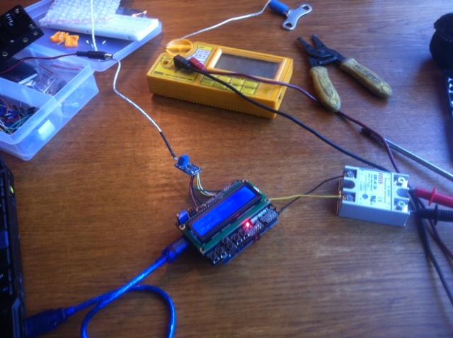

Soldered it all together.

A project is not a project without pictures, so here is one on the kitchen table while testing.

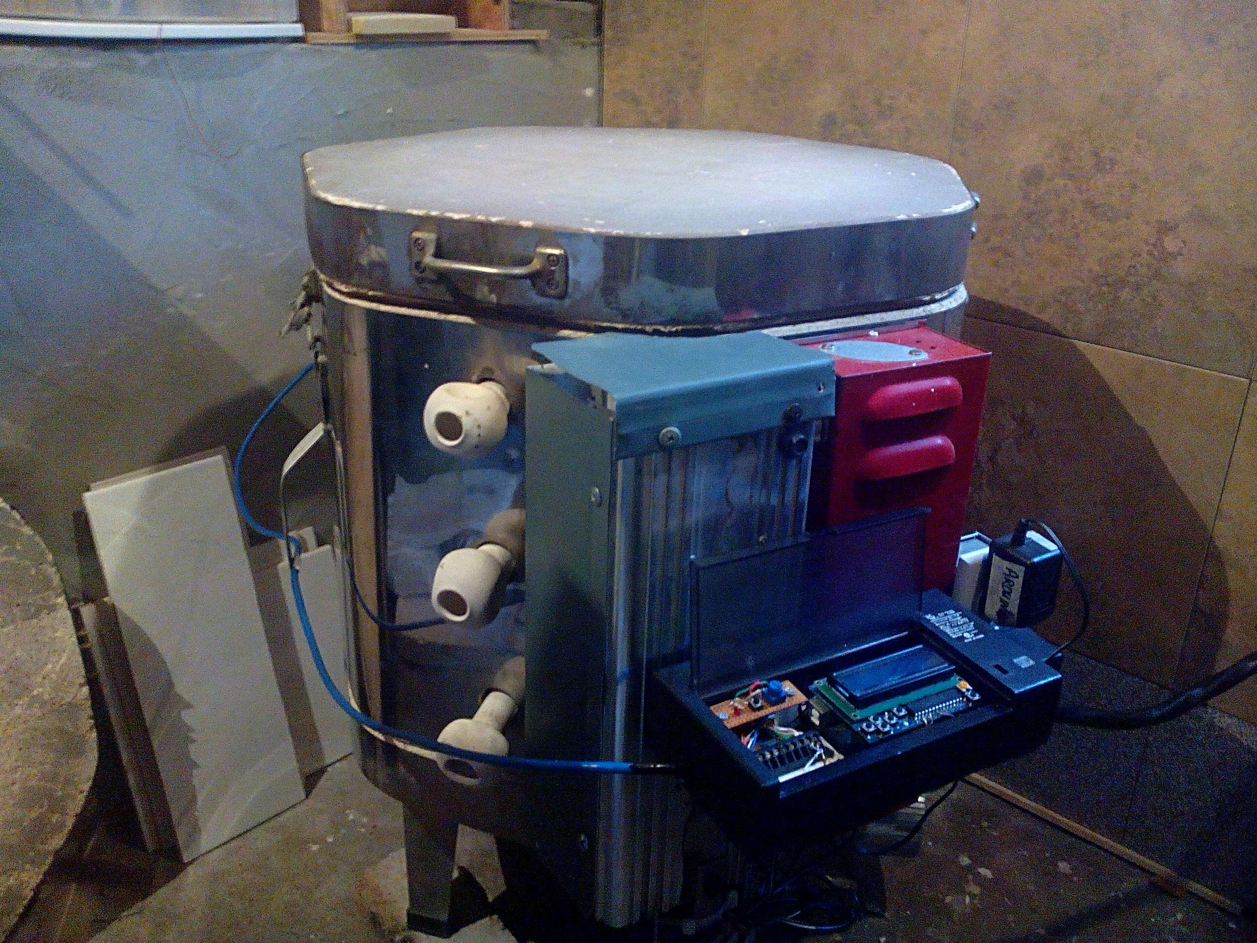

Hooked the thing up yesterday and it works great. I used the switching circuit of the oven to control it, just like the factory controller would.
The k-type thermocouple did produce a few stray readings, but with some minor code adjustments these are now no longer an impact.
Did a simple program yesterday getting the oven up to 955c (1751f) and letting it cool down after, this was to bake some ceramics to the biscuit stage.
Have a few updates to make to the code to clean up some screen artifacts, change the time display to hh:mm format and some other minor interface issues, but overall a very successful project. I'm going to make an enclosure for the arduino and screen without the relays and thermocouple parts and make those external with easy connectors so I can use the arduino for other projects and keep the enclosure as small as possible.
