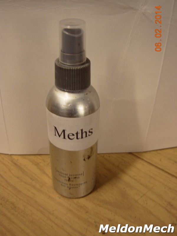

            There are times in the workshop,especially when I am on a roll, that the things I immediately want are never at hand. There are many things that fall into that category, but on this particular day it was one of the solvents that I frequently use, meths. I had spilled a small amount of french polish on my vernier caliper, and it was nearly dry. I hunted all over the workshop to no avail, then suddenly remembered I had last used it in the garage. Oh no! it was during one of the worst storms we have had, I snatched my keys off the kitchen hook and rushed out into the storm. I have a Yale lock on my garage and quickly inserted the  key it began to turn then began to bend O.M.G. I carefully managed to extract it, and rushed back into the workshop. By this time I was soaked, and fuming, and swore from then on to ensure I had a dedicated supply of all solvents and lubricants at hand, that I normally use in the workshop.

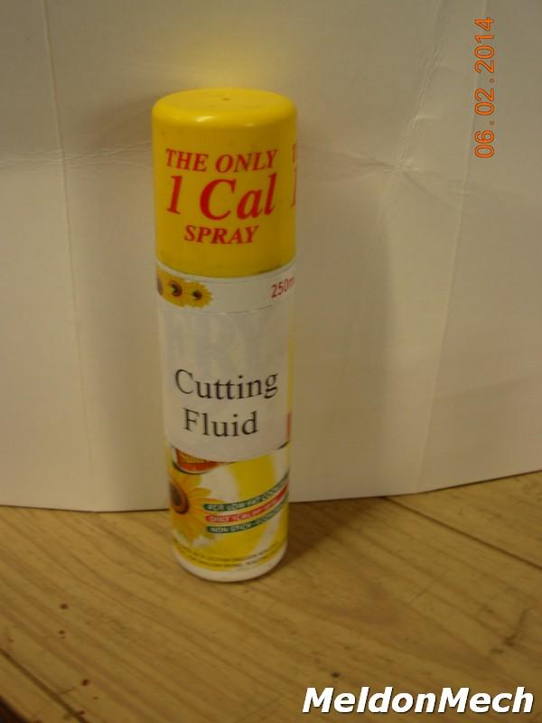

  I use soluble cutting oil on some machining applications, but don't like to flood my machines with it, and find a gentle spray when required doe the trick.

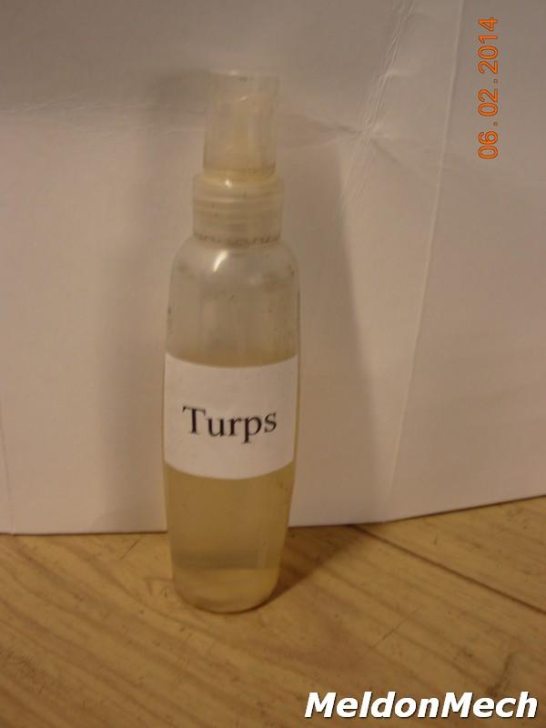

The next solvent I use is Turps, mainly for general machine and tool cleaning, thinning pain , removing paint splashes. I also use it as a cutting fluid when machining aluminium.

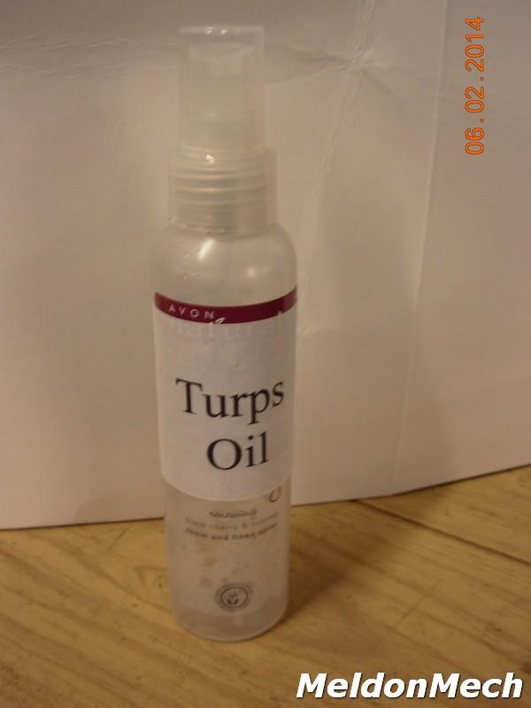

Turps and engine oil I use for surface protection, and fine lubrication, a spray of turps /oil can access awkward places.

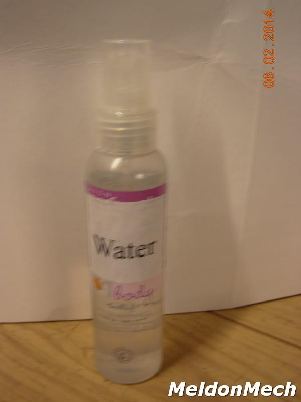

Water most often used for cooling tools when grinding.

       Meths  as a solvent, and general cleaning

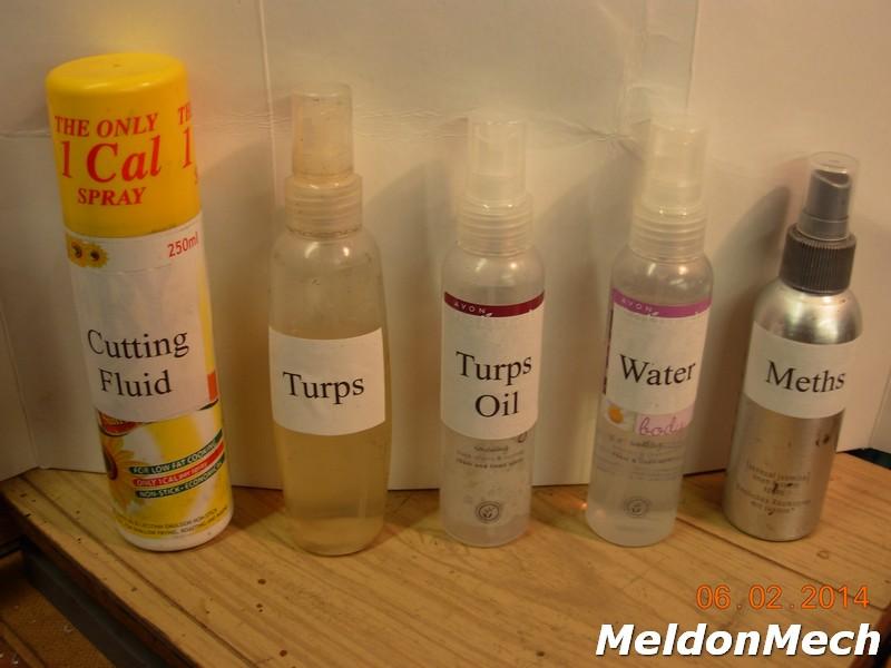

 Well there there we have it, the famous five.

I bought several of those hand trigger sprays from the local garden centre. I keep meths, acetone, white spirit, carburetter cleaner, water with soap (air leaks), and Plus Gas, with another with soluble oil by the manual lathe. One shelf of my storage area is supposed to be dedicated to them, and along with various  oils, but it's now overflowed to a second  :bugeye:
