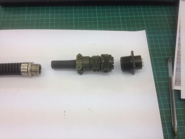

I have an Amphenol circular military style 10 pin plug, the back end of which is 1" x 20 tpi, and want to connect it to 20 mm UK flexible armoured conduit.
Is 1" x 20 tpi a standard American conduit thread by any chance ? If I have to turn up a converter I will but would rather avoid it if possible

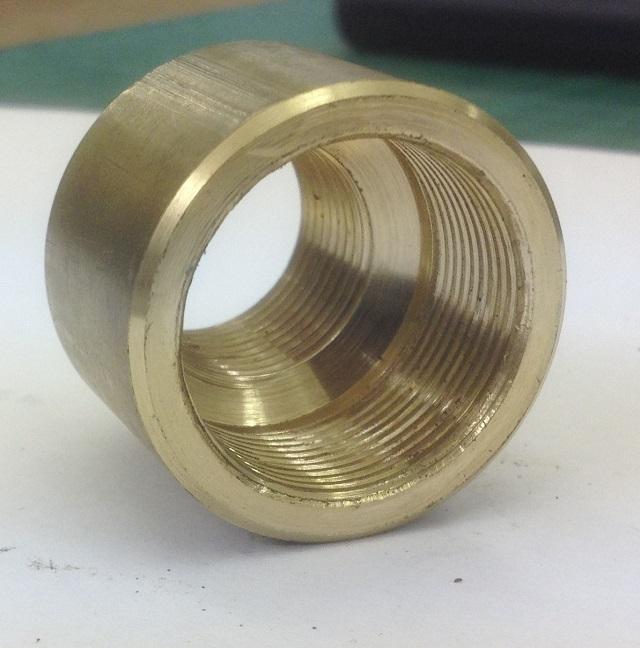

I gave up searching and internally single point threaded a bit of brass this afternoon 1" 20 tpi at one end and 20mm conduit thread at the other.
I hate internal single point threading in blind holes, but it went well. It's all too easy to lose your threading tool on the 'back wall'  :bugeye:

This is what the original question was all about:
A/ Amphenol don't make a converter to fix flexible conduit to the rear of these connectors

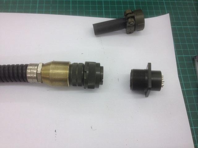

Re: 1" x 20 tpi conduit thread ????
« Reply #9 on: January 29, 2014, 11:32:42 AM »
B/ Andrew Mawson does  :ddb:
« Reply #10 on: January 29, 2014, 11:34:13 AM »
C: Resulting in Adaptaflex conduit fixed securely to Amphenol connector  :lol:
