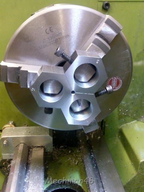

Here's a set I made from your idea, thanks, as you can see made mine from hex bar, gives me the resource to use all 6 corners.. within limits of course.
George.

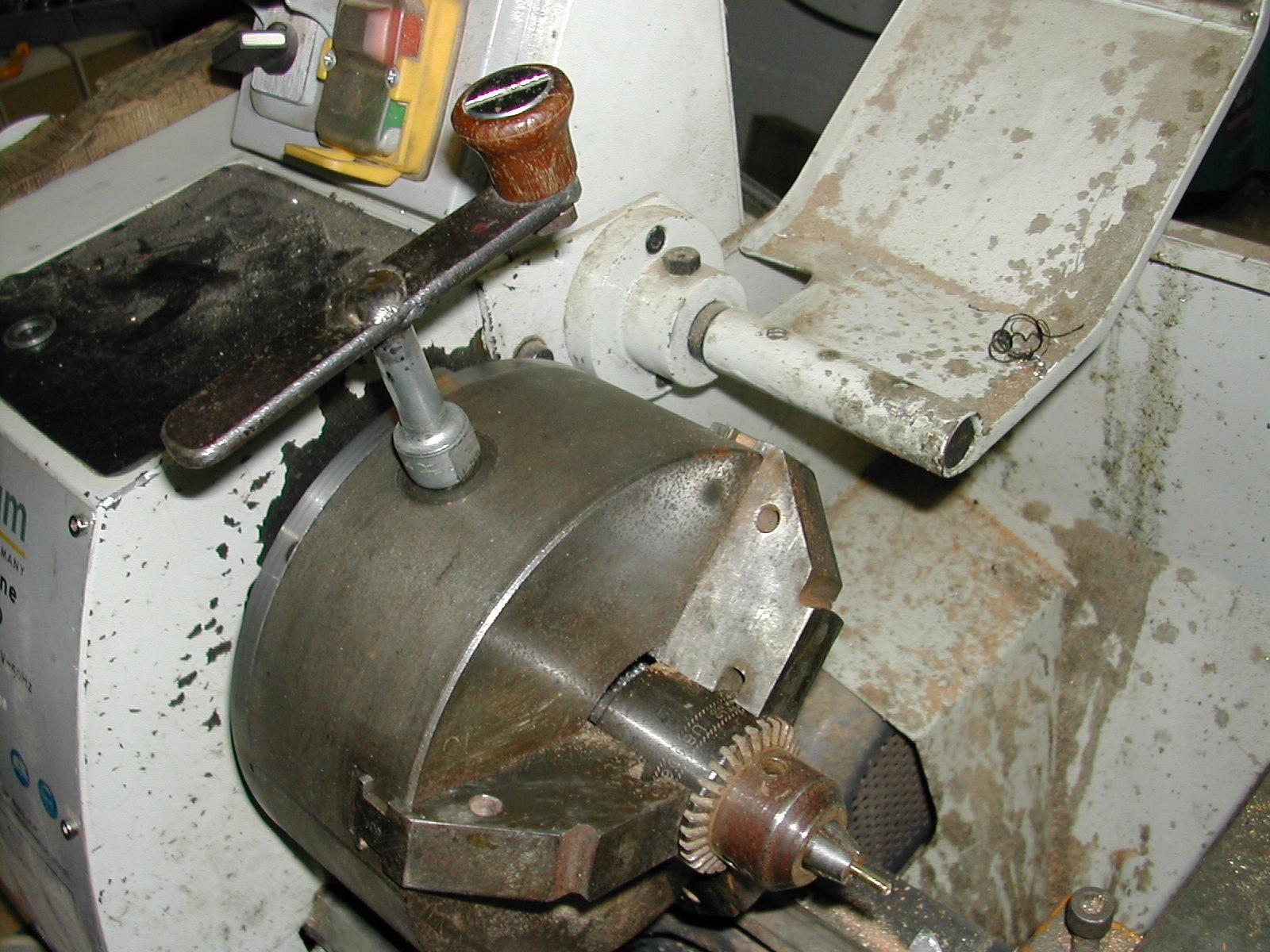

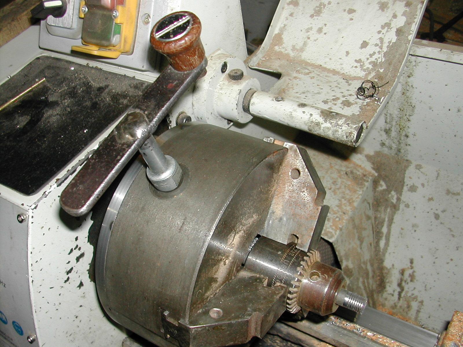

Interesting chuck adaptation and excellent photos. Has given me food for thought for special chuck applications – thank you. Avoids spending money on commercial chuck products.
I never throw away good chucks from broken electric drills. They can serve a similar purpose of holding small items without obstruction. Unlike your masterpiece Anthony, ordinary chucks have a very limited capacity for holding screw heads inside the chuck.
Just remember that if held by the outer (knurled) sleeve, it could be less accurately concentric, and a high cutting force could possibly unwind the jaws of the smaller chuck.
I tried moderate cuts on a 3/8th mild steel work-piece with no problem with the chuck unwinding (Fig. 1). Smaller stock certainly no problem (Fig. 2)
 So, if it has a shaft of some sort attached to the main body, use that. If the shaft has a morse taper that you have no use for, machine it parallel.
El-BRILLIANTE  !!!
Nudder  one  we  have  to make
The last in round  turned  out  poorly
This in HEX  is  ingenious, to say the least
