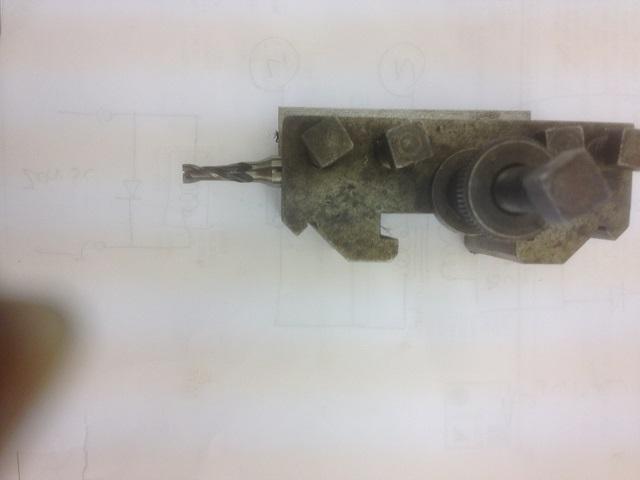

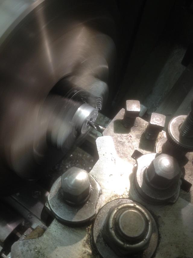

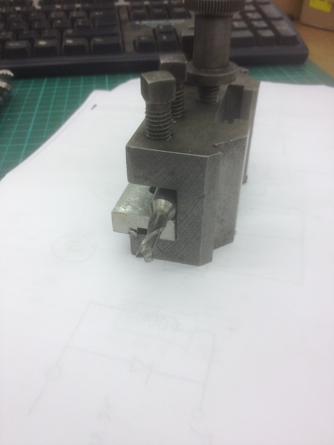

I wanted to bore rather than drill some 9.5 mm holes in aluminium alloy to keep them concentric prior to reaming to final size. However none of my boring bars were small enough.
Rather than grind a tool specifically I remembered a tip I picked up somewhere to use a single flute of a slot drill or end mill. Mounted the tool with the lip in question on centre height, but with the tool axis slightly pointing forward to create relief behind the rest of the sides and away we went. Worked very well so I post it here in case it helps someone else
Andrew
