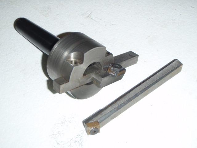

I have good chunk of iron on MT3 and I put there baddest russian carbide bit I had (Somewhat bigger and thicker than CCMT09 with really BIG r) and never had a trouble.
The slender holder has been machined out of round rod (was easier to get angles right to something....that was long ago I forgot for what :lol:).
The attached holder is a funny one....I needed to cut on recess, therefore I need small diameter flycutter. I got my boring bar later. Maybe this explains something.

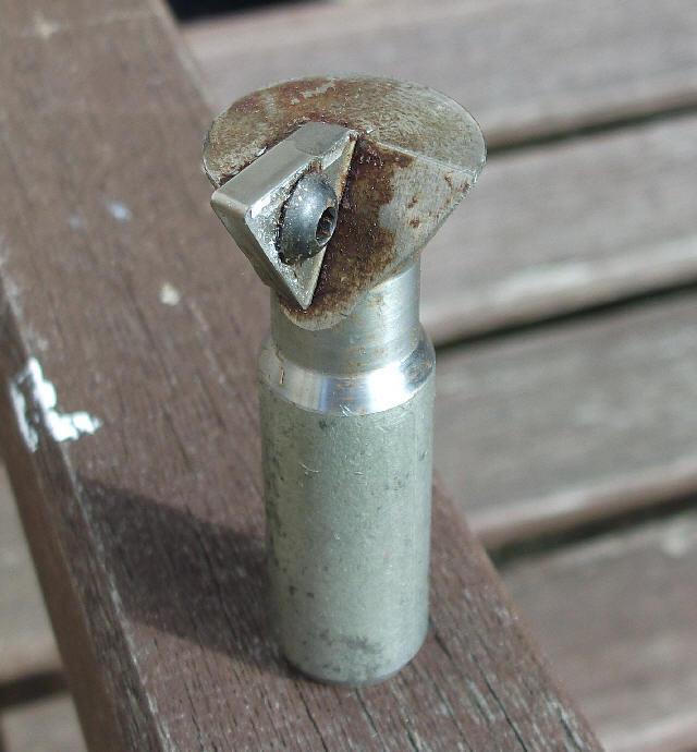

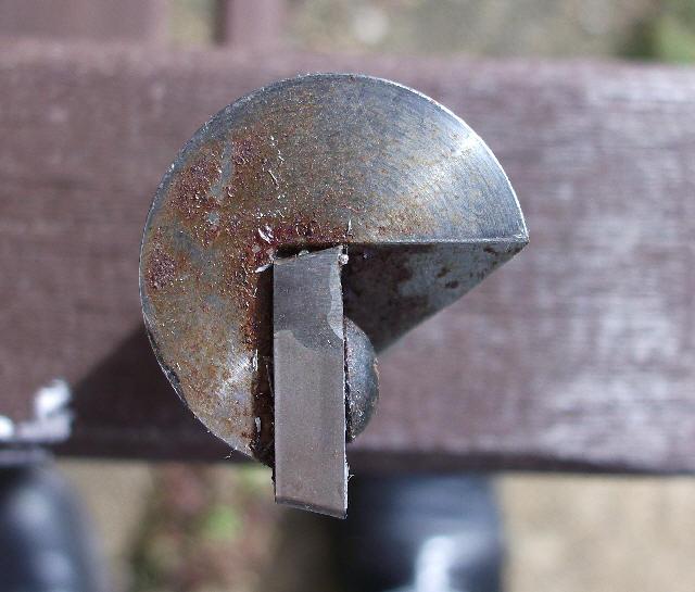

« Reply #11 on: October 13, 2012, 07:18:34 AM »
Knocked this up a few year ago: (see pic)
Worked quite well with light cuts

« Reply #12 on: October 13, 2012, 07:48:43 PM »
Problem there Todd  its got a load of radius on the tip.
Many European sorry German dovetails are not that deep some are only 1.8mm. Very few go deeper than 2.4mm.
So by using a rad on cutter there has to be clearance on the opposite fitment ie mounts. Even then if there is clearance allowed at best it will reduce grab and holding zero.
There is no industry standard for cutting dovetails amongst producers, in fact take a certain Fen and theres three different sizes on same product.
Picatinny/Weaver has an undercut 45 with recess, top 45 degree angle and slots. Inundated making them and not worth while.
Not a good system any way limited on mount position every 10mm if cant slide scope through the rings.
